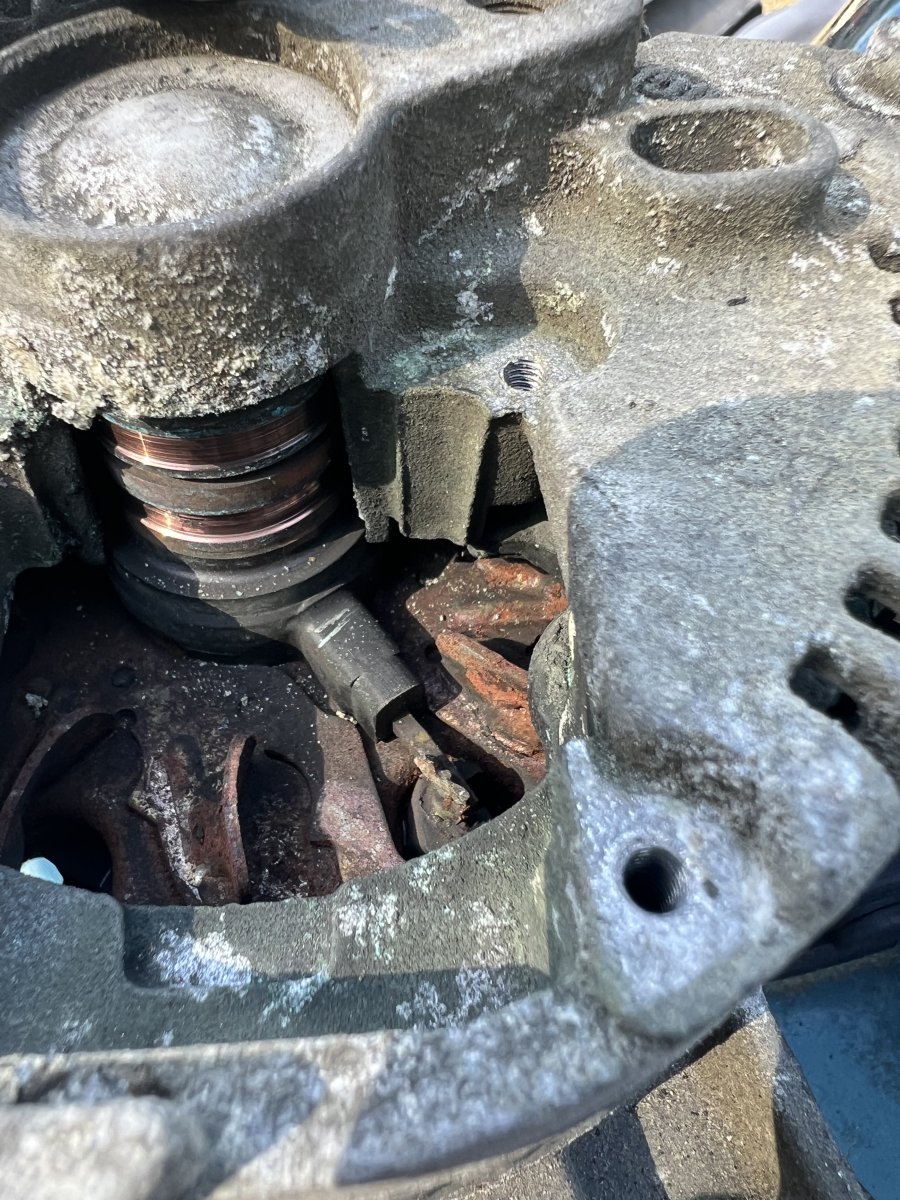

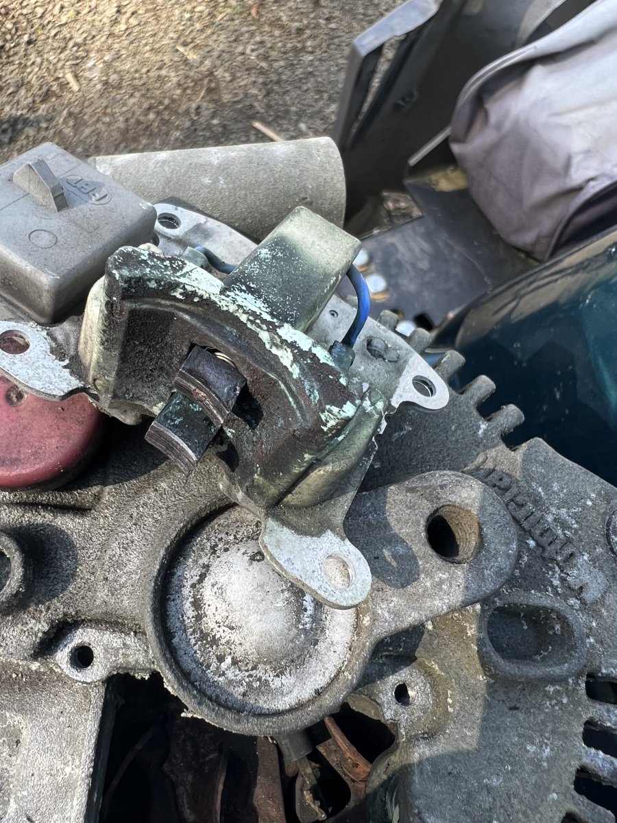

Ran without alternator for a minute, no surging of motor or lights. Ordered an upgraded 130 as mine is the 95. You can replace the regulator it looks like, my brushes were uneven, one may have been stuck. Grooves in armature are 1/16in. Tempted to rebuild for fun but found a close out acdelco for 70 bucks.
Motorcraft old one so assuming it’s original part. Time for a new one anyway lol.

Yup, that alternator isn’t in good shape
