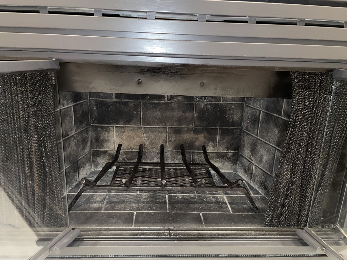

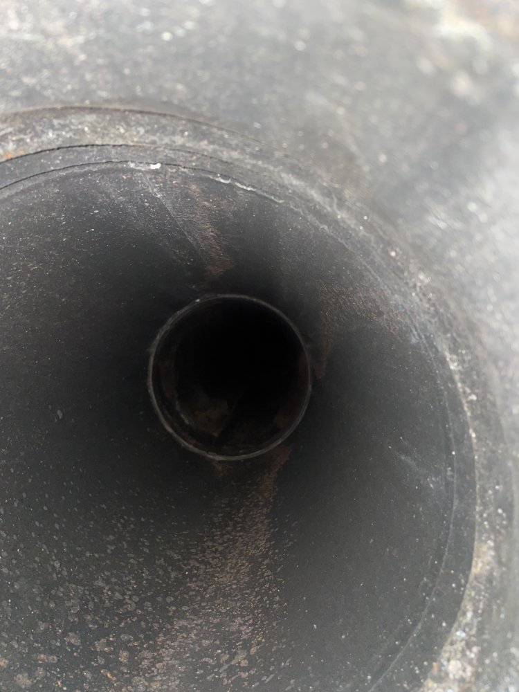

Here's my fireplace. looks like it already has a chimney liner. The edge brick chimney on the roof lines right up with the wall that the fireplace is on, so I'm guessing that it is brick all the way to the ground. It's not all that big, but I bet I could get a decent insert to put in there.
This ^ is taken through the slats above the opening. Looks like just a funnel into the liner.
Just FWIW, that log grate in that fireplace is more ornamental than practical. They suck for burning on, you need something with closely spaced bars like most of the cast ones. The cheap Chinese cast ones don’t last more than a year or two before they kinda melt. We managed to get a USA made cast one and it still looks like the day we bought it like 10 years ago

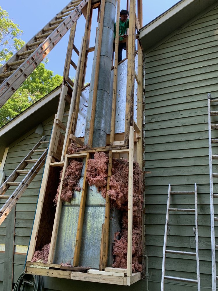

This is a "pre-fab" chimney. Every piece can be replaced and can be dissassembled. Those bricks are faux panels, not real.

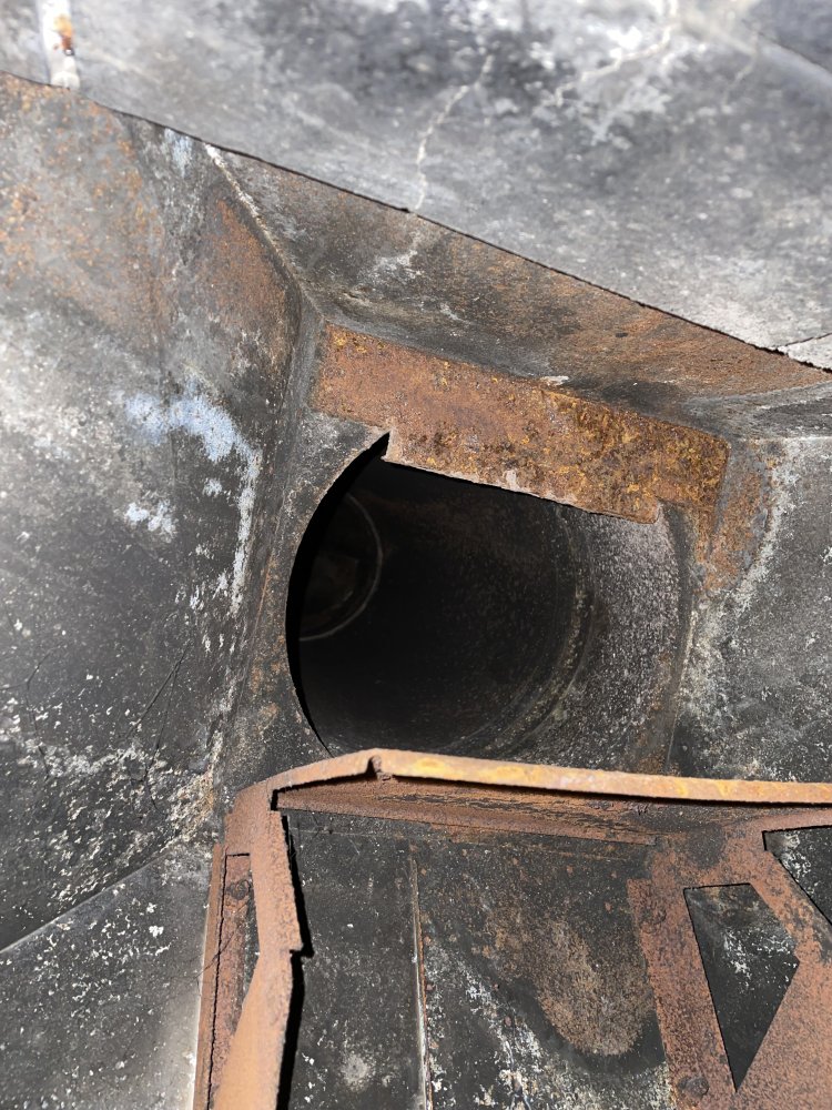

This rusty damper would be a concern for me. Rust means water is gettting all the way down there and sitting. Check for a proper Chimney cap. NOT just bird screen.
It looks like it hasn't moved in decades. NOT a good sign. Get the rust of with a wire brush and lubricate the moving parts.
Your log grate is fine, it has the expanded metal bottom to keep the large pieces off the ground.
I would NOT go into the white brick. It's decoration mostly and heat retention minorly, not at all structually supportive. Go ionto a stud in the drywall with wood screws, not tapcons. That metal liner is just boxed in like a closet. There should be studs every 16" on center, like the rest of the house. Unless thats drywall over brick. BUT the white bricks are decor

Here's an interesting pic I found. Turns out there is such a thing as a "modern" chimney. I'd bet there's all kinds of codes that prevent the chimney pipe from just running in the wall... cear space requirements and such. I'd bet allot of builders wouldn't build a whole chimney structure just for aesthetics.

Yes, in the box, behind those brick panels should be sheet metal. Make sure you get an insert for a "pre fab" or specify that you already have a Liner.
I assume THIS is what you have, as well. When finished, this will be bricked and look like a traditional fire place/chimny, OR it could be finished like the house, with wooden slats, or Vinyl siding.

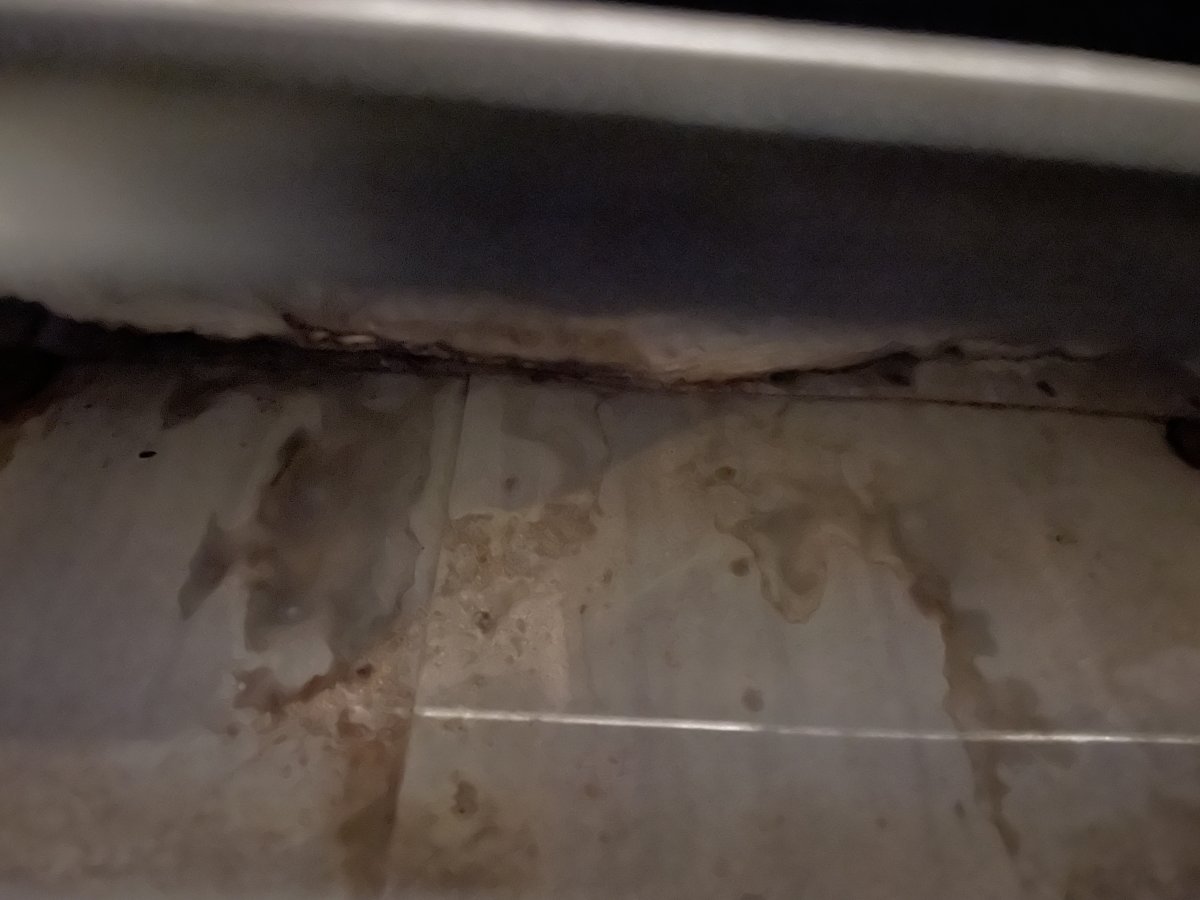

Just got it inspected. It's capped on top and there's a crack in the firebrick. Got a quote for $5,000 to put a plate behind and seal that crack along with a chimney cap and plumbing in some pipe. He also said that most likely the brick chimney most likely stops at the roof and doesn't go all the way down to the slab.
They declined to quote anything related to inserts. He said the prefab fireplace would have to come out, and a masonry box built to contain the insert. Going to see what some other folks say.
