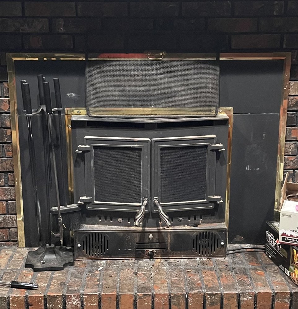

I have no idea how it’s installed, but it’s had two decades of fires in it so I guess they did it right. The fan does work and it heats very well, but the box has to get scalding hot for it to put out significantly hot air. It doesn’t use outside air for combustion, but it has adjustable lovers at the bottom. We have them adjusted all the way closed so one load of wood lasts all night. We can pack it full and there’ll only be a couple smoldering sticks in the morning.
Here’s a pic. Anyone have any idea what it is?
And that is why you don't get much heat out of it.
Wide open is hot/fire and short lasting
Fully closed is smoldering/embers and long lasting
You have to find a happy medium and add wood sometime during the night if you want good heat.
It just seems like smoldering should do better than it does. The box is too hot to touch but the air blowing out is mildly warm. I guess I could do a temp test of the box with fan on and off. I imagine it’s a cheap one so not much engineering for efficiency. A bunch of heat sink panels in the casting is what I’d like to see.

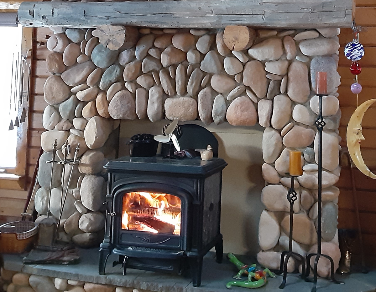

This is what we have now for a secondary heat source.
It was an insert (Heatilator brand) with a blower. But as has been said, most of the heat went up the chimney. While the newer set up is more efficient and heats the room, the rest of the house gets cold because the thermostat is in the same room as the stove.
