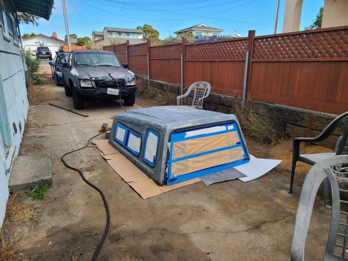

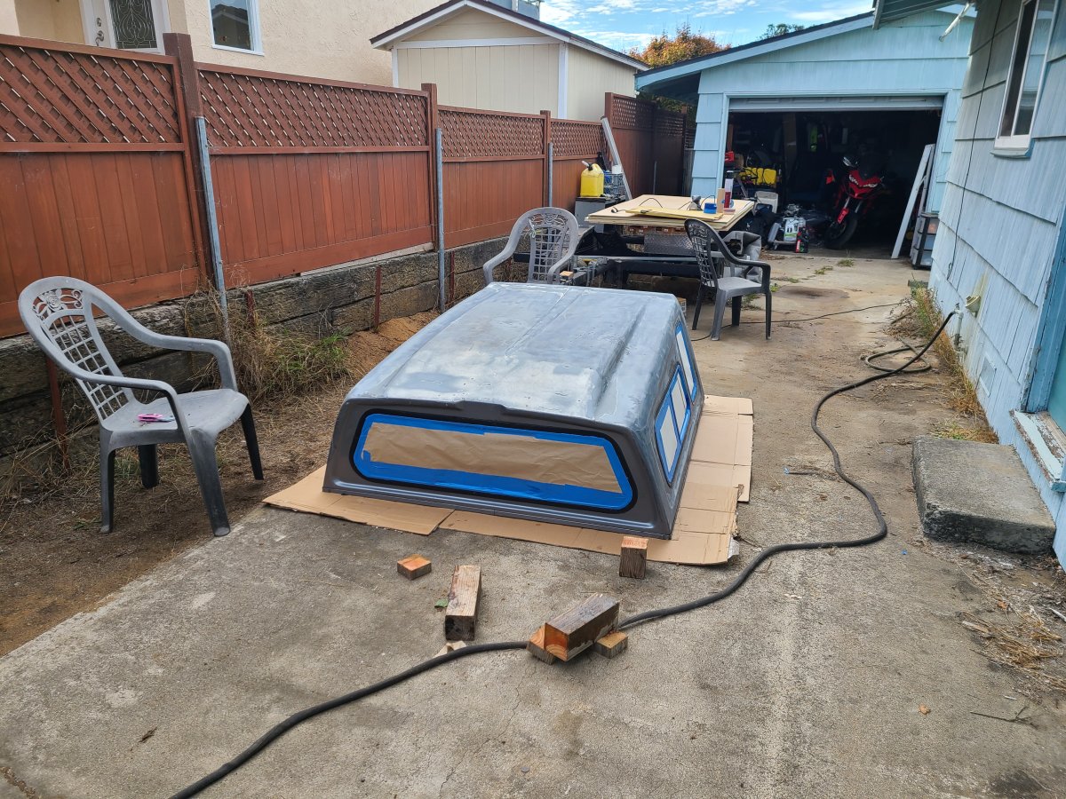

Ok so shell off and sanded!

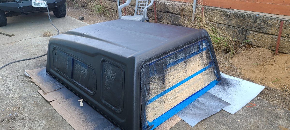

Then it's time for new paint. Rustoleum bedliner in a giant rattlecan ftw!
Have to say the Rustoleum works really well if you prep enough!

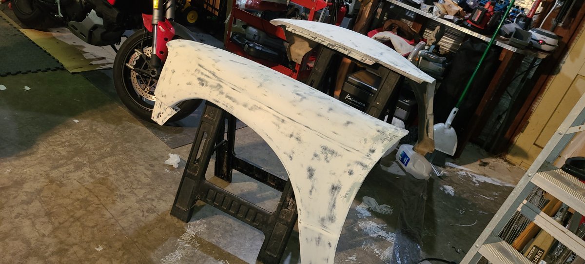

Sanding down the fiberglass fenders for paint!
These sat with nothing but rattlecan for over 12 years. There was some really nasty pitting going on. I sanded down into the glass mat and filled with epoxy and chopped mat. My neighbor shapes surfboards and gave me a clutch assizy. I didn't grab any pictures of that because of this next one.

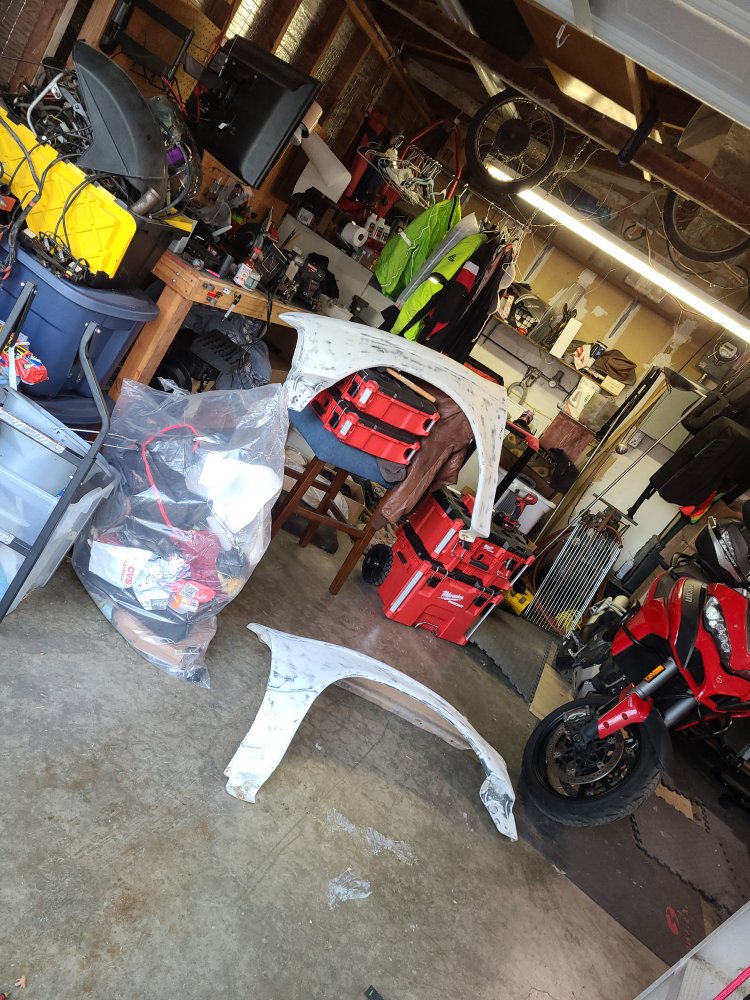

Ok so, I got the fenders sanded an epoxies but had to wait for them to dry and cure. What's a girl to do? How about install some lights!

Ok, the next day my fenders were dry, so time for bedliner!
I bed linered both sides because they are old and felt a bit flimsy.
Fenders are back on the truck!

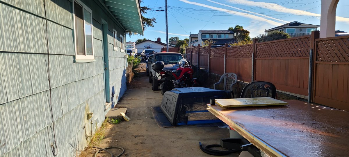

Now that the shell is painted it's time to mount the rack. I did this off the truck because I'm short and I had to do some square tube bending to make it all work.
Test fit:
Fabbing awning mounts that double as basket reinforcements for the Arksen basket I got off Amazon. For the price I think it's a stellar buy.
Cutting aluminum for the mounts and notching so it will bend with the shell curve.
This was a 2 person job, my wife lent a hand and it was really appreciated.

Full repaint of the bed and flex seal of the shell to the bed. Repainted the rear of the truck cab as well with bedliner.
Back together for a moment!
Not bad for an under $200 paint job. Whole truck is triple coated in bedliner including the shell. Much more to come!
