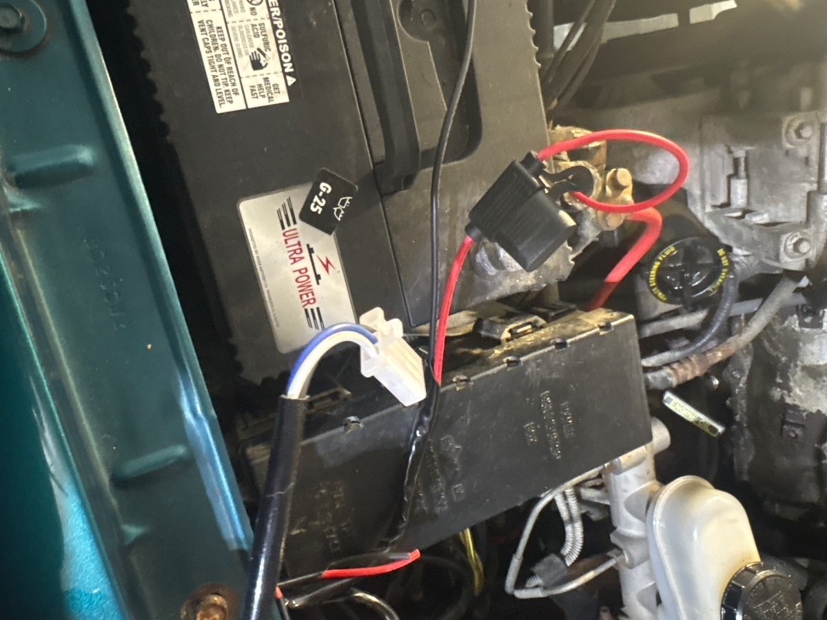

I need to get this wire thru my firewall the white end

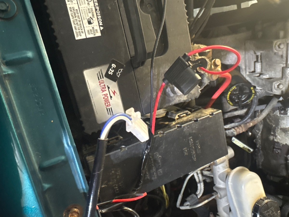

Personally, I’d consider un-pinning the plastic plug and putting the pins back in after getting it through a smaller hole. You have to be a little careful doing that cuz you don’t want to mess up the pins or get them switched around in the plug, but I do electrical a lot and it’s no thing for me.
De-pin it.
If I think if it later this afternoon, I’ll do a short video on that to show you how.
The one
i have no clue on how to do that. Is there any other way to get this thing thru
De-pin it.

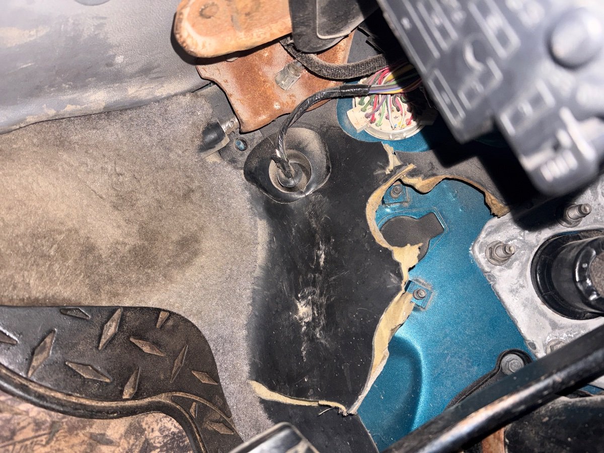

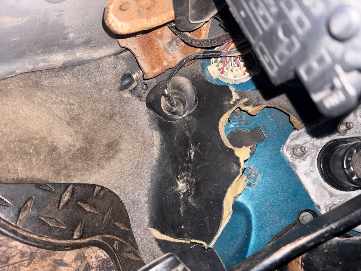

This truck is automatic could I shove it thru this?
  • Wiring thru firewall

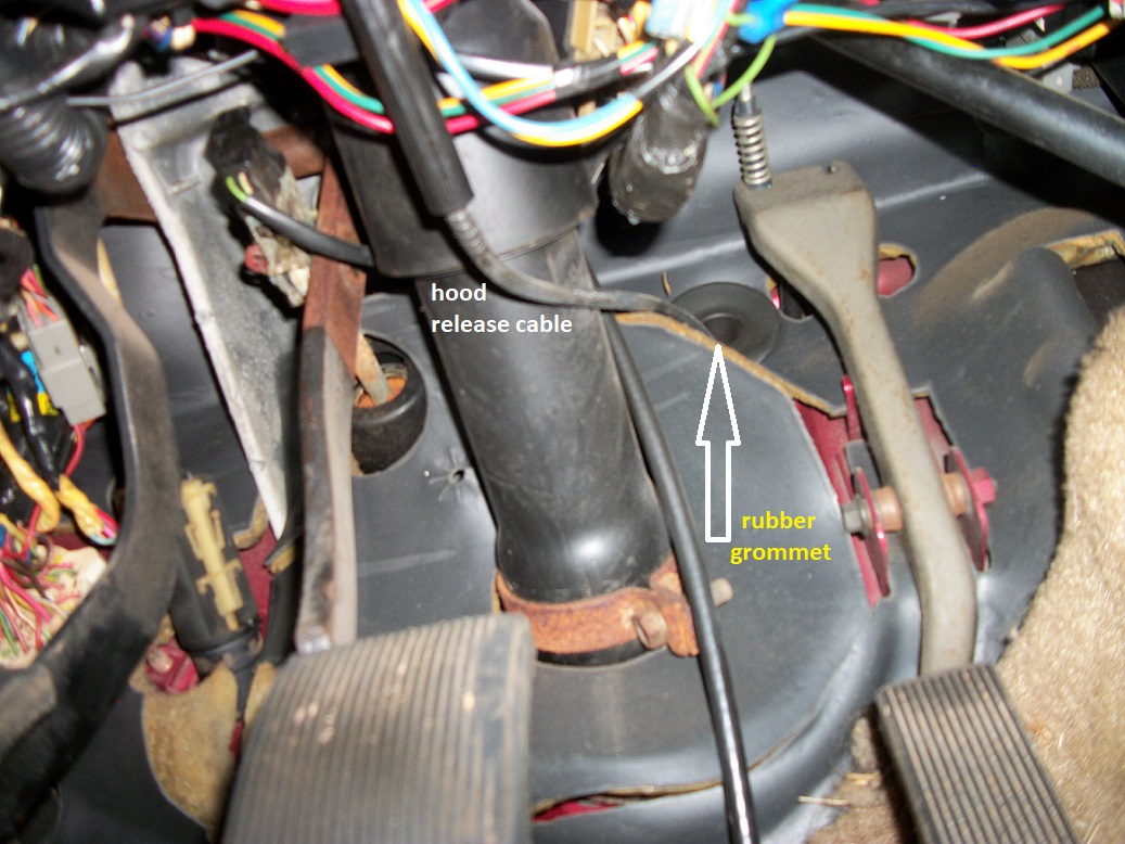

Yeah, you can go there.

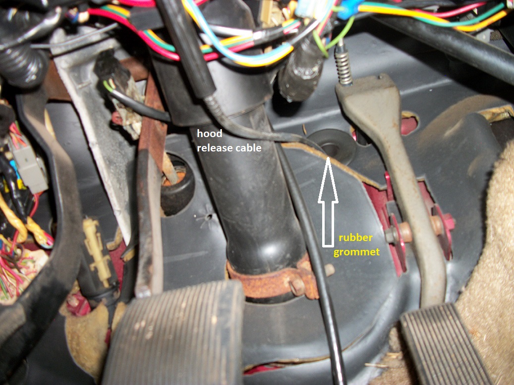

Or there's the hood release cable grommet shown here:
Definitely de-pin that wire to run it through, and put it through the rubber, not just beside it.
The clutch pedal cover?
I have no clue on how depin it I guess I’m gonna have to do this project another time I don’t know what I’m doing
