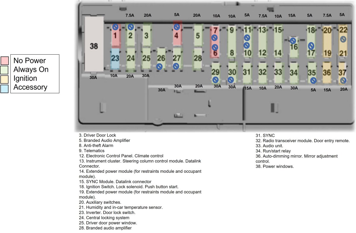

I'm getting my 2021 FX2 ready for the road and purchased a dash cam (not the Ford offering) that I need to install. I can plug it into the power port but would like to hard wire the power leads to keep things out of site. The camera package came with plugs that can go into the fuse box under the dash but they recommend using a switched source. There was an optional accessory fuse/switch option I could have ordered with the truck but didn't. Anyone have a good switched source in the cab? Thanks!!
