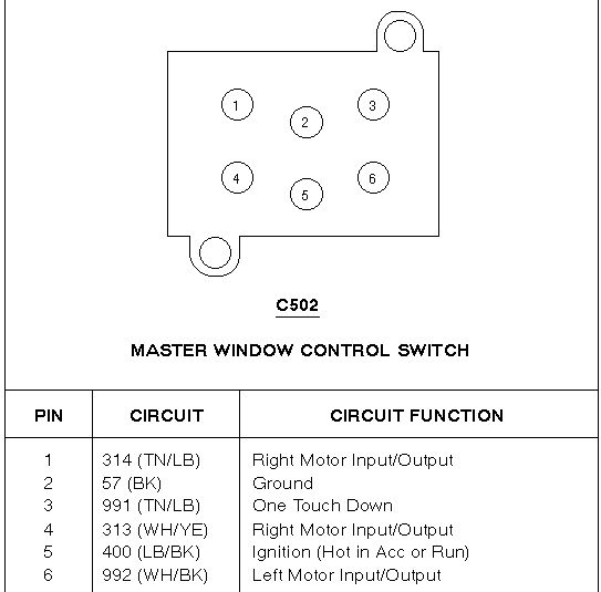

Okay, so I'm not the best when it comes to wiring up cars. I have a 2000 ranger that had a busted driver window. Took it apart and found the switch/connector was bad. Got a new one from the dealer, but ran into a snag with the connector; the wires from the new connector are all black, whereas the wires coming out of the harness are color coded.. All I need is a pinout or similar of the connector, showing which wire should be which color. if anyone can help it would be greatly appreciated.

The old connector is no longer connected, or I would already have done that.
Is this what you are looking for?
