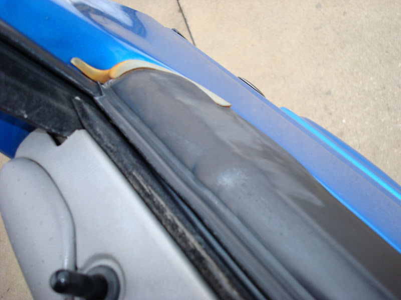

Hello, I'm new to the forum and I'm not quite certain if I'm thinking of the same part that's being discussed here. Is rubber piece with the bubbles of rust underneath referred to as the window gasket/anti rattle kit?
I've been trying to find a forum that describes replacement of this piece seeing as it is the most unsightly part of my truck, but it seems that just about everyone has a different name for this part and even the parts I've found on LMC aren't completely clear about what is what so I don't want to order the wrong part.
If this is the same part being discussed here, you say that replacement involves just peeling it up from this end....
...and then replacing it with LMC parts 50-7578 and 50-7579 (here is the link to the page they're on, they're #29 in the diagram from what I can tell)...
http://www.lmctruck.com/icatalog/fr/full.aspx?Page=15
My truck is a 1998 Ranger Extended Cab so I assume this is the right part but even that is a little unclear. Thank you for any guidance you can offer, it is greatly appreciated.

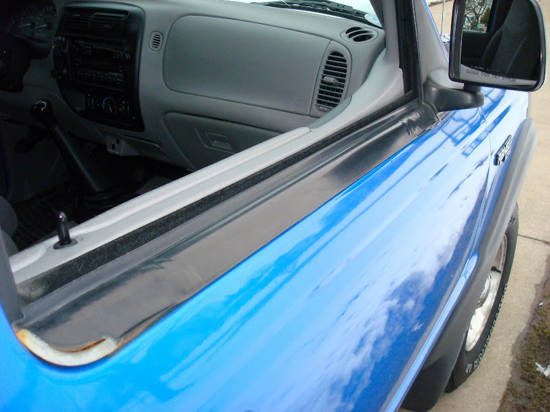

Well I got the new parts on there, I was going to take pics but after I got into the job I realized that it was so easy and self-explanatory that pictures weren't necessary. I didn't remove the door panel or the mirror, all I did was roll down the window and pull up on the plastic piece at the end toward the door handle (the plastic piece is the part that looks orange and almost white in the pics because it is so badly oxidized). If yours is too badly rusted at the end you may have to pull the rusted end out and then pull up from the middle where the metal underneath is solid, either way it should come out fairly easily.
I then cleaned and waxed the paint underneath where the strip sits before I put the new strip in. I also applied a coat of thick oil to the underside of the new strip, the clips, and the ends of the strip to prevent it from the same fate as the stock ones. You'll be able to see where the rust starts by comparing the old strip and the new one, the ends of the strip are bare metal from where the sheet metal was cut at the factory. If you use oil or grease, be careful not to get it on the felt that sit against the window, otherwise you'll have a greasy window every time you roll it down.
Once you have the new strip prepped to your satisfaction just slip it into place starting with the end toward the mirror because it sits slightly under the mirror, with a little bit of careful maneuvering, the new strip will slide right in.
