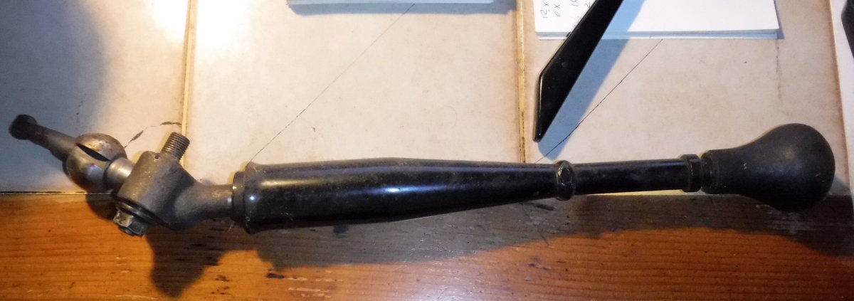

Does anyone have a 13-54 manual shifter that they will loan me to use as a template to make my own? I will pay $200 as a "hold fee" to ensure that I send it back to you!!
I sold my one 5speed . I don't need this shifter. I still have one setup left . It is a 1354 , boot is usable. 160.00
Oops. Here's the pictures

Here is one of like 10 parts in the shifter
Only need the arm that goes to the T-Case…. The rest you can get from the plentiful 13-50 shifter.
Are you talking about this?
Are you talking about this? View attachment 87934
I think he is after the little stub lever on the t-case itself so a person can just use a "1350 shifter" which is more common than the 1354 lever set. I would assume the later 1350 shifter (right) not the earlier shorter one (left).
This is the stub off my C5 equipped 1350, the 1354 is similarish but has a couple bends in it.
I think it is going to be a treat to get the geometry just right, close isn't really good enough for these and the stupid shift gate/dogleg pattern on the Ford shifter is going to screw with the throw. I don't know how strong the detents are in a 1350/1354 tcase but after going to a straight pattern NP205... I don't miss the 1350 dogleg to get down into low a bit.
Correct….
Although, either of those 13-50 shifters will work when you replace the arm with the 13-54 one.
