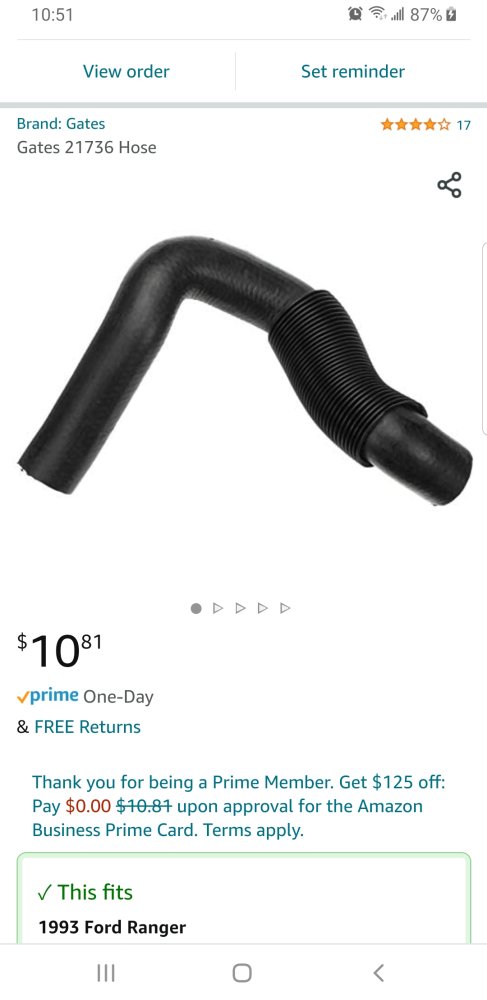

Hey guys will this fit a 93 Ranger 4.0 OHV? I just bought it for $11 on Amazon. It says it fits, im just checking to make sure, if anyone knows...

I don't trust Amazon a bunch when it comes to part numbers... although they're pretty good.
In this case I would take that Gates number from the listing and just Google it to determine its usage.
Good idea. Thanks. ;)
Went to a few reputable sellers online. It seems to be the correct hose.
There are two lower hose styles - auto trans and manual trans and they have different radiators. That only matters because the lower outlet on the auto radiator is angled down as opposed to straight out on the manual trans one.
RockAuto has that one listed for manual trans application... 21623 is the auto trans hose. I assume you have an auto, it will probably work but will not fit very well.
@Shran . Thanks so much, I just cancelled the other hose and got this one.
