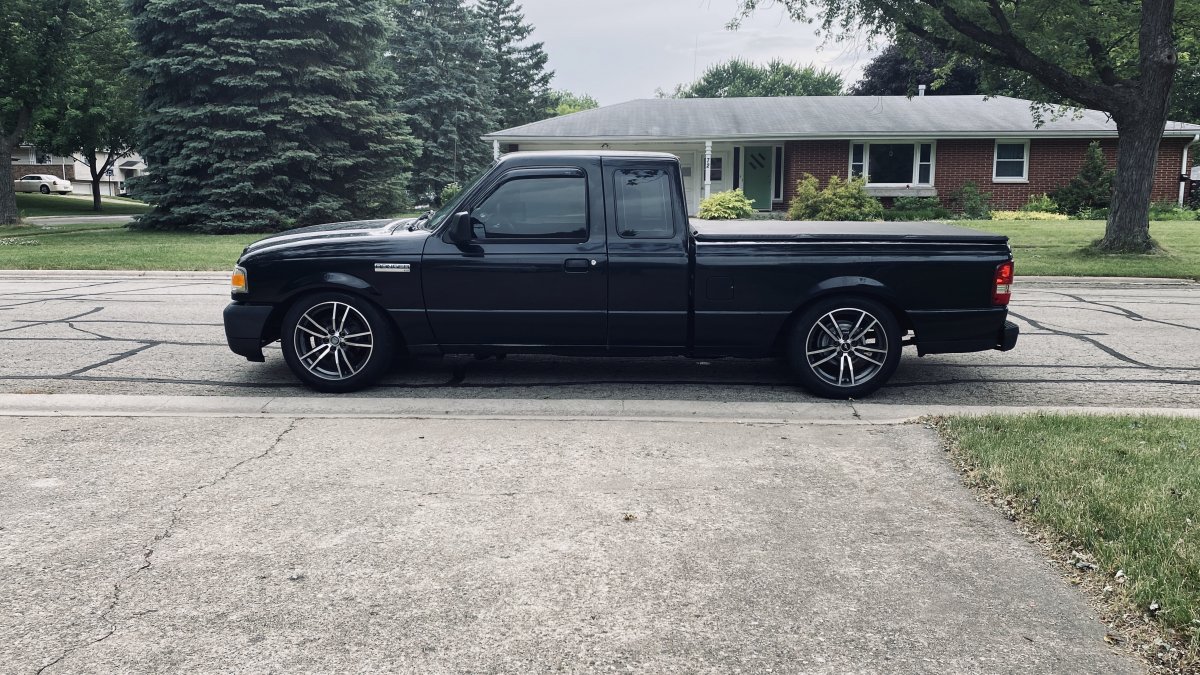

Well. I thought I was smarter than the average bear.... nope.. I picked up a set of 2012 GT wheels (18”) for my ‘06. In order to use them I need spacers. The stock lugs are 1 5/8” long so I would need spacers as thick as them. Looks like 2” is really the only option. 2” spacers will push the wheels just too close to the wheelwells.

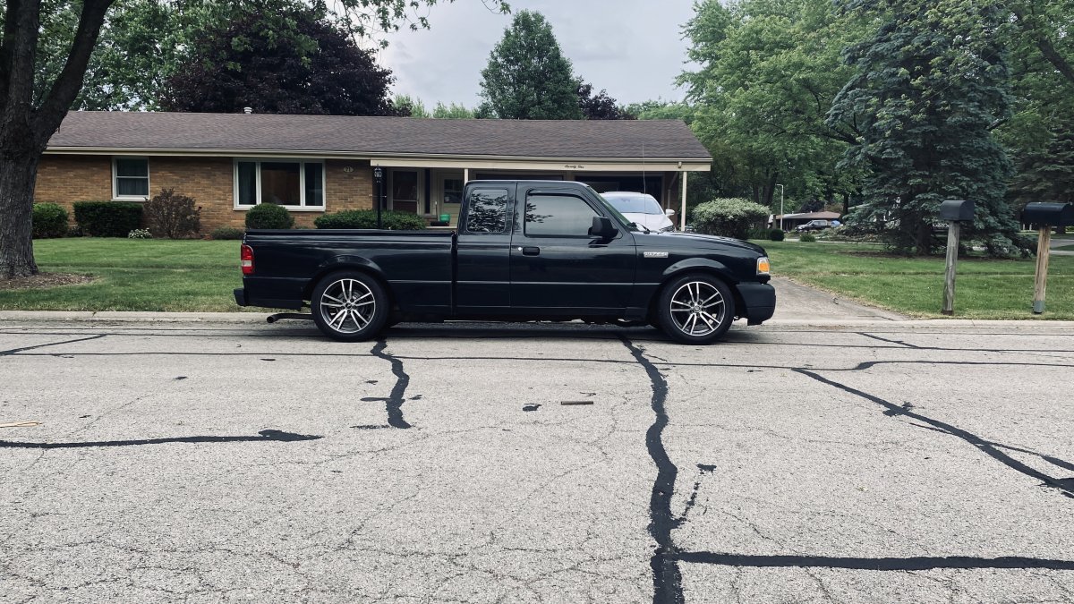

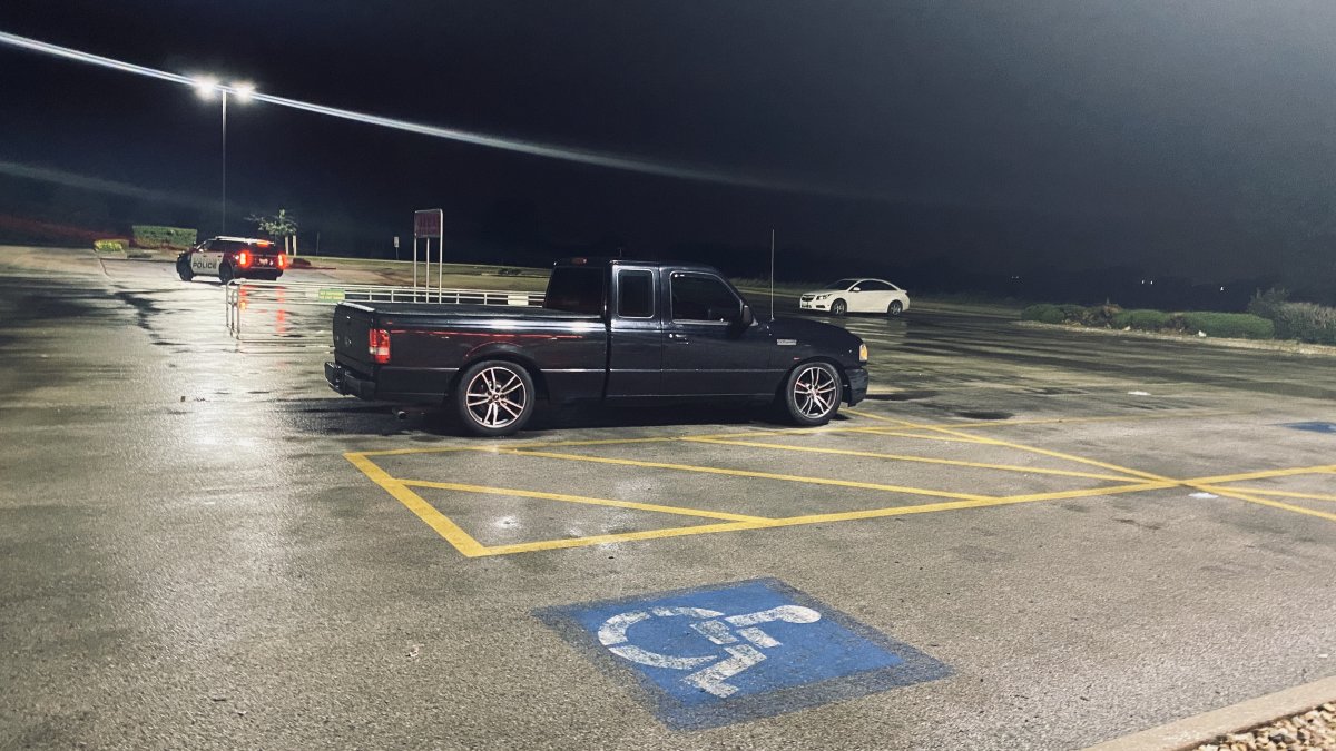

Few more..

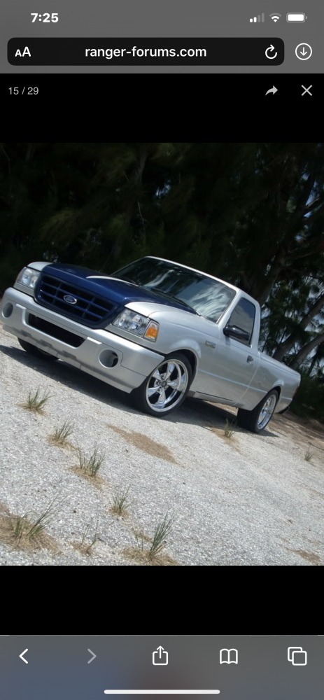

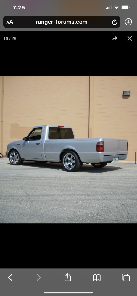

I wonder what spacers are on these?

The last ones pictured look like SN95 wheels to me. And yes, shorter spacers take advantage of the pockets that are often machined into the back of the hubs for stud clearance.

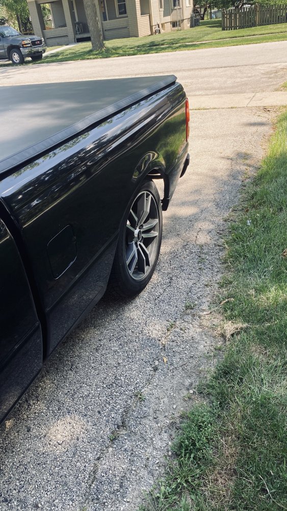

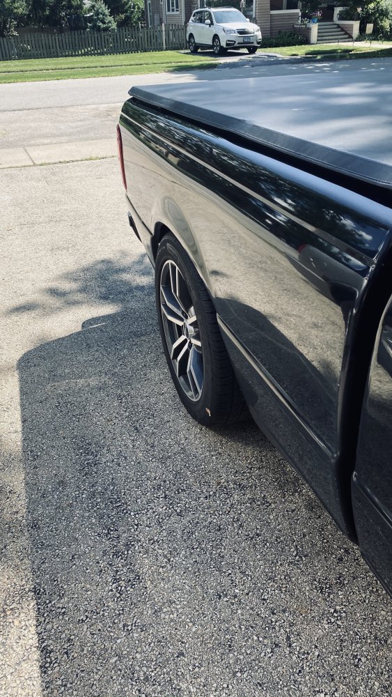

Ok... finally got it right... Before and after. Now I have to install the new upper and lower control arms so I can get the alignment done..
