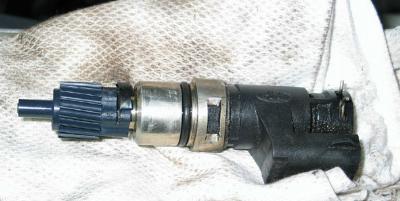

You're missing what everyone is telling you. There is a VSS in the transmission that sends a signal to your speedo.
The sensor in the rear diff is the ABS sensor. That 'gear' you are seeing is the tone ring that the ABS sensor reads.
Really thats interesting man, like I said Im not worried about the ABS light on as much as I would really like to know how fast Im going. Im confused because right where the hole is for that sensor there seems to be a gear, whats that for then? So the 96 speedo is ran by what? I hate being lost on something so small. AHHHH!!!!
The '96 speedo gets its signal from THE VSS (Vehicle Speed Sensor) ON THE TRANS. It looks like the VSS used on the earlier trucks, without the speedo cable. The sensor on the the rear is FOR THE ABS.

Here is a pic of the speed sensor vss:

95-97 Rangers use a VSS. Again, yours will be located in the tail of the transmission.
Man I feel like a such a dummy, I thought that hole and that sensor was for the speedometer this whole time but its the ABS! So the speedo is hooked up to the tranny on the 1996 huh? Man I could have had that broncoII axle in the Ranger already. Somethings I swear some people's kids.
