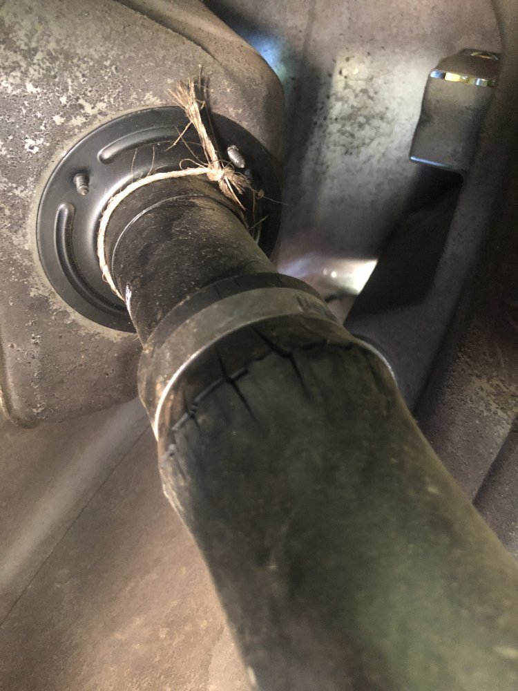

Redid the Gas Tank Fill hose on my 1994 XLT right after I purchased it about 2 years ago. Purchased fill hose from amazon and installed it. Worked well until this winter. Daughter uses it while at college so it does not get filled up much. ((This is also why I am only on when the ranger is here)) I flew out to ride with her back last week. She filled up the truck and gas went everywhere when the pump clicked off. Why would a fill hose go bad that fast? Suggestions on the replacement hose that will last a lot longer?

Yes it is tight...there are splits at both ends of the hose. Here is a pic of the intake end. You should be able to see splits at the flared section.

Crappy chinese rubber
That's what cheap material looks like. Replacement parts are such a crapshoot these days; you can think that by paying extra for higher cost parts you're getting better quality, but can still end up getting ripped off.

This thought came to my mind, but then I am thinking "why is anyone replacing these hoses"? It sounds like the factory hoses were defective. I have had older cars and trucks that still have the original hoses on them. And when you look online, many many stores carry this particular hose you are looking for. There must be a high demand for them to reproduce them or they would not make them. I looked for a TSB from Ford on it, but could not find anything.
A lot of car parts from Asia, including Japan in the past, use natural rubber instead of neoprene, since the natural stuff is plentiful and cheap there. This includes hoses, gaskets, and seals. Neoprene stands up to petroleum products and weathering far better over time than does natural rubber (isoprene). Oil and fuel eventually will affect neoprene, but it takes a lot longer.
That "mystery meat" fuel hose is probably natural rubber. Check a good auto-parts store for generic neoprene hose in the right size.
