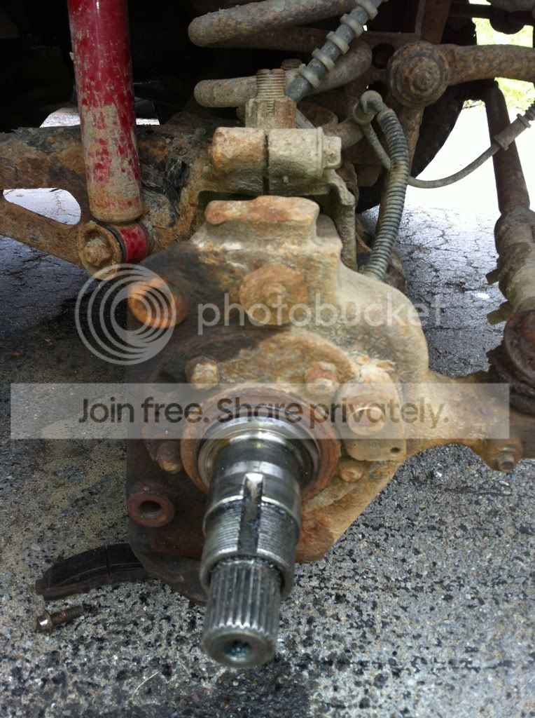

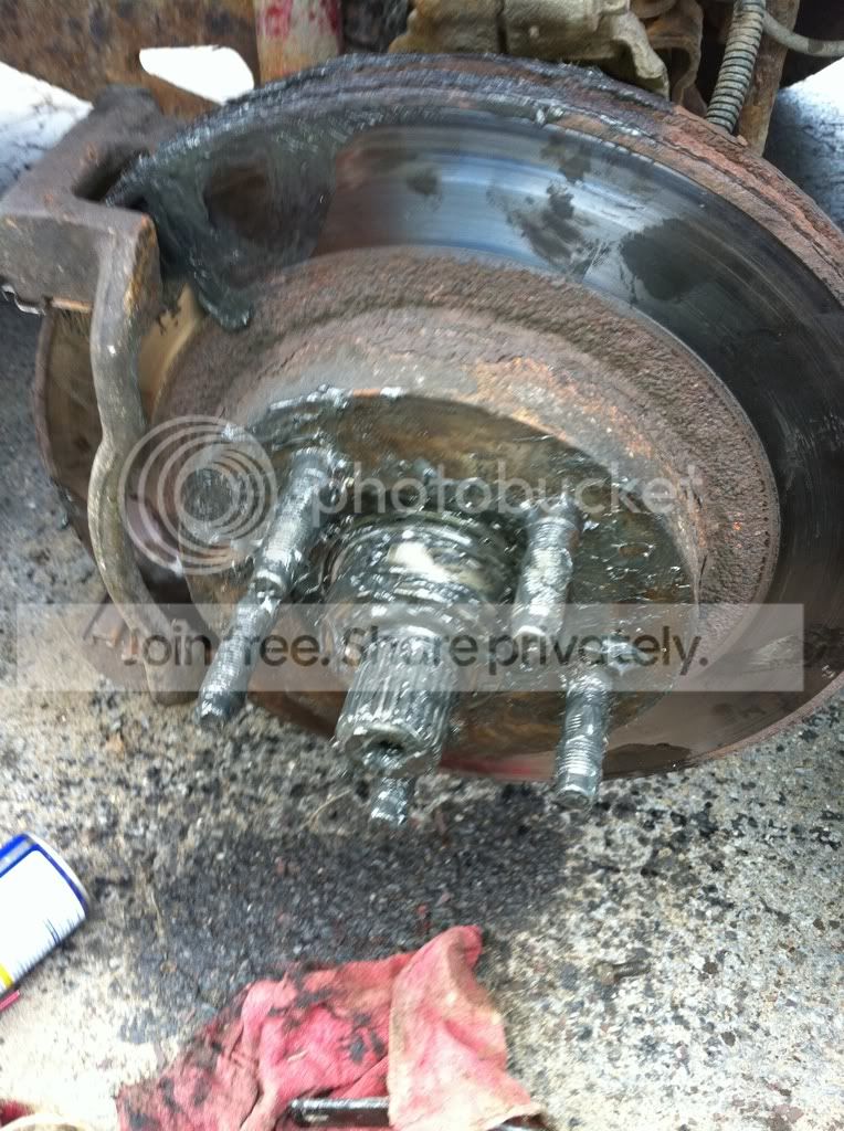

My right front rotor keeps coming loose, I know this because it starts to make a thumping noise at higher speeds, the other reason i know this is because every time I tighten the nuts or whatever they are, they always seem to come loose, I wish it was a crown nut that way I could use a pin to keep it there.
Maybe I'm missing something?
Thanks
Dan B.
I'm assuming you know how to set up wheel bearings here...
The outer lock needs to be torqued to 200-250 ft lbs.
Hard to tell with the grease on it, but am I not seeing the locking washer in between the two nuts?
(washer shown in this pic clicky)
