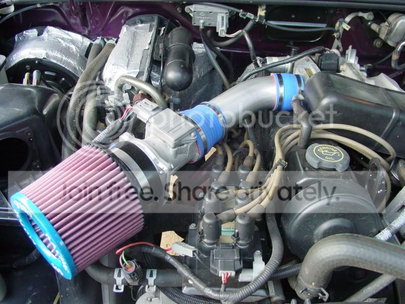

I have a very similar intake for mine, but like I said before, it felt like it slowed the truck down and made it harder to drive. Is the 95 an OBDII? Its funny how different yours and my engine compartment look. Oh and was this a pic during an oil change??haha
here is my intake-
