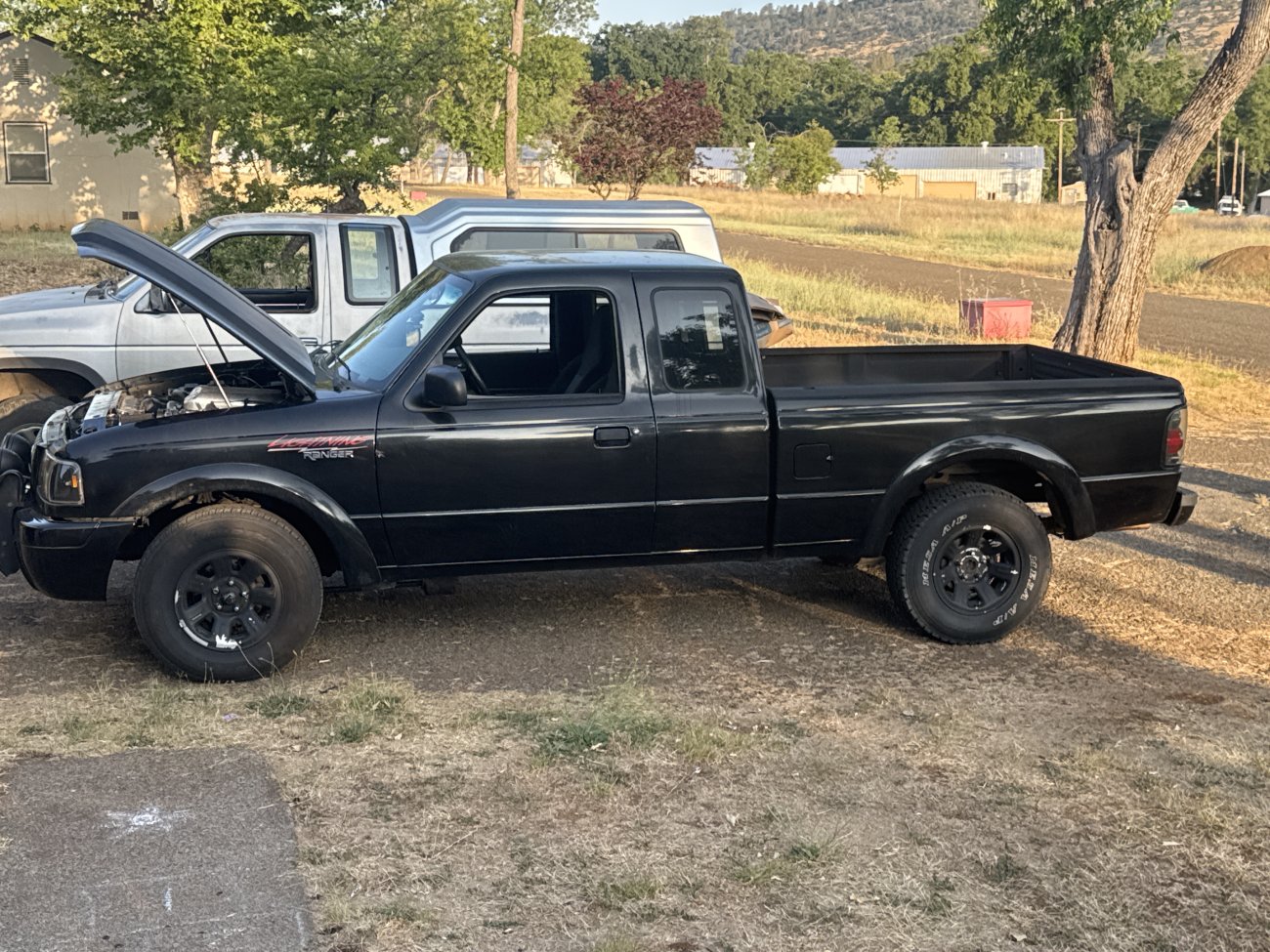

I have recently acquired a Ford ranger with this Whipple charger kit with a 10 pulley I have a question for you Stmitch I was wondering what you have done to your truck or know what I can do to it I have had a custom tune put on a sct tuner and everything else that I know of is stock I have one cylinder that has low compression like 110 hoping it’s valves or head gasket not that much out there on these setups might go through the motor just wondering what I can do if I take apart this motor if it rings appreciate the help
Don't think I've ever seen a polished kit in the wild. That's cool, and probably even more rare than the standard black finish!
Seems like a pretty fun truck if it works. The Hurst + Whipple combo is a good time.
It looks like somebody has eliminated the factory airbox and MAF location. That may be fine, but if you have any MAF related FCs, or driveability issues, that might be worth checking over closely.

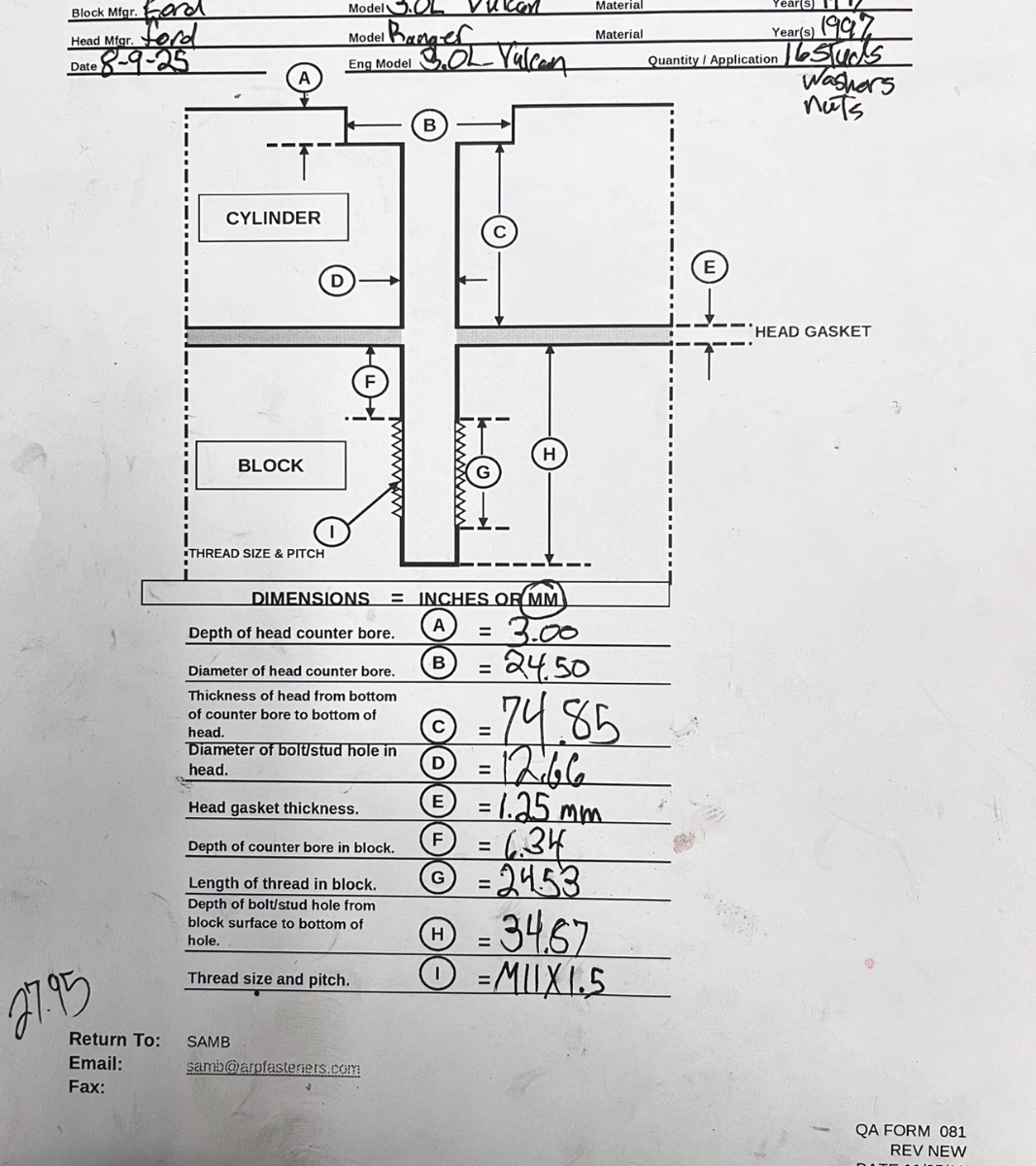

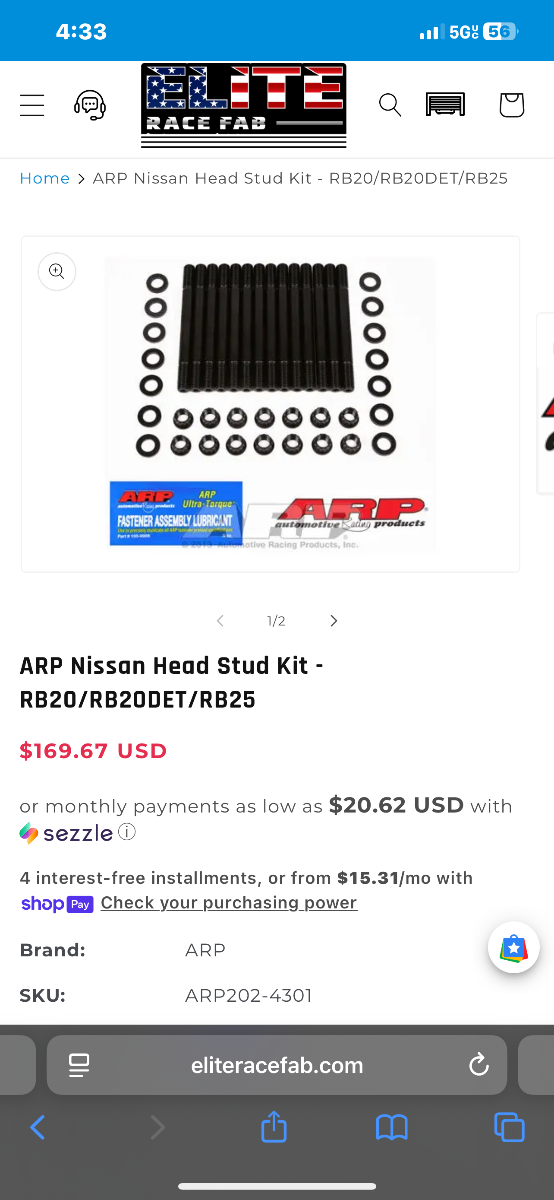

Well I have come to bring my fellow 3.0L Vulcan fans some knowledge! My engine is currently apart at my work, so I reached out to ARP n asked them if they by chance had a kit cuz of what we’ve seen on Tom’s website. They sent me a form to fill out with the measurements etc. Sent it back to them and they came back with the kit that matched what I need. Well the kit that shares similarities came back as Nissan’s RB20/RB25 stud kit. You will need to purchase 2 more studs, washers n nuts because that kit comes with 14, N the 3.0L requires 16. So with all that being said an admin may want to pin this somewhere since I believe I’m one of very few to have said Information? Correct me if I am wrong by all means though!
