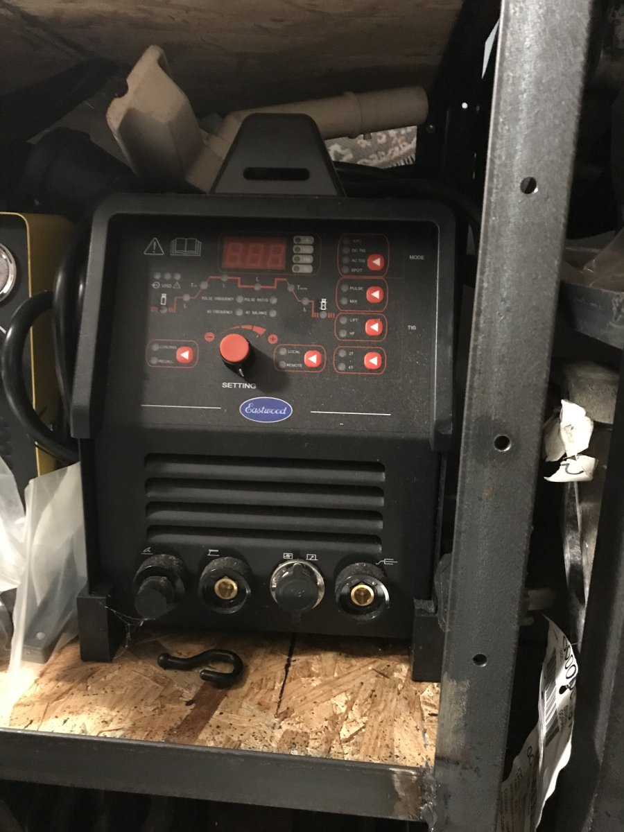

My only TIG experience is with my multi process welder, it's only capable of DC scratch start TIG and the wand just has a gas knob, I can see where a pedal and high frequency start would be huge game changers...

now all I need is the manual, hope it has lots of pics :icon_welder:
