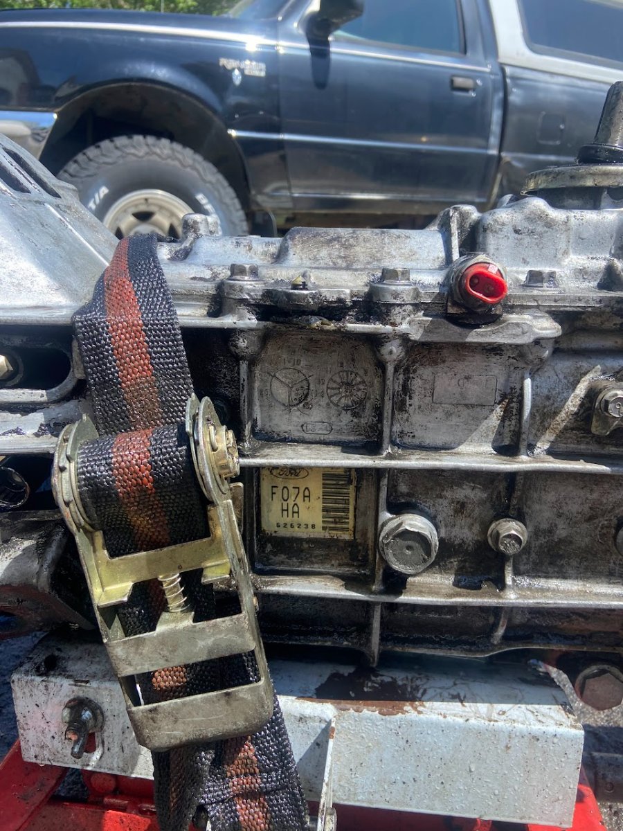

I just bought a 1990 Ranger 2.3, 5 speed manual, 2wd for a project truck for me and my 12yr old nephew to work on together.
The book says it has one of the two makes of transmission: Mitsubishi or a Mazda. I cant figure out which this ranger has. I've looked up the VIN and the tag on the transmission and can't find a definite answer.
The book says all manual transmissions take SAE 80W transmission fluid except for the Mazda which takes MERCON automatic fluid. My luck it would be the Mazda and I put the wrong fluid in.
Can someone identify my transmission?
Thank you in advance!

That's definitely a Mazda.
Which tranny does this truck have?
This is a FM146
Yes, that is the Mazda transmission. I recognize that reverse light switch, I have changed mine many times.
I'm pretty sure the FM146 can have the same or at least similar exterior appearance reverse light switch. Mine did. It probably wasn't original. The truck came with receipts for a transmission rebuild.
I don't see one in the FM146 photo SenorNoob showed above.
This is a FM146
Thank you for the quick response and info! Now we can get to work.
Thanks everyone!
Just to put it out there, the 4 cylinder Rangers were the first to get the M5OD and that happened sometime around mid '87 or '88 and the door sticker should have an M like yours has, but yes what has been posted above is all correct.
