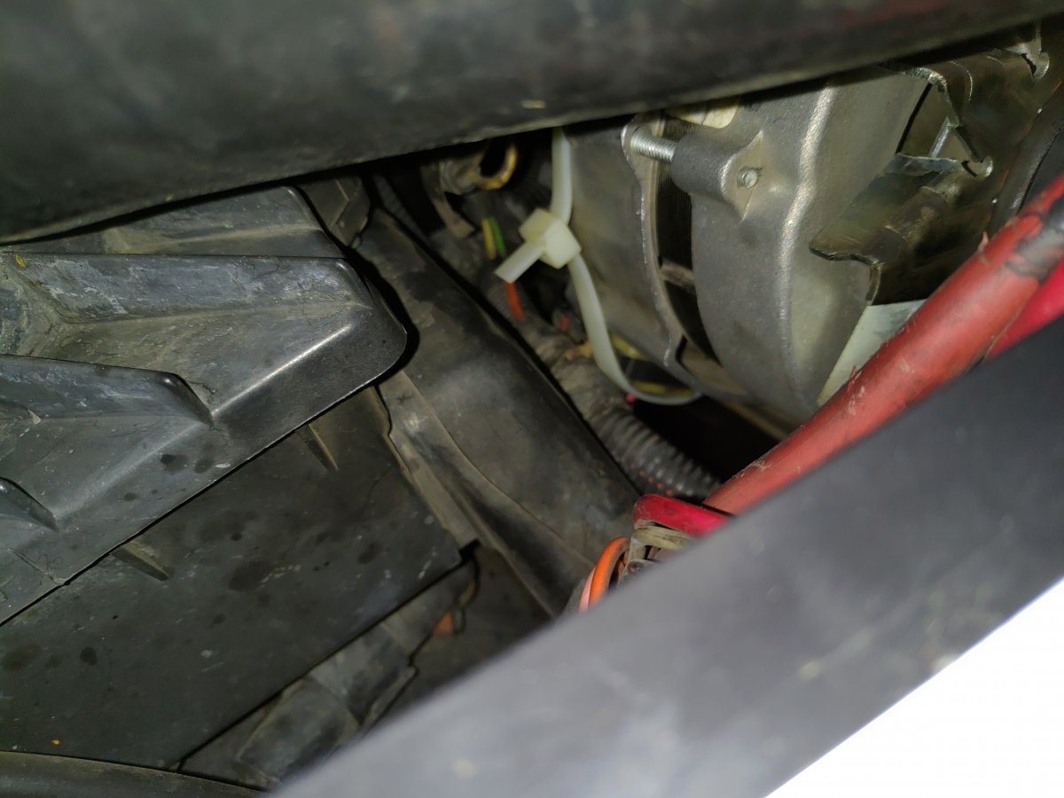

In the photo you can see where I have the nylon cable tie around the alternator and the black and white pigtail connector. I'd like to use a stainless steel cable tie or a little metal screw clamp instead. Would either of these cause any electrical interference with the alternator? P_20211018_185211.jpg
I'm going to start making consumer complaints about these plastic retainer clips. I'm tired of these things breaking.
In the photo you can see where I have the nylon cable tie around the alternator and the black and white pigtail connector. I'd like to use a stainless steel cable tie or a little metal screw clamp instead. Would either of these cause any electrical interference with the alternator?View attachment 67193
You're probably better off just making a proper wiring repair here. We all have done quick repairs to get home or rig it until it can be repaired properly. Sometimes they even last forever... others they fail again when you least need it too.
Most connectors have a sweet spot... they usually jump apart when you find it. Maybe try going at disconnecting things with a bit more finesse and thoughtfulness.

There is no way I could have removed that alternator connector more carefully without breaking the clip.
Those plastic clips will break no matter how careful you are. I no longer go to service garages. But when I did, I used to find where mechanics broke the connector retaining clips without bothering to repair or tell me about it,
I was looking again at Robbie's suggestion of removing the wedge and wire terminals from the pigtail connector. I am a bit leery........but open-minded about trying this in the future.

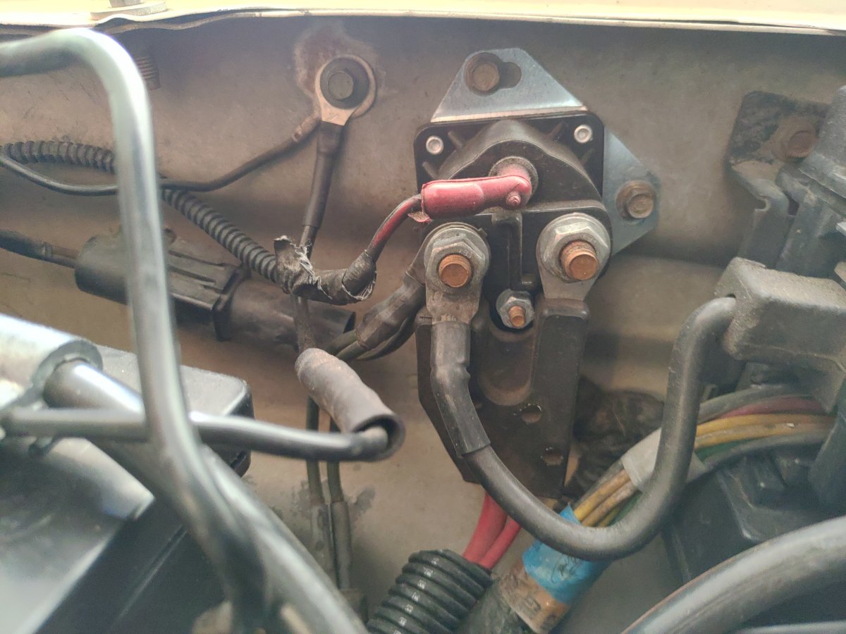

I have a 92' Ranger XLT with 2.9 V6. I need to test my alternator/voltage regulator for excessive voltage, with my multi-meter. The instructions in the manual say connect the positive lead to the alternator output connection at the starter relay. I included a photo of the starter relay. Which one is the alternator output connection?
It is the big black wire coming out of the fuse box. The yellow wire comes directly of the alt to the inside of the fuse box, 40 amp fuse. The black and orange wire comes off the alt to the front side of the fuse box , 60 amp fuse. Those 2 wires run all the way across and behind the radiator support. I have a picture of that harness because I used those wires on a 88 that is giving me fits.
