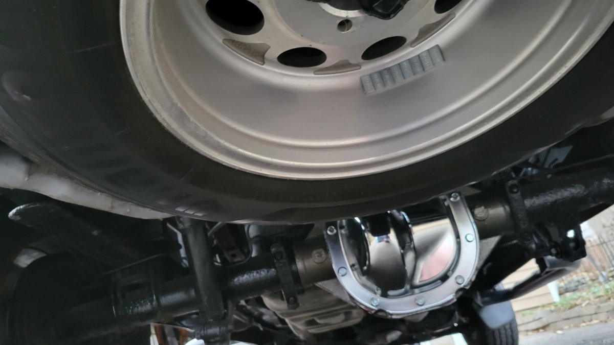

I got the Torsen limited slip. It's well mannered too. The mechanic told me that when he heard I wanted a limited slip installed on a 2003 Ford Ranger, he thought I was crazy. After all, who would ever want to spend so much on an old truck. That was before he looked underneath and found everything had been sandblasted and repainted, that it had several suspension upgrades too.

So that old limited slip on back of that 96 Explorer is worth $700?

Yes, its VERY clean under there.......................too clean
