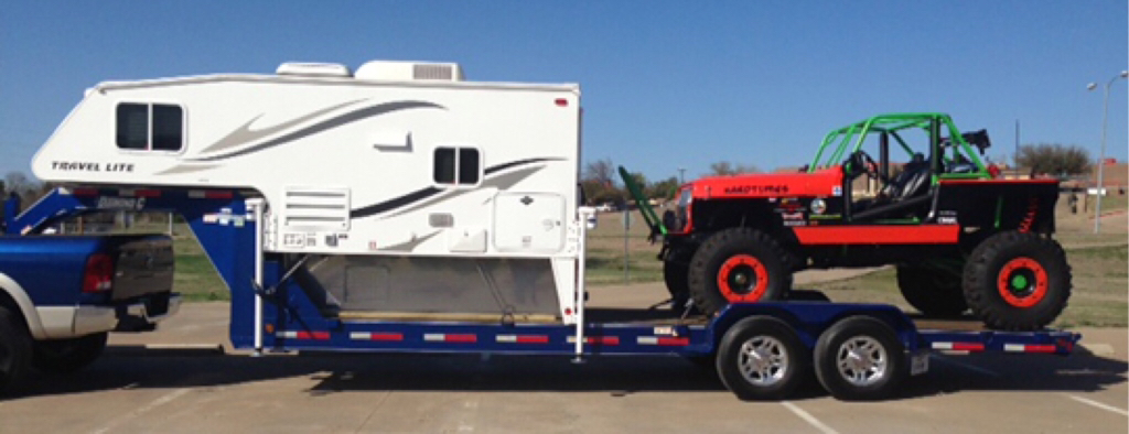

Hey guys, so in the next couple of months I’m gonna be in the market for a mid 90’s ish f150 but I’m not the most proficient on them. I’m gonna be looking for one to use as a daily and a tow pig. It won’t get a lot of miles annually, probably around the 8-10k mark. When I tow with it I plan on towing a gooseneck camper/flatbed with my ranger on it so maybe 7k at the most.
If I’m not mistaken the f1’s of that period came with three options, the 302, 351 and the straight six.
I can probably rule out the 302 as it will be the least powerful of them. I hear that the 300 i6 is a torque monster but I don’t know anything about those motors and any insight would be appreciated. I assume the 351 would do me fine and it will have plenty of on the shelf parts being a sbf.
Mostly I’m just looking for input between the i6 and the 351 for a truck that won’t see a lot of miles and will tow a few times a year.
This is the type of setup I plan on pulling around.
get an idi 250. an ats or banks would be ideal....
I don't know if I would want to tow that with a stock 150....any factory engine.....or kill myself.
That type of setup is a 9000lb MINIMUM, 3000lb trailer, 2000lb camper and 4000lb Ranger plus gear and gas...
That setup is basically what I want to do, but I got a 7.3L Powerstroke in a reconstructed title '97 crew cab F350... For now I put the camper in the truck (and unfortunately I ended up with a 11' camper, so have a 4' hitch extension...), 12' car trailer (yes the Ranger is 14' long, there's overhang on both ends...) and the 3 wheeler in the bed of the Ranger. That setup on the way home from camping/wheeling was just short of 18k pounds and that poor 7.3 was doing 38mph up the mountain pass both ways... I bet with an intercooler I could at least get to 4th gear...
I'm with Bobby though, an IDI with a turbo will outdo a early powerstroke like mine mileage wise and probably power wise, and be cheaper... The 7.3's were cheaper 5 years ago though...

Scott, I’m betting I can keep it under 7k. I’ve got a trailer I’m looking at that is pretty light itself and I’m keeping my eyes out for a small camper. And my ranger will be under 2.7k by the time it’s ready to go out. Gear and gas might put me over 7k but the initial setup should be under.

Finding the right trailer and camper is going to be the hardest part of this all. The trailer I’m looking at is actually an old fifth wheel camper that is stripped down to frame. It’s really light but it might be too light to put the truck on. It probably only weighs 1500 five or take. And I’m looking for a small cab over or even a pop up trailer to stick on it and I figure I can stay under 1500 dry on that. Then the truck will be somewhere around the 25-2700 mark. Factor in gas and gear and some margin for error and it should be under my guesstimate. Even still I know it’ll tax an f1 but I don’t want diesel and I’d prefer not to go big block unless I find a killer deal on an f2.
I’m just keeping in mind that I might see 1200 towing miles a year and the rest is in town daily driving so I don’t want to go over kill on a truck that I won’t need.
