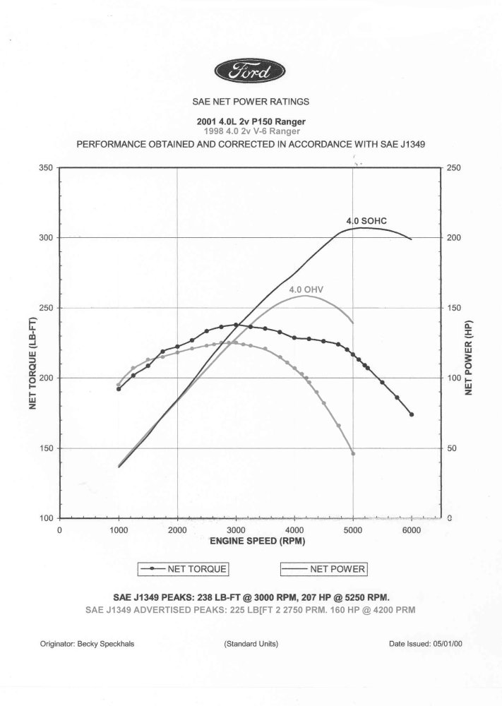

I tow with and run my Ranger hard. I want as much power as I can get without over stressing it. It has been stated that the SOHC has a little more power than the OHV engine and you have to rev the SOHC to get power out of it. It is true you get a lot more power at higher rpm than the OHV is capable of, but the SOHC also has more power at lower rpm. I have a graph comparing the two in HP and torque. It shows the SOHC engine has more power and torque even at 2000 rpm and significantly more at higher rpm. I will post it when I find it.

I promised to show the graph comparing the power of the two engines. Here it is for anyone interested. As you can see, the OHV has a little more torque than the SOHC under 1600 rpm, but above that the SOHC shines. Up until 2200 rpm they both put out the same HP. After that the SOHC pulls away.
The problem with the cam drive chain system was pretty much resolved around 2003 with only a few exceptions. So, both engines are durable.
