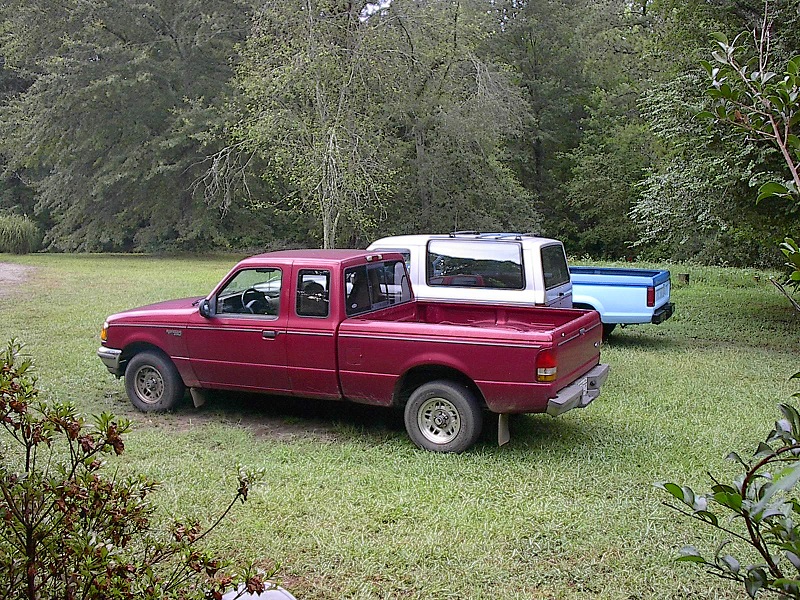

Your Ranger looks like it was well taken care of, too; and it looks like a twin to my '94:
