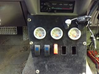

I built a center console for gauges outlets and switches under my climate controls.
I didn't like the "A"pillar idea or having gauges obstructing my vision by being on top of my dash.
So far I have....
1 red covered arming switch to turn the engine cooling fan on and off for deep water fording
2 12V outlets
2 LED light switches (blue), for the 2 inboard and 2 outbourd lights on the brush guard
3 gauges, L to R, Engine oil temp, trans oil temp and Volt meter
Planed are...
1 yellow switch to control 2 side looking LED lights
1 red switch to control the air compressor so it doesn't cycle when I don't need it
1 USB outlet
1 red indicator light reminding me my electric engine cooling fan is OFF!!!!
The problem I'm having is, where do I hook up the Engine oil temp censor?
Thanks for your help,
J
