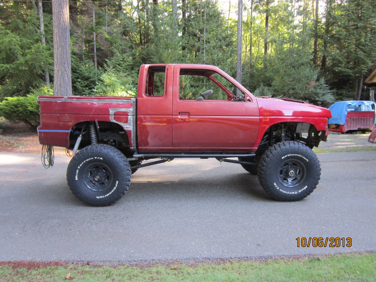

Is it just an optical illusion or is the pinion actually angled up that high?
Looks cool though. :icon_thumby:
It is an optical illusion, but I did cut and turn the "C"s on the axle. It looks more of an angle that it is.

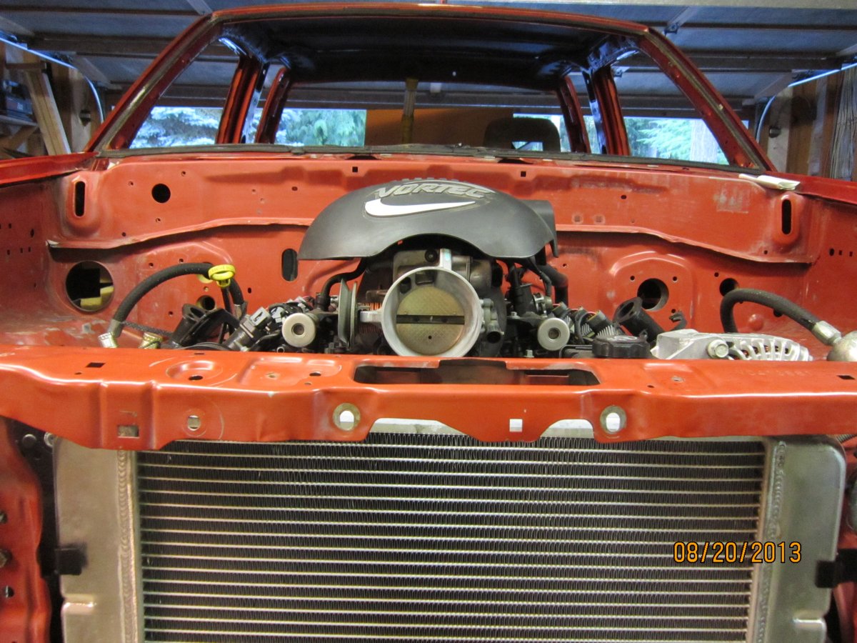

fitting the V8 under the crossover hoop...
That's not going to fit..
56056
56058
much better... I would have rather had the truck intake for torque, but when you are adding roughly 3 times the HP and torque to what was stock I fudge a little...

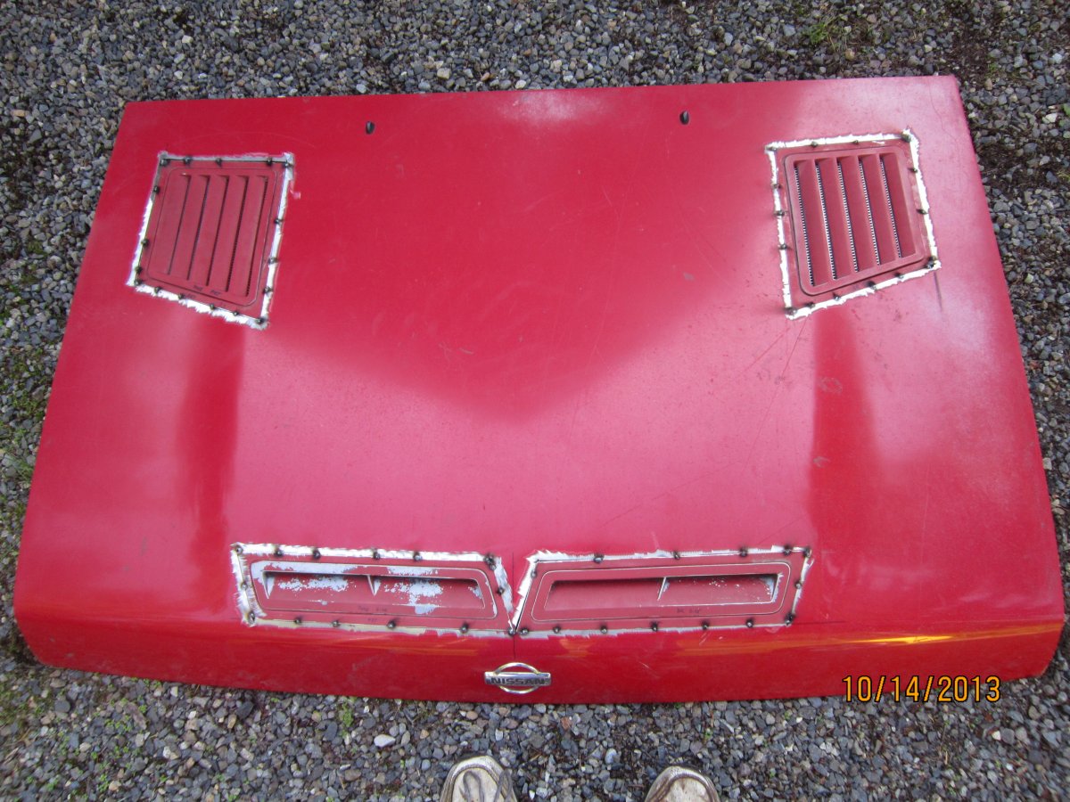

Installed Trans Am hood vents/scoops in the hood to dissipate heat while wheeling

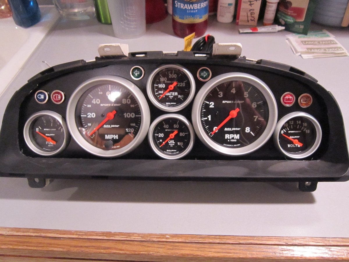

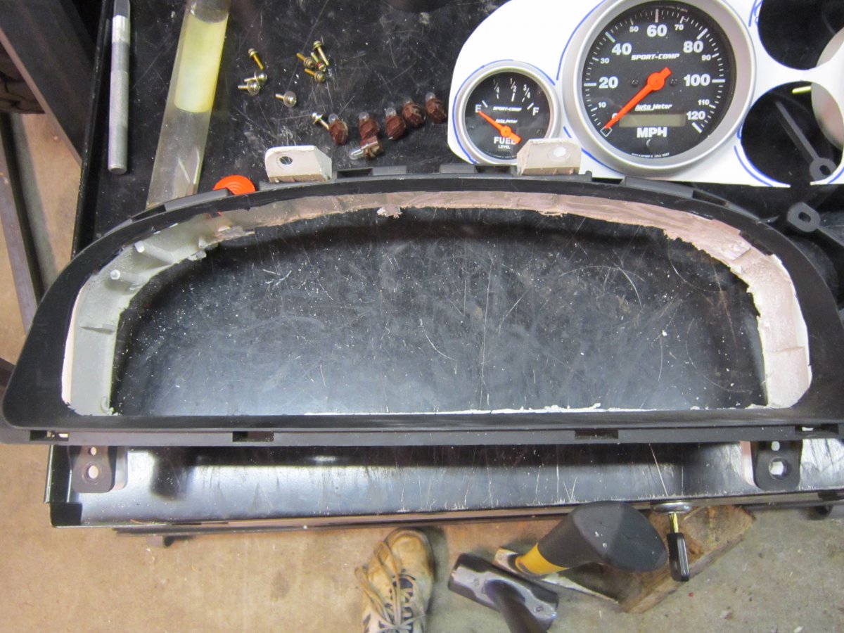

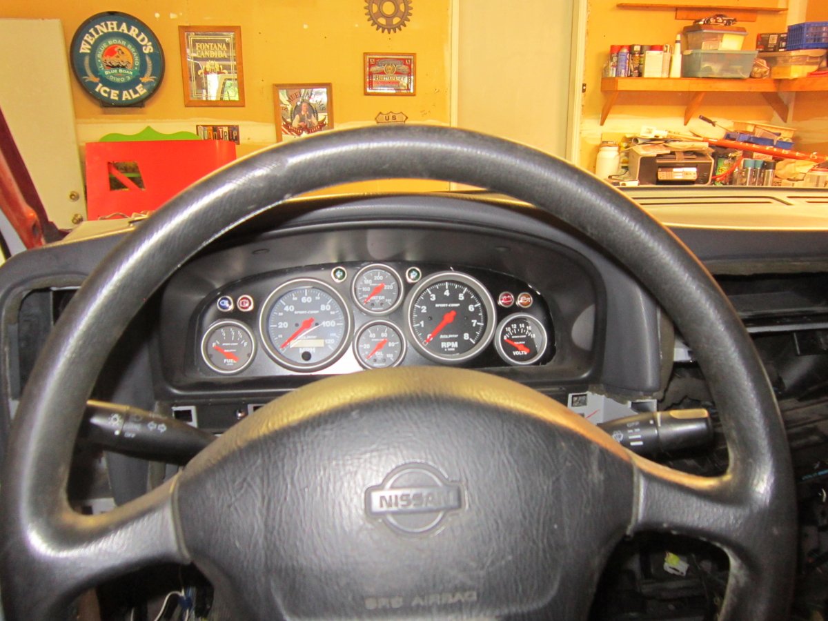

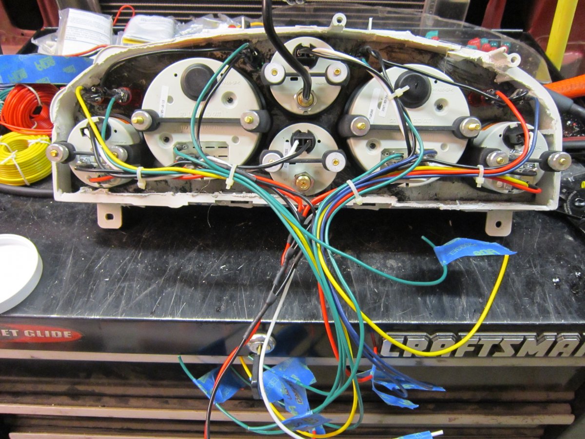

Built a cluster to fit the dash...
56065
56066
56067
56068
started wiring it...

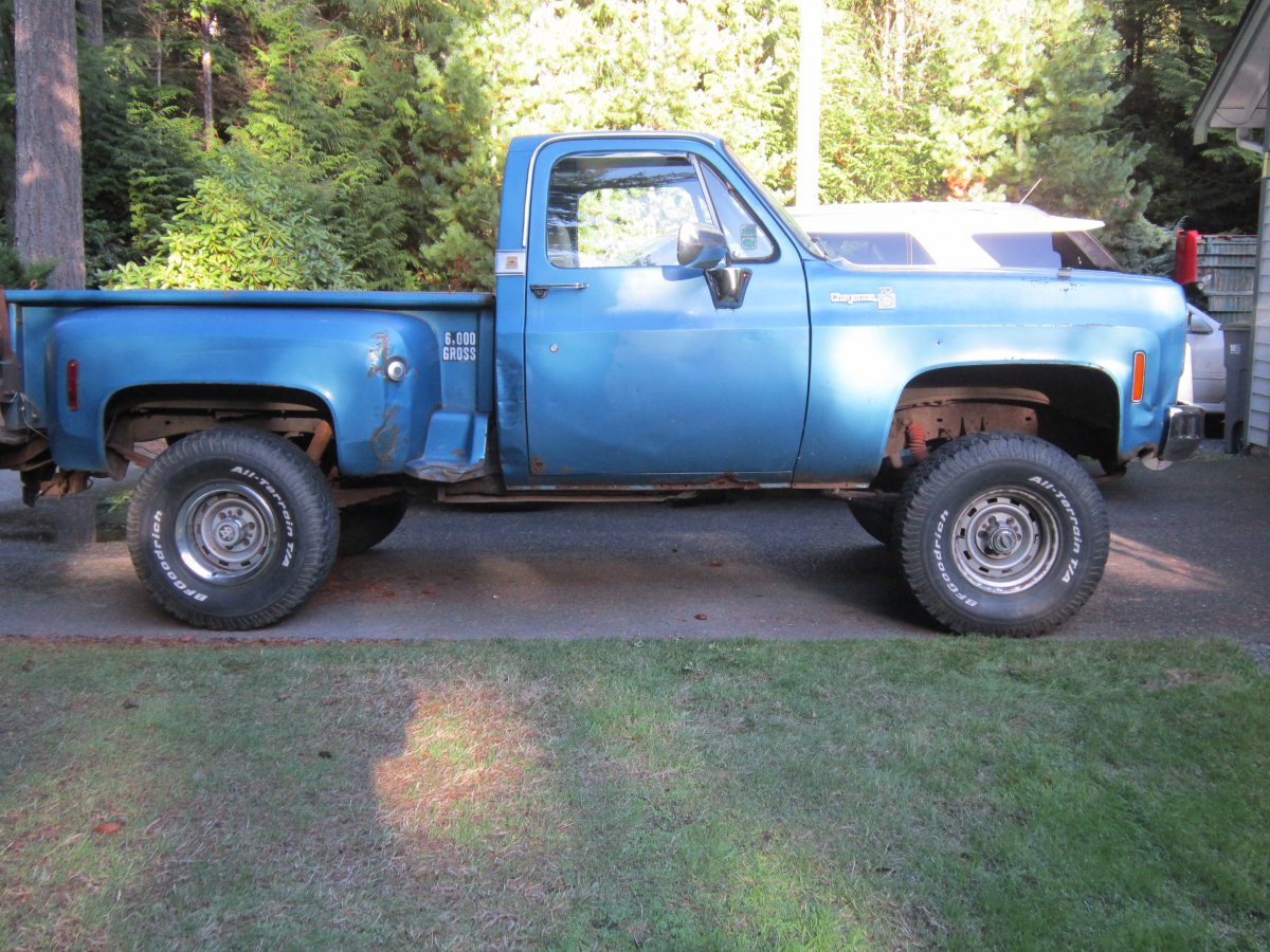

Bought an old K10 stepside because I missed wheelin'. Wished I didn't get rid of it last year but c'est la vie. BTW, don't hate I like Ford and Chevy, but not Dodge too many rattles. LOL

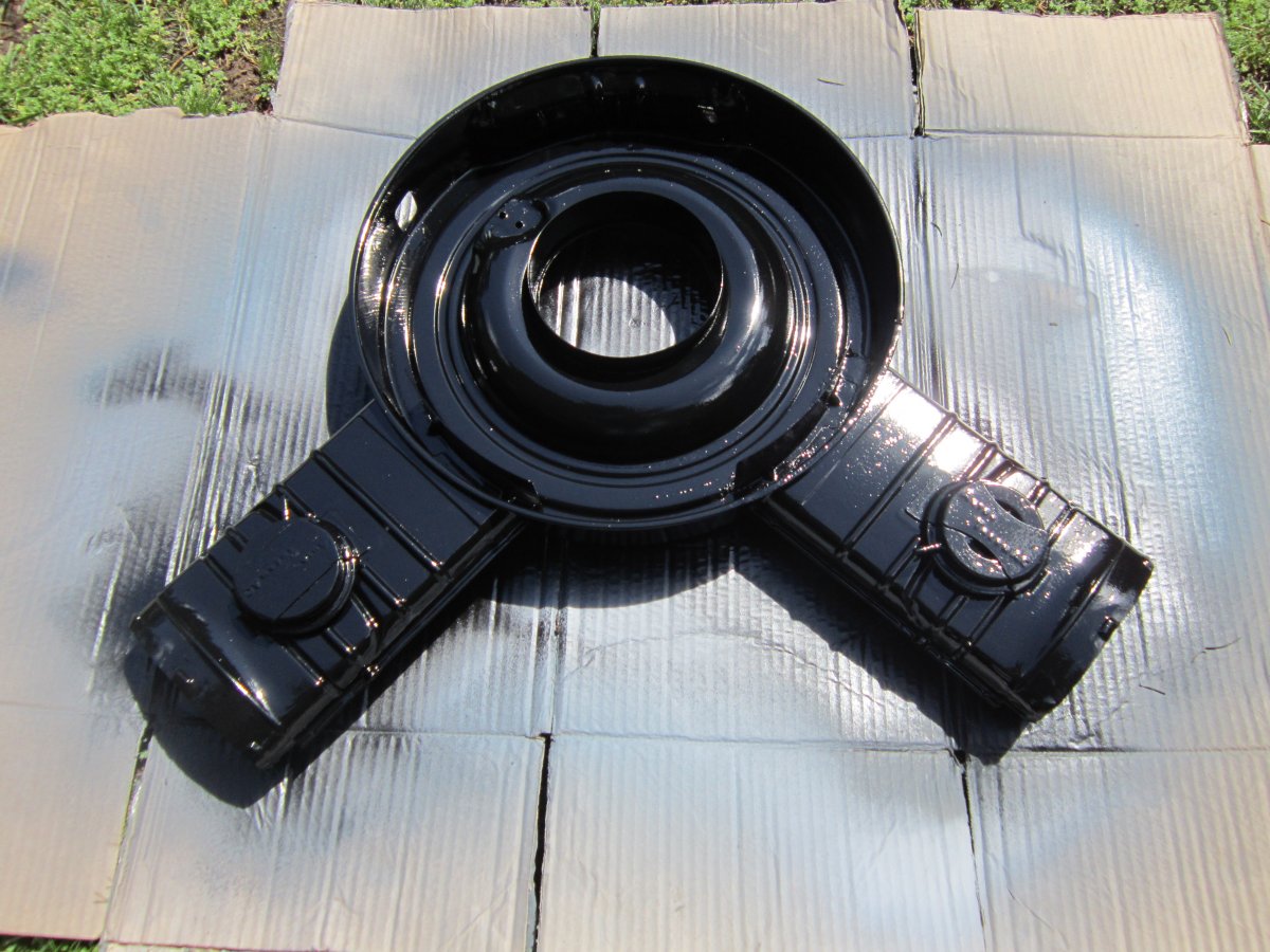

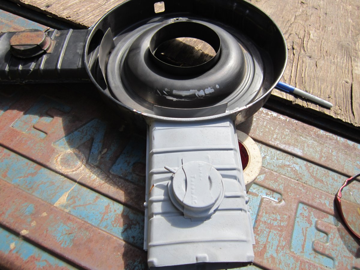

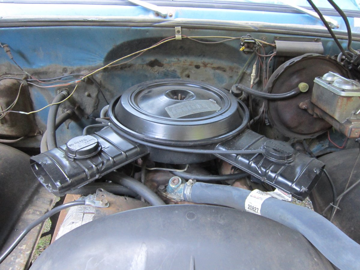

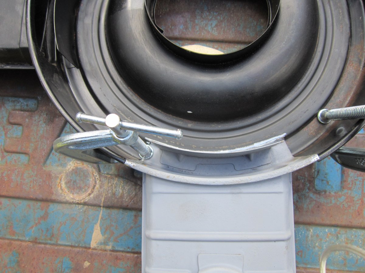

Made a dual air intake for the Chevy...
56071
56072
56073
56078

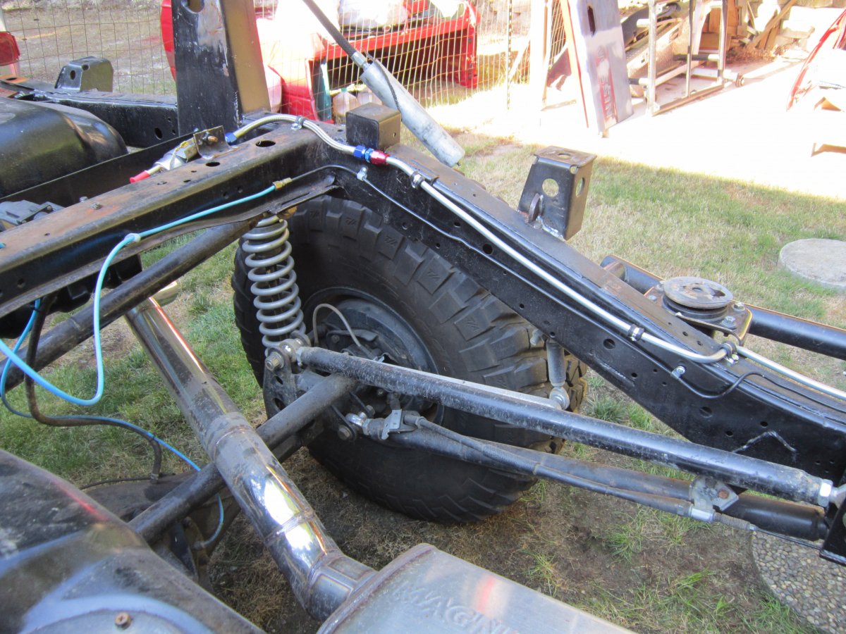

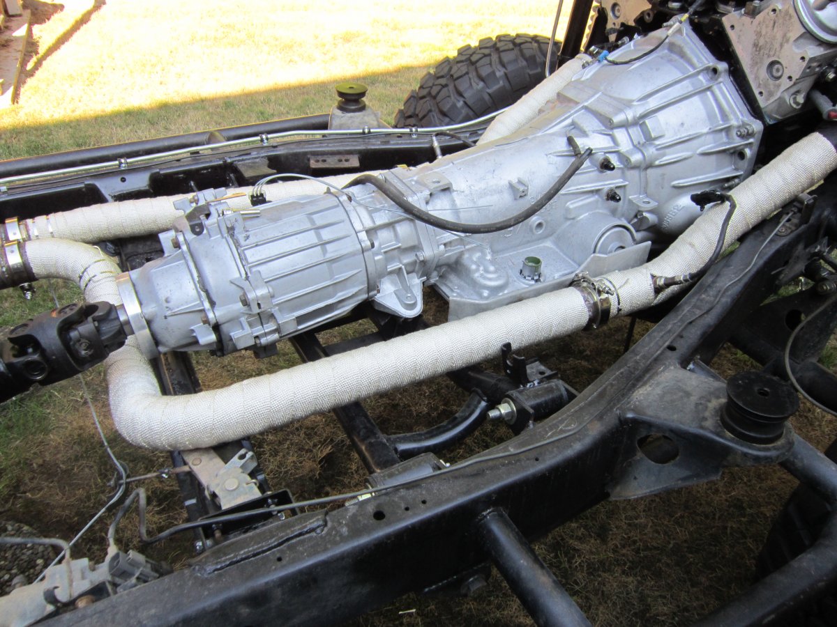

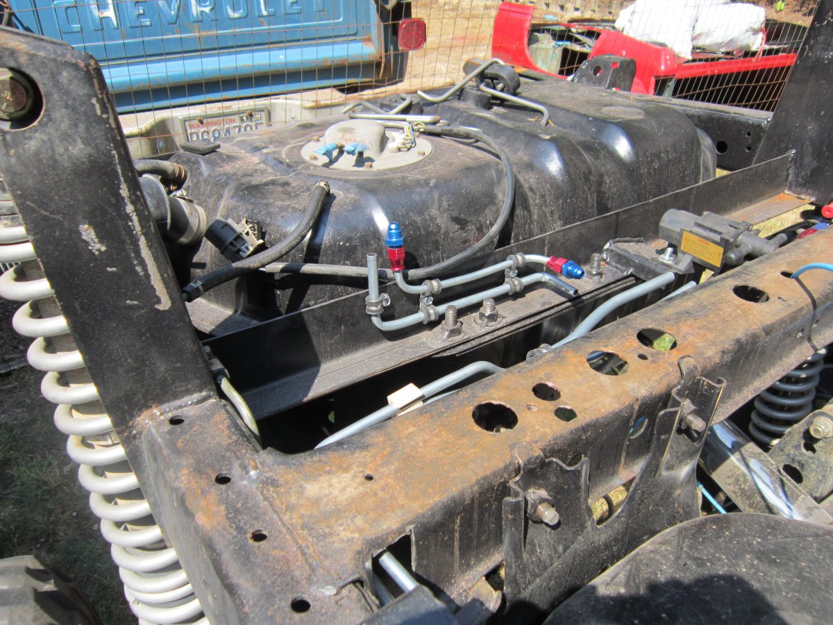

Cleaned up the frame, routed fuel lines...
56079
56080
56081

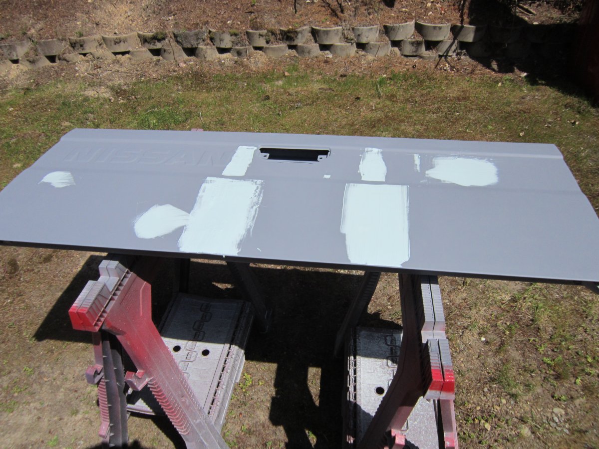

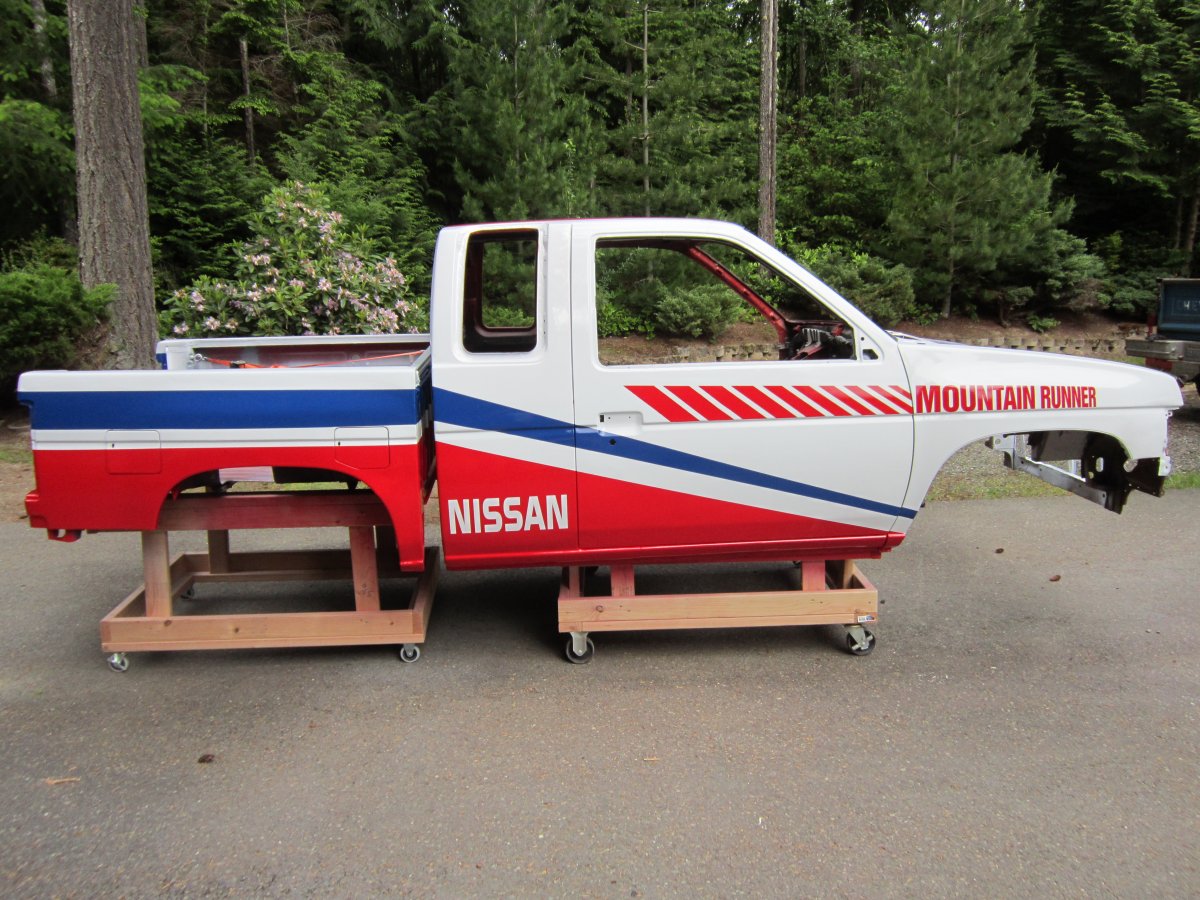

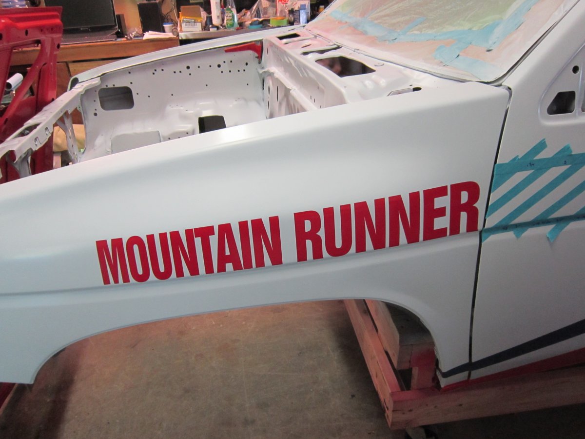

Painting the body...
56082
56083
56084
56085
56086

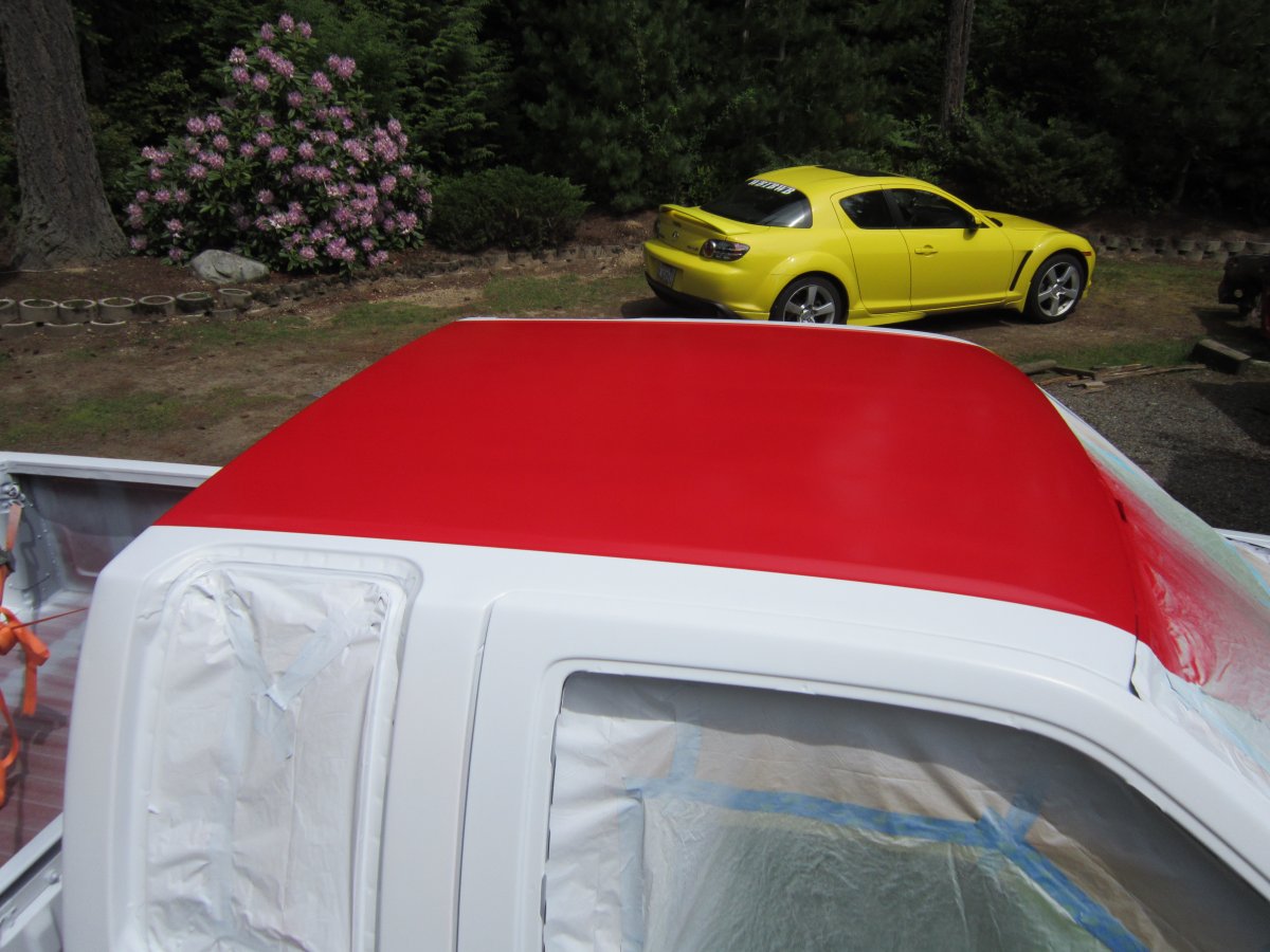

added next color...
56087
56088
56089
and 1st newbie mistake, forgot to spray inside the gas doors...
56090
56091
56092
Stickers...
56093
and finally 3 coats of clear....
56094
56095
Since I painted it outside, apparently clear coat is sweet and gnats like it. 2 gnats lost their lives for my truck. I guess its kind of like amber, in 10,000 years the clear coat will be worth money. :D
More fuel lines...

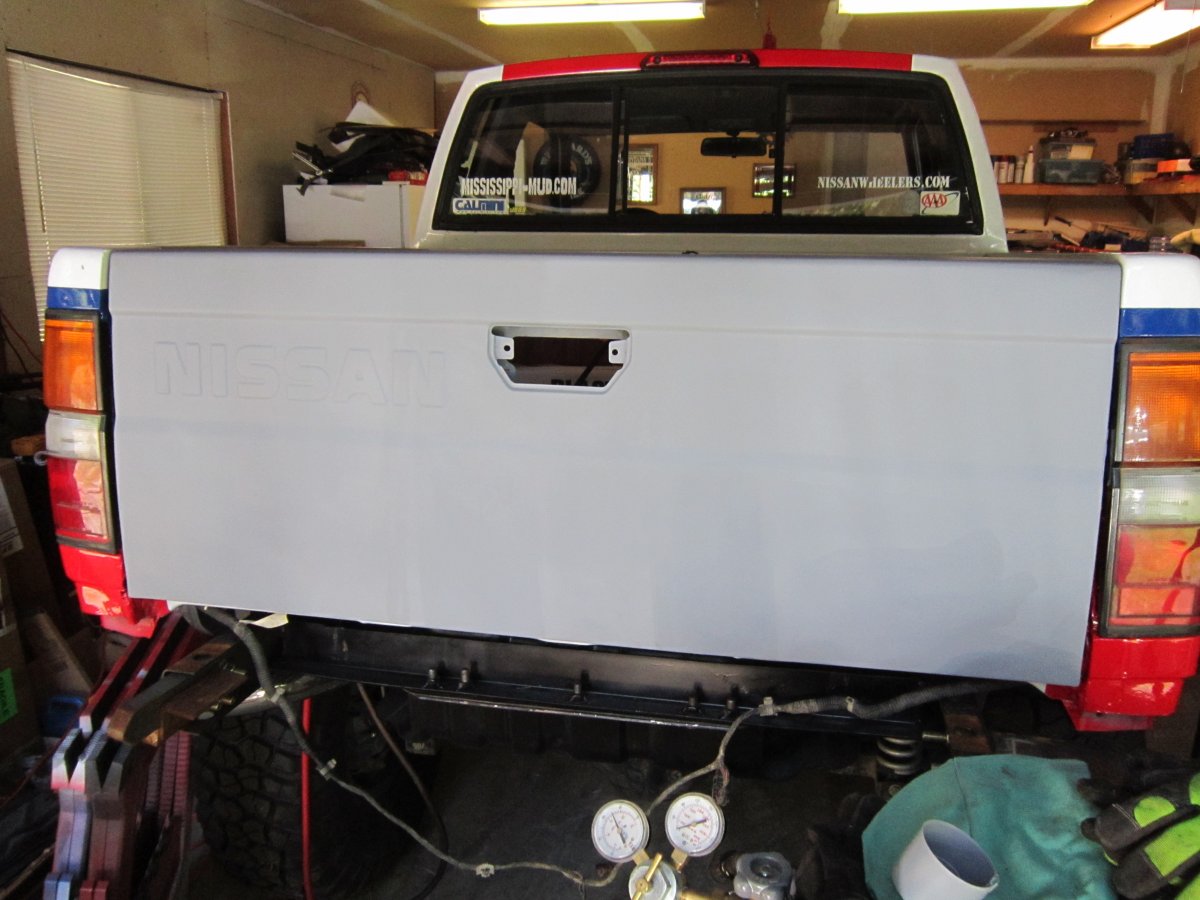

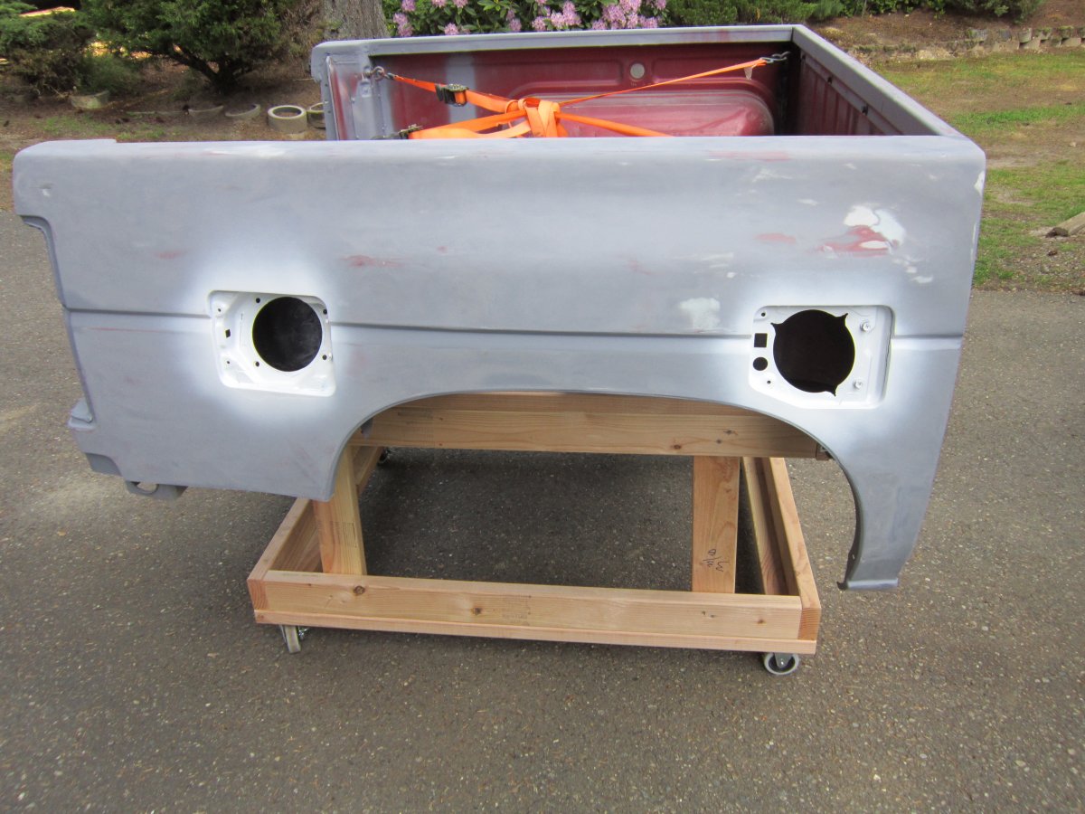

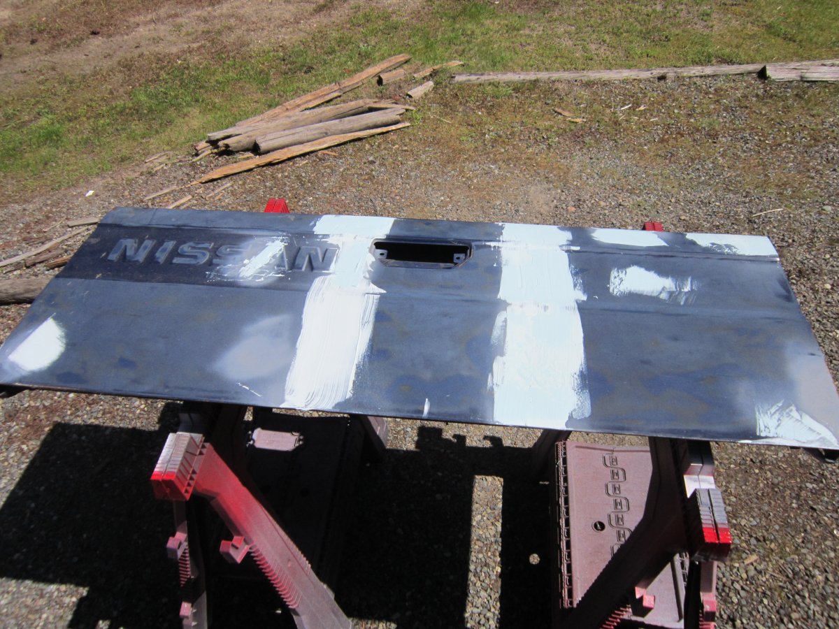

Narrowed the tailgate to fit the pathfinder fenders on the bed...
56104
56105
56106

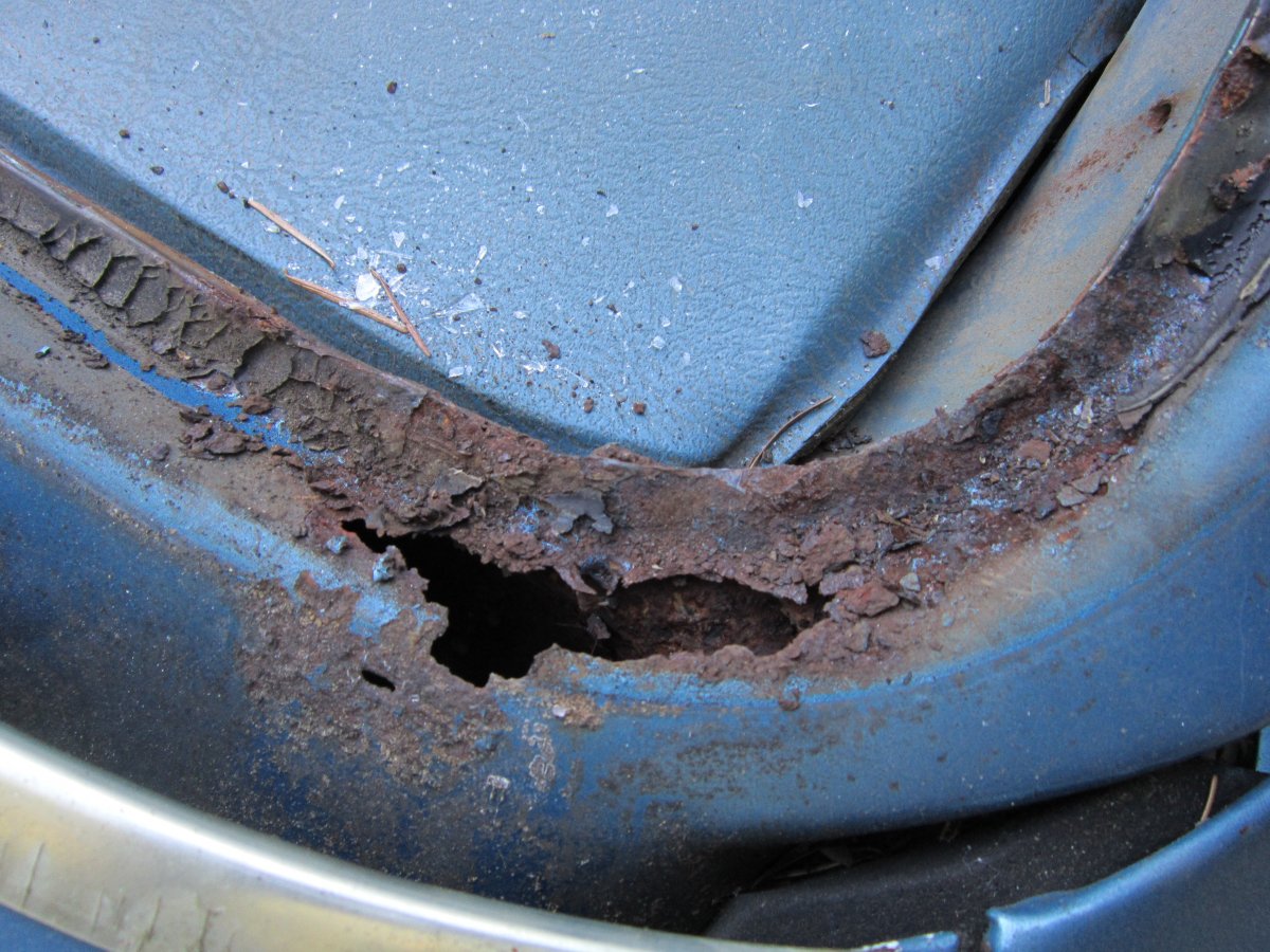

Went to replace the cracked windshield on the K10 and found this... both bottom corners...
56107

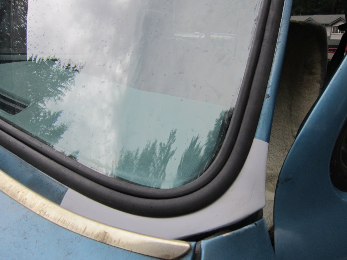

went to the junkyard and cut them out. No replacements online...

that paint job is sweet. old school nissan paint scheme
well, the whole thing is but my favorite part is the paint
