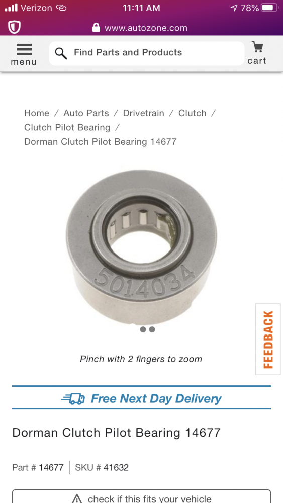

maybe you “threw it out”. ironic, huh?
and you know, racsan, that may well have been what happened !! i did say i felt an idiot ! this one is basically it, though i couldn't find it on the site, i did call our autozone store and they are holding one for me so i can come in and check it with my calipers for fit.... i take it there must be a number of them, all according to what particular tranny you have.... will let you know if it's a good fit...... i've already gotten the bearing part itself but still need the bushing; don't mind getting it all again if it will fit ! thanks for the research and the link.... much appreciated...
to all..... i ended up at our ford dealership (i'm in a town of 4,000) and amazingly enough they still had the part listing, though it took a while to find it, and they had one in stock !! the dorman one was too large of an od for the flywheel... what did fit was ford part # F5TZ-6K389-AA (1031445) ... a german made solid metal bushing... the needle bearing fits inside it.... and different ones for a mazda and a mitsubishi trans... i thank you both for your input and help.. i've had this truck for ten years and would really like it get it working so i can go up in the mountains behind where i live (bishop, ca)... i can go from 4,000 ft to 11,000 in less than twenty miles; some great roads.. used to do it on a 73 yamaha 175 but that was a few years back and i'm turning 70 and would love a 'more comfortable' means of travel to do so.... again guys, thanks..... ever have a construction question, let me know.. 35 yrs ..teacher and general contractor...
