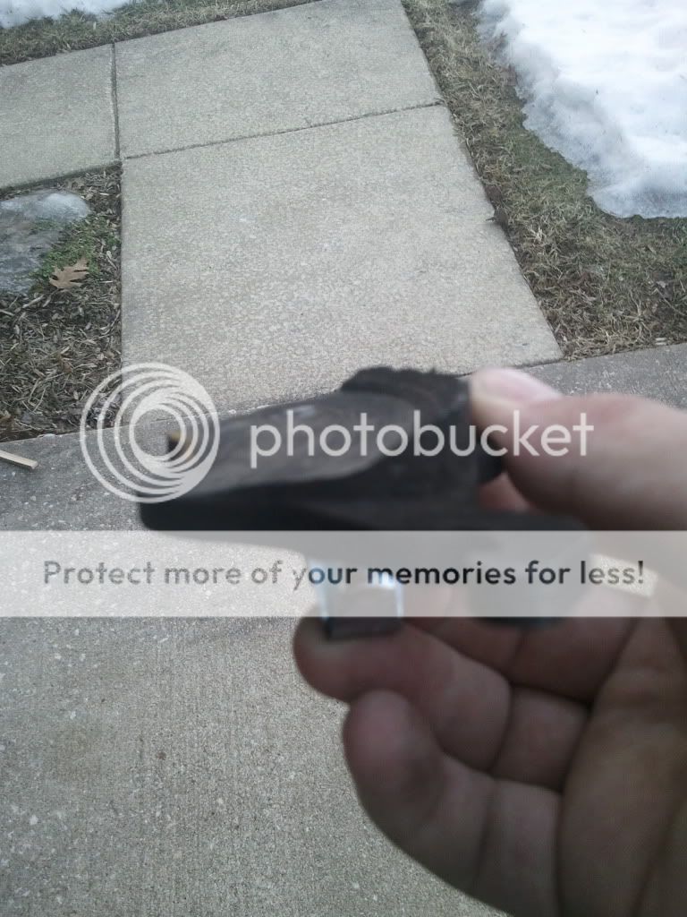

So I had to work on my Buddy's 2000 Focus this weekend because the brakes were grinding. It turns out the calipers have a pretty poor design. They built the caliper bigger than the pads and then just held the pads in place with some spring clip thingies. Why they didn't just build the caliper to fit the pads perfectly is beyond me.
So we've been having a lot of snow here the last couple months and it seems some snow got inside the wheel and knocked the pad out of place and he just drove on it all winter without realizing it, until now.
This pad came off the inside of the driver side caliper.
That side of the rotor was almost completely worn down to the inner ribs. I'll post pics of the caliper tomorrow after work.

The clips are *supposed* to grip the bore of the puck tight enough to pull the pad back off the rotor when the brake pedal is released, as opposed to just having them float free in the caliper.
I've never seen one do that before - at least to that extent, and I've worked on a LOT of brakes in my 50 years. Are you sure those are the correct pads?

The rotor was completely shot so I replaced that along with the pads. Yes I'm sure I had the correct pads, and the clips/spring type things come attached to the pads when you buy them.
I didn't replace the caliper but if this turns into a reoccurring problem it's my next step.

The phenolic piston in the caliper can get a little cocked in the cylinder causing the pads to wear according. Steel pistons last longer it could be the last time the brakes were done the rotors were not replaced or turned causing the pads to wear uneven along with the piston in the caliper.

i agree topher, its a poor design that leaves the door open for a failure such as the one you have...... but after looking at your pic and a pic of the pads on my shelf, how exactly did the inner pad get enough clearance to disengage the piston clip and allow it to be pushed to the top of the caliper? the few failures i have seen have all occured with the outer pad, when the steel wire clip comes loose from the cast nibs on the caliper(these cases may have just been improper install of the clips on the nibs). as for the plastic plugs that keep the crap out of the mounting bolts, i believe those are a 1 time part as i havent seen them listed in the aftermarket parts industry, but the dealer may be able to order them, in say a bag of 10-100?

The outer clip was cracked but still seated. I think the piston clip was bent somehow, I'll check it next time I'm in the garage.
