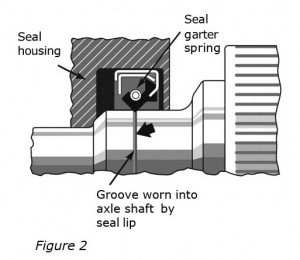

I've seen rear axle repair kits that the lip of the seal rides on a different portion of the axle shaft than the factory seal did. This is used for axle shafts that have a groove cut in to them from the original axle seal, and are leaking oil.. I've also seen them include a very thin sleeve that gets installed on the axle shaft, to cover the groove that was cut in to the axle shaft.
While this diagram isn't specifically for the Ford 7.5" or 8.8" axle, it shows what I'm talking about well enough..
Assembly order..
8.8inch.jpg%20alt=
This image shows a typical "repair bearing" - which moves the contact path of the bearing's rollers and the seals contact patch on the axle shaft.
Take note of 2:45 in this video from SKF, which is a bearing manufacturer...

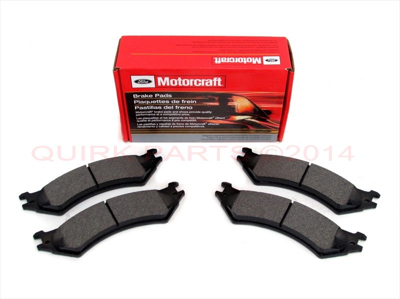

I once heard one guy cussing up a storm, throwing tools, and hollering from the back of the shop over a brand new stripped exhaust bolt his apprentice had just installed, allegedly by hand. The threads were burned off of it, like you get when you just run it in with an impact gun and don't start a thread first.
Same kid installed these brake shoes backwards:
25476
I don't mean he put the backers facing the rotor. He installed them with the side facing the box towards the hat of the rotor. We do not know how.
