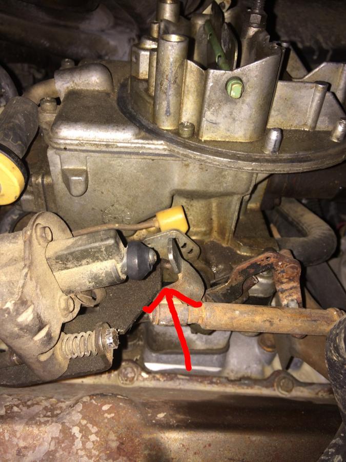

Lately my truck has had a really low idle when starting. To the point where I have to feather the throttle to keep it running. Once the engine is at operating temperature it runs fine. So I've been trying to adjust the idle and noticed that the sensor that usually touches the throttle cable isn't extended out. I couldn't even pull it out with my hand.
What the actual name of this sensor?

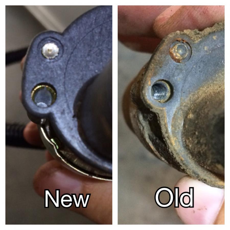

Well I'm kinda stumped at the moment. I bought a new idle control motor off amazon and when I hooked it up the nipple did not come out when the truck was started or when the a/c was on.
The part does have a sticker that says made in Mexico and oddly enough the the bolt holes on the mechanism were not threaded!?
Could it be defective? What else is there to trouble shoot? Fuses etc?

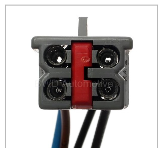

I just checked a spare I have, and the holes aren't threaded either. The bolt will cut threads when the part is installed. The black and red wires control the extension of the motor, the other two are for the sensor. It would be a good idea to do an eec quick test and pinpoint test to see what's going on.

When looking at the female plug from the computer end, I used my test light and it shows power in the top left port when the ac is on. The bottom left seems to be a ground. I have no idea what the two right ports are for and what triggers them to come on?
