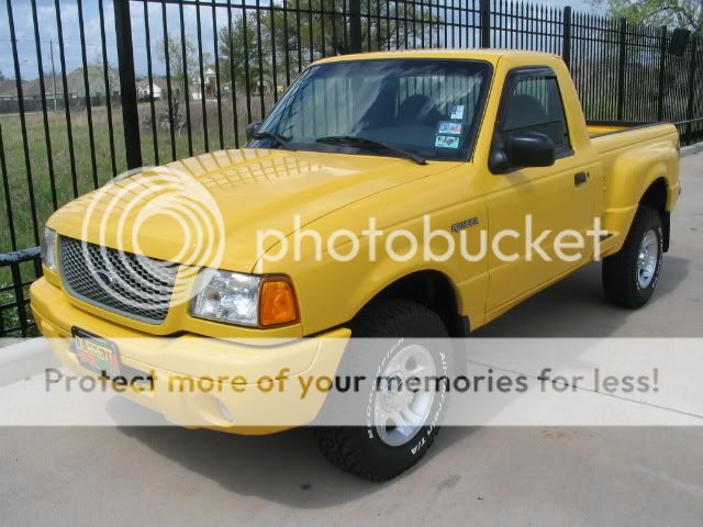

i have an 01 ranger 5 speed v6 3.0 i have 28 in bfgoodrich allterrains on it right now but i want some mud terrains .. .whats probly the biggest tire i could put on it ...
