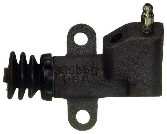

I used this style:
Whats the best slave cylinder?

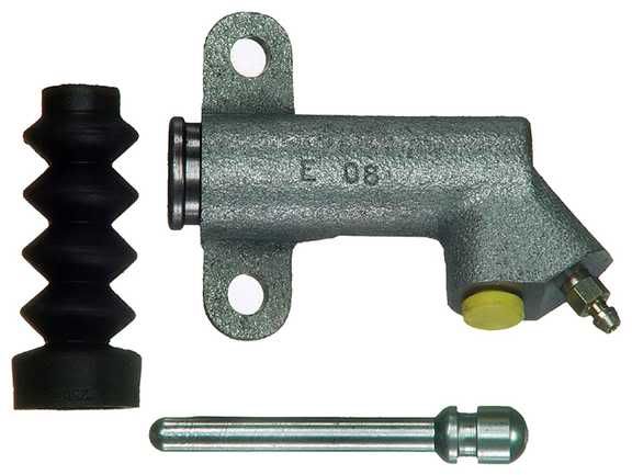

But this one works just as well AND is much easier to work with than what I used
It's a little harder to push down on the clutch pedal, but it does release and let go of the clutch 100%
Most of those Nissan/Datsun models are pretty interchangeable. Just pick and car from the 70's to early 80's, they all used them.

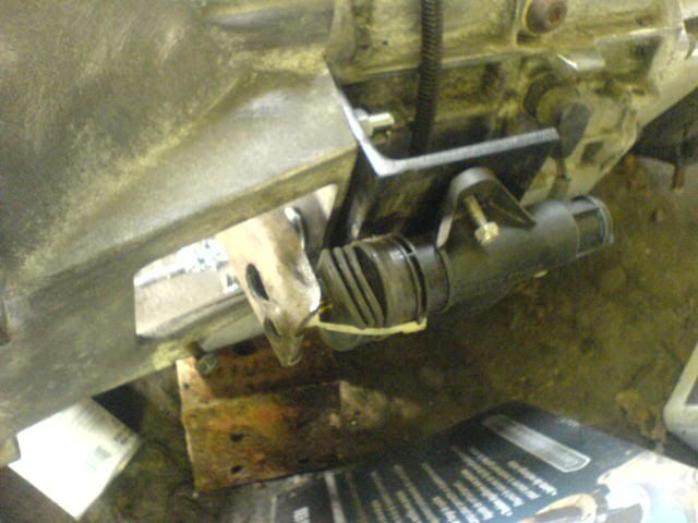

I used a slave form an '83/'84 ranger diesel. Gotta keep it Ford!
Mock up:
^^ Those are from a Ford Probe. :D
