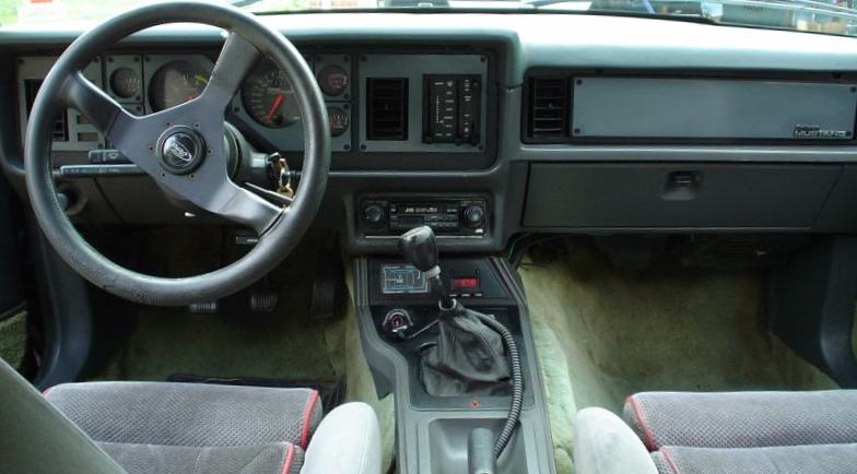

Anyone have a pic of an 86 dash, and an 87 dash? Wondering what the difference is. Is it just in the gauges?

Here's an 86 GT which is pretty much the same dash that came in the 78 Fairmont.
Here's the 87-93 dash. The only difference I can think of is the pony on the dash. The 87 and 88's did not have one, and the 89's had one that said "25 years". Then 90-93 was just the pony.
EDIT: Also, the 90-93's had an airbag in the steering wheel. And, only in 1990 did they not have the jockey box in the center console. For some reason Ford removed in in 90, then put it back in 91. Lot's of people who have a 90 buy one and put it in though.
