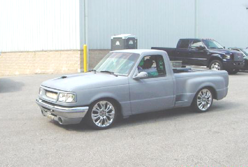

drop springs and beams flipped blocked rear end and notched...ma809 air shocks from Monroe and removed swaybars in rear...broke swaybar bracket up front due to extreme prssures(i reckon ???) the speaker box, 2 extra bats, 2 amps, and 2 subs weight it down another inch...so i have a 6/9 drop..i also have spring compressers on the front b/c the rear was too low...I tuck the side walls of my 225/45 R18s with MB Gunner 5 off road Wheels from Direct Discount Tires... I'd bag it but i would have to redo my bed for the bridge bars.
I've also replaced the Tranny Xmember and Radius Arms with low pro ones from SuicideDoors.com b/c the speed mountains at work were doing a number on them.
It would be aligned if i took it to a shop but it's a waste of time unless i replace the tires. (i've had them for 1.5 years now and put probably 40,000 on them) luckily i rotate and have them flipped on the wheel ever now and again so they have lots of wear left yet. Here my PS pic and a reg pic...I still need to finish my body kit from stillen also.

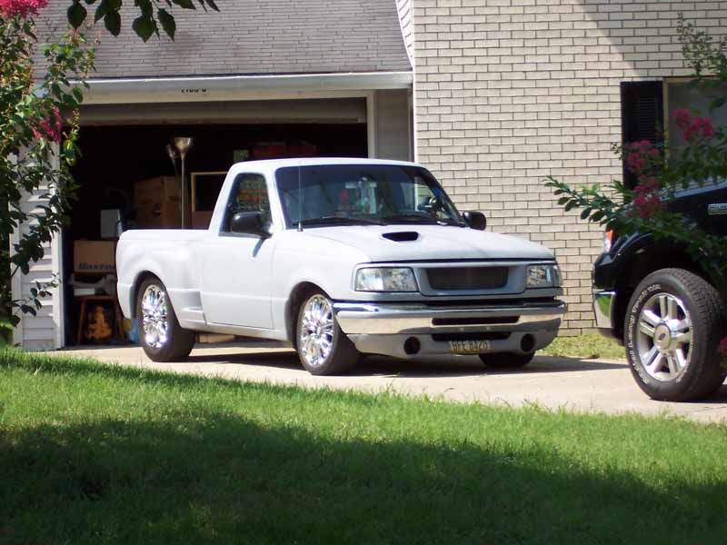

97 xlt
i never measured it before i started on it so idk how much it dropped.
djm dream beams
2in coils
flip kit
2in. blocks
full shave
92 caddy tail lights
svo scoop
cut grille
angled plate in gate
89 prelude seats
dyed int black
tv/dvd/ps1
custom console/sub box
