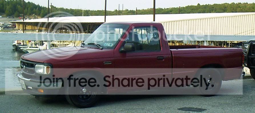

'96 Mazda B2300
full Belltech kit
5in front 5.5in rear
3in from the I beams
2in from the front springs
flip kit and small blocks in rear
nitro drop shocks
15in wheels w/ 205/65's
... love the setup, but even with the smaller tires i still managed to rub holes in the plastic inner fender liner on big bumps and dips on the highway... I knew what I was getting into though:headbang:
