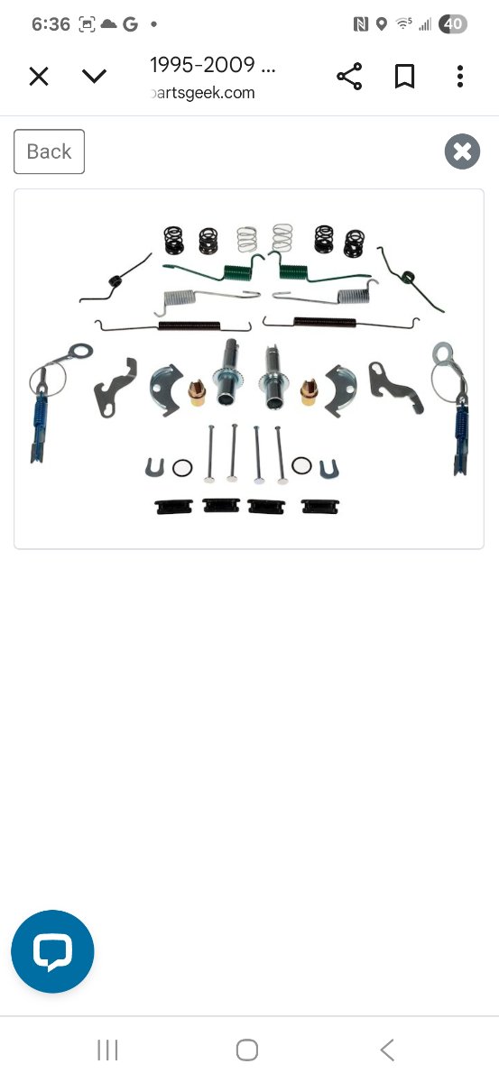

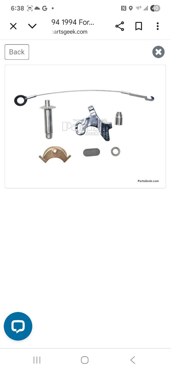

Pretty sure the only thing that changed was the adjuster setup but the shoes are the same no matter the year, but to be safe, just pick a year and ask for that
The later model shoes have a pin for the adjuster lever. The early model shoes have a hole for the lever. So I believe the shoes are different. Not sure of the year break for the change.
As long as you buy the same year shoes as your self adjusters... you should be ok. Seems I did that in the past... used late model shoes and adjusters on earlier backing plates.
I just had to look cause I've seen this before. Looks like it changed in 95.
I was working on a 94 (I flipped a few back in the day) but had later model shoes and hardware. I'm like 99% sure I put later model parts on the earlier backing plates without issue.
