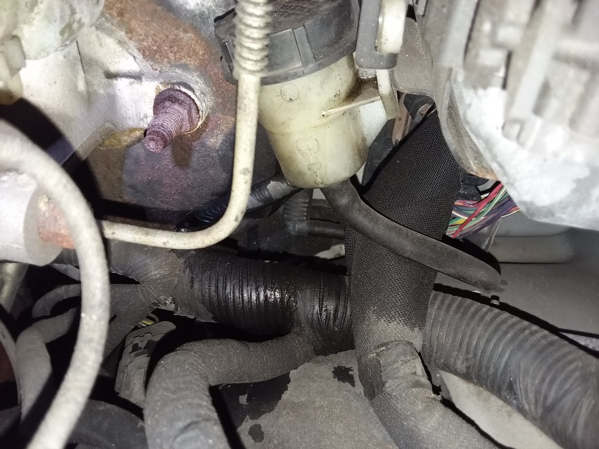

Alright, I'm about to bleed it but looking around down there I couldn't quite spot the master cylinder in case that's what needs to be replaced. See pic. Following the tube from the fluid reservoir is it attached to that elbow deep down there behind the brake master cylinder? If so how do I get in there. My book provides no pics and doesn't indicate any need to remove anything to access it. Says there are no bolts fortunately for my year truck tho. Anyone know?

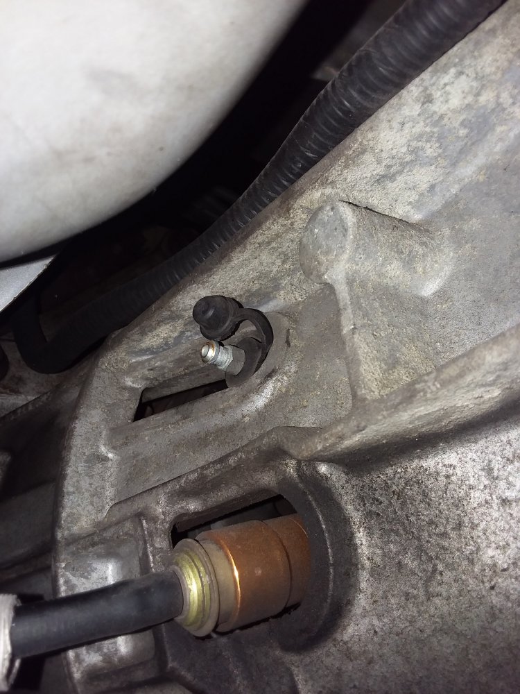

This is it right? Bleeder valve and fluid line port? It's at the wide end of the bell housing, driver's side. There is no sign of leakage here so hopefully that means slave cylinder is good.

Look towards the front of the transmission where it attaches to the engine. If the slave is leaking the fluid flows to the lowest part of the bell housing.

The white plastic with black cap is the master. Remove the black cap and there should be a rubber diaphragm stuck to the cap. If it isn't there then it may have been sucked down into the master. First time I looked at one of these systems I didn't know about the rubber piece and filled it up with fluid not realizing that it wasn't supposed to be part of the master. It took me a few days to figure out why there was no fluid getting to the slave....lol.
Okay, so the reservoir is the there at top and the cylinder is back there. Gonna look up parts to get a better idea. I'm trying to bleed it but not sure what's going on.

Sorry, I mislabeled things. The white plastic with black top is a remote reservoir for the clutch master. Joshb pointed out the master is attached to the clutch pedal rod on the front of the firewall.
