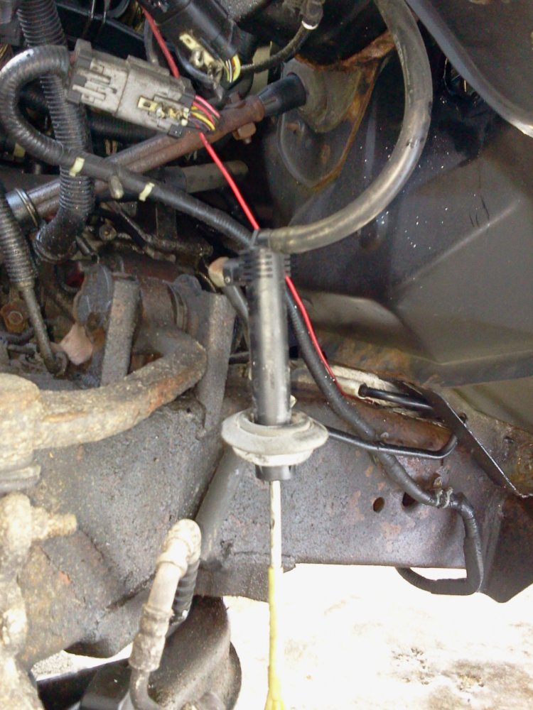

this is my 2005 2wd.

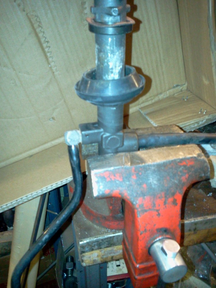

you can pull the fender liner, remove the MC, invert and bleed it.

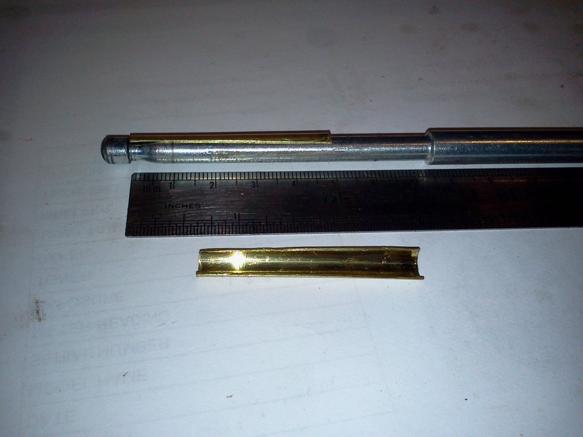

a piece of 1/4 brass tubing will open the tangs to allow pushrod removal.
MC in its installed position, the inlet and outlet are at the bottom.
you are not getting the trapped air out until it's inverted.

Thanks. Good tips. I didn't totally invert mind but mostly bled it. Planning on using my vac bleeder next. Should that be able to force out any stuck bubbles you think?
I think I actually totally bled the MC because before I plugged the line back in the slave the pedal didn't move. So I'll standard bleed again with the hand vac bleeder. Already did it with regular bleeder but maybe just not enough. Maybe it's good. Idk. It feels like it has a lot of free play but maybe I forgot how it felt before. Feels like 2.5 inches of play til it hits pressure. Maybe that's a pedal mechanical adjust. Idk. I'll check that out in the book later. Seems to shift fine though
