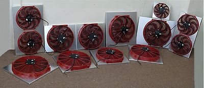

Wanting to by the Champion Cooling fan. Comes with installation kit. Fans shown are 10, 12, 14 an 16 inch.

I had one of their 16 inch fans on my ranger and it just kept up with the cooling. I would not go any smaller. I used the "wire ties" through the fins kit that comes with the fan and never had any problems with that mounting method.
Biggest one that will fit. Also mind the CFMS. Not all of the same size have the same CFMs. Get one that has a lot.
