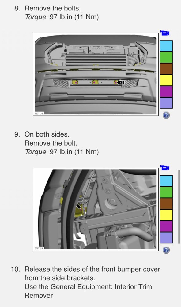

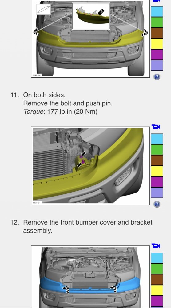

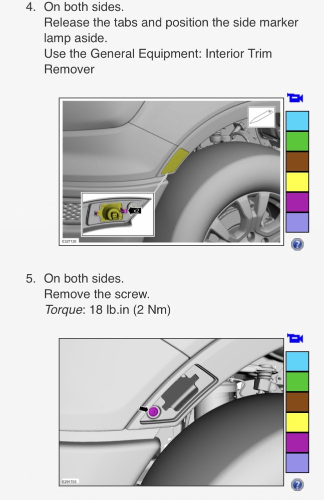

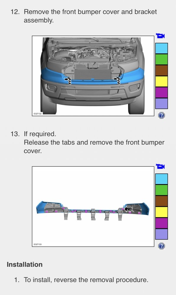

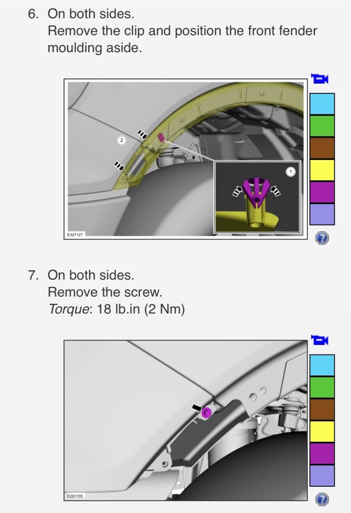

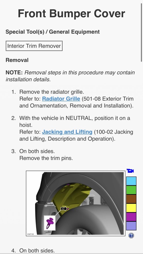

@snoranger posted page after page of what Ford has named the "Front Bumper Cover"
Ford makes the part.... Ford gets to name the part... Right?
It's a Front Bumper Cover
