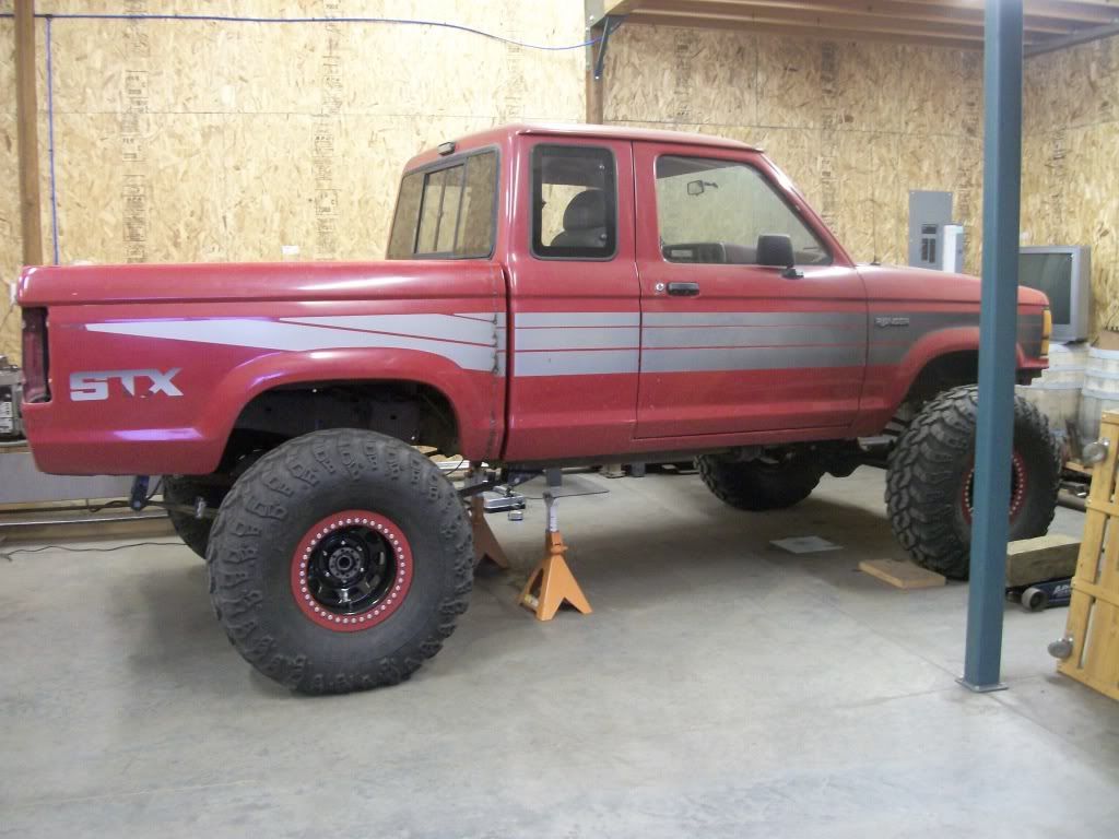

On our build, we're bobbing the bed on an extra cab. It's origonally around 125" or so. Right now it's about 115". Still a bit longer than a stock Toyota, and about 5 inches longer than a couple of our friends' Toyota wheelers.
Here is the current progess on the double bobbed bed and the rest of the truck: :icon_welder: Still need to bob the back half of the bed.

Jesus, I thought mine at 117 looked tiny, what size tires are those ?
