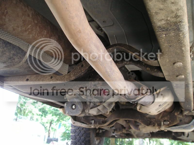

Back to the tailpipe idea.... below is a pic of what you could do with a single pipe. It's my current setup(cut stock flange replaced with 2.5 3-bolt then 2.5" into a 3" in/dual 2.5" out Super44 and 2.25" tailpipes dumped at the spare carrier). I had no actual location for an outside exit like stock or aftermarket offerings due to the shackle and hitch. So I dumped it and i'm very very pleased with the results.

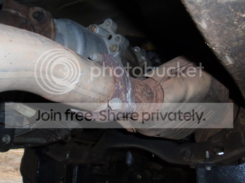

The stock flange.... Goes 2.5" behind the cat, then the flange, then it steps down to 2"....
I had my shop ditch the stock flange and replace it with a 2.5" 3-bolt flange to eliminate that stupid step down then step up....
Any exhaust shop should be able to handle that with ease. All it takes are 2 flanges and a gasket. No adaptor or anything. Plus, you SHOULD have it removable just like stock just in case you gotta drop the trans or replace cats or whatever.
