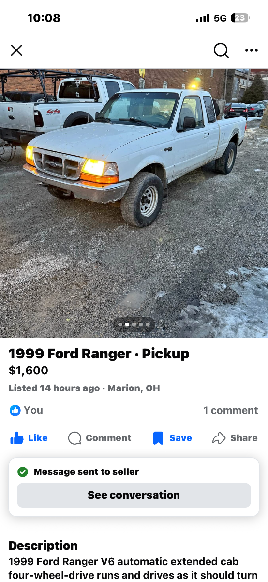

Went & looked at a ranger. White ‘99 supercab 4x4, 3.0/auto. 4.10’s front hubs have been upgraded to manual. not too rusty, Id be more worried about the transmission than anything with 190K on it. $1600. drivers door has been changed, has a ‘97 sticker on it but correct tag for truck is on the doorjamb. Might drive it, not crazy about white but thats easy enough to change.

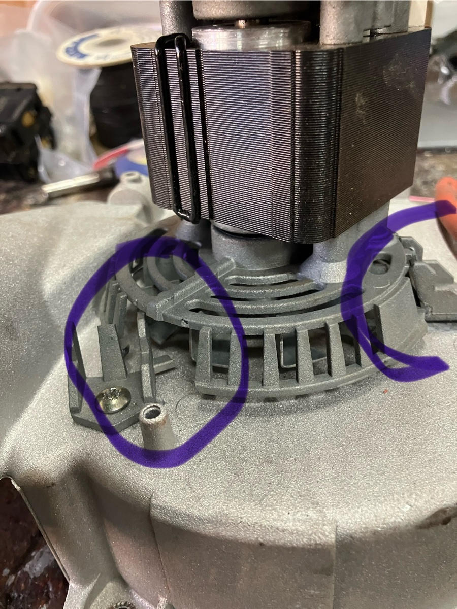

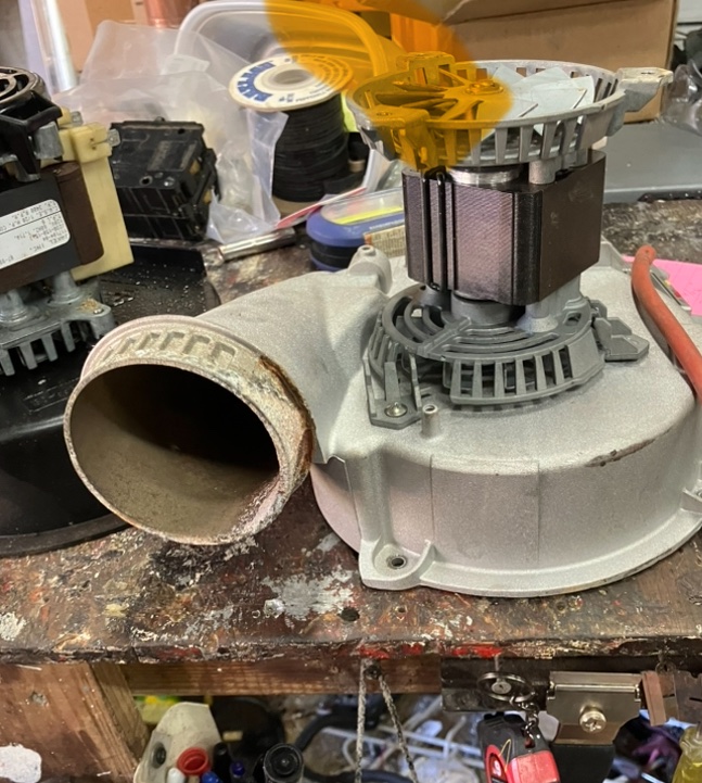

I have an upstairs HVAC system and a downstairs HVAC system. Both start with a little blower purging the gas chamber, so fugitive gas won’t blow up, and when it’s clear, it shoots the main gas into the thing.
Well, a few days ago, when it was like 14° down here at night, that little starter blower had a little roar to it that you could probably hear out on the street through the vents. I just let it ride since it was still heating the house.
Got up yesterday morning, walked out to the upstairs balcony, and it was 55° in the main part of the house. I guess the little guy gave up. Fortunately, the deep freeze was over. I suited up in the nastiest clothing I have because you have to crawl over the dirt in the crawlspace on your belly to get to it, and I pulled that starter blower.

One of the fins in the 5-6” squirrel cage wheel broke off from old age, that created the imbalance, and then it broke the little pot metal housing that held the motor and blower wheel in place.
Here’s the amazing part. I had to really strain my brain and go into the back left corner of the shed of miracles (that’s the really dark deep hole mostly inhabited by fugitive yard creatures and big Georgia bugs) because I vaguely remembered I had a box with furnace parts.

It looked a little different, but it bolted right up, and the heat is back!

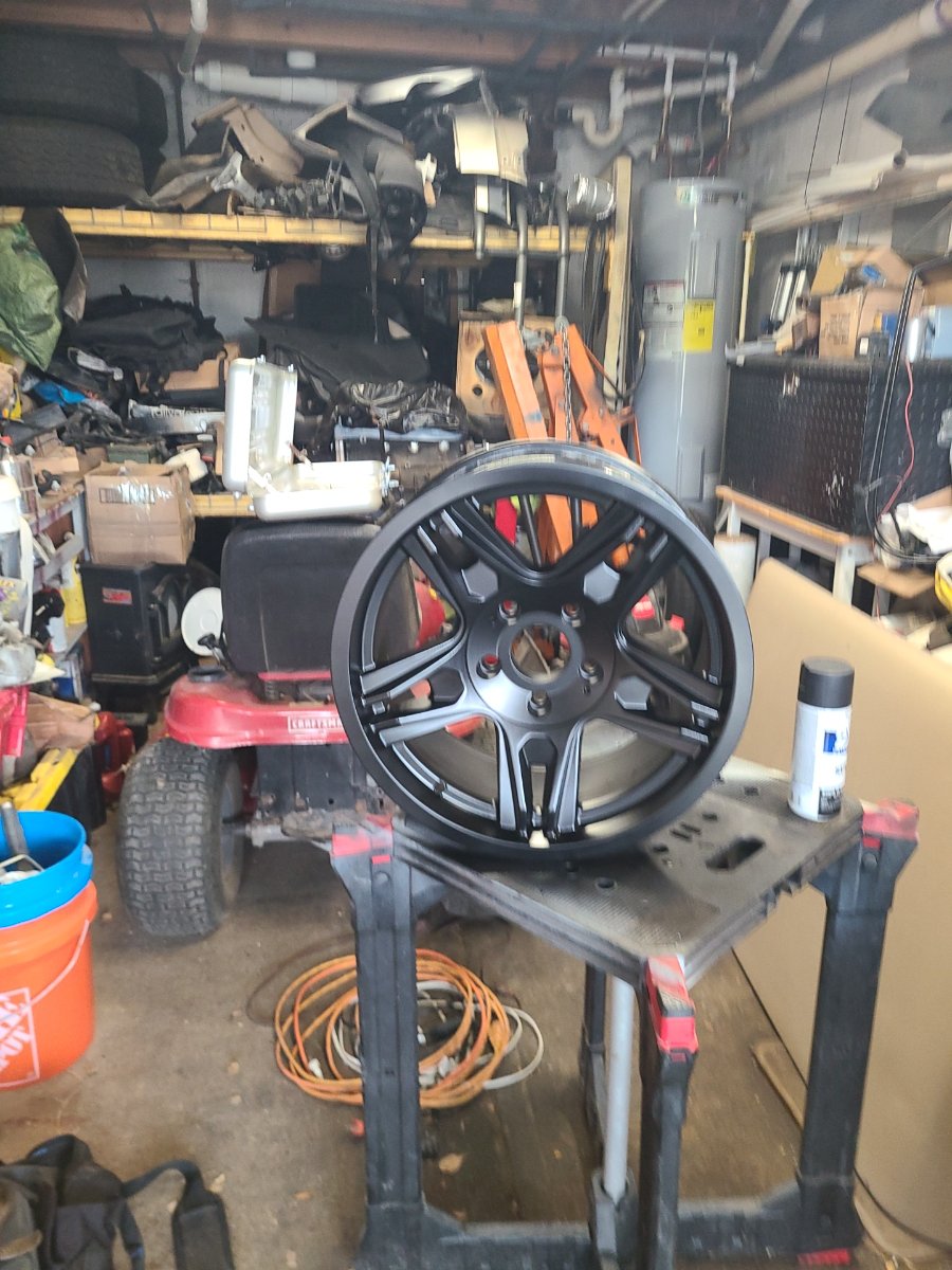

First test paint of the new jeep wheels. 200 bucks for all 5 wheels with center caps. They were just covered in brake dust and no matter what i sprayed and agitated the stuff with it wouldnt come off.
So, wire brushed it off and now trying satin black paint out.

drove the white ranger I was thinking about, passed on it. too many things wrong with it for the money. Speedometer didn’t work, showed 228K miles whenever it was that it quit working, no wipers, barely any brakes, 4wd switch did nothing, when heater did start to put heat out there was a really mousy smell, shifter very hard to move & indicator cable must be broke as it was stuck on “1”. Seems like it should of “had more” in it for having 4.10’s, I realize its a 3.0 but still. Oh well. save more $ up, keep looking.
