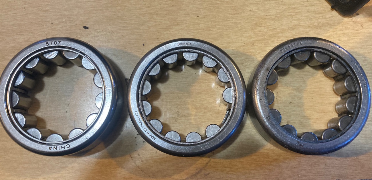

the numbers on the rockauto and autozone bearings match at 5707 but the original bearing says 0?-59722. according to google, these two bearings have the same measurements

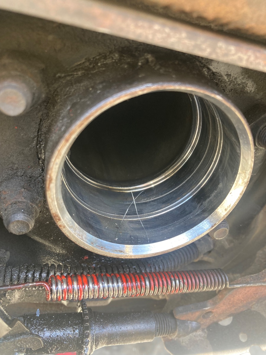

also it looks like i shaved some hairs off the axle-housing/bearing-race. how bad is this?
i have a 36mm socket ready for pounding and the new autozone bearing is in the freezer.

THE BEARING IS IN
sanded down that hair-thin lip and got the bearing in with old bearing as perfect size press, block of wood + big hammer ....then finished tapping in by hammering the big wooden hammer handle in a circle

the numbers on the rockauto and autozone bearings match at 5707 but the original bearing says 0?-59722 or 0?-597SS
*edit*
THE BEARING IS IN
I doubt that you actually scratched the race, and I doubt that you sanded the race out. It’s extremely hard steel. I suspect the mark was residue from whatever ran across it. Then again, the bearings are also extremely hard. But I suspect a mark (think of a magic marker) FROM the bearing, or something on it, not damage to the race.
Now let me talk out of the other side of my mouth. If you actually scratch or crack a race, it’s toast, it’s done, stick a fork in it. The bearing will fail very quickly. But if I already had it back together, I’d also take my chances, but I don’t have to rely on mine for transportation
It’s possible the hardness of the bearing scratched the axle housing. And, me too, I would also sand that down. Then, flush flush flush, with solvent (cheap) or brake cleaner (expensive) to get all the grit out.
And I’m proud that you took my advice on using a wooden dowel. The block of wood, of course, is just, really, a large dowel, one that isn’t round. And the circular motion! My work is done here…

Fortunately, he's not talking about scratches in the race. He's talking about scratches in the axle tube where the race should be located.
lest 'ye all get confused, that's a side load bearing.
variations of it are used in many removable hub bearing units and other things.
