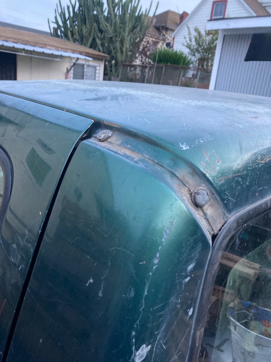

this thing fell off my truck. what is it called and how do i replace it.
its raining right now and probably leaking onto my owners and haynes manuals sitting behind my driver seat. /facepalm

That's just a cover for the back part of the gutter, don't know what it's called but it won't leak because of missing that part, it was just held on by two spots of glue apparently...
those are push pins that go into the cab. that roof corner trim is available on amazon for something like 40 or 50 bucks. mine magically came off when my son borrowed the truck for a few months
^^^ i still have the piece. super glue it back on? add a self tapping screw?

Use a mild nylon scrub brush like you’d use to scrub your nails, and clean out the groove really well. Then use a cloth with some alcohol to just get any possible little bit of grease out of there. Let it dry really well in the sun, or maybe just warm it up with a heat gun. You don’t want to get it hot, you want to run the moisture off.
Then I would use E6000 or Goop (Home Depot), they are the same thing. Two or three spots smaller than a gum drop and place the piece it on there and don’t disturb it for about 30 minutes. Maybe hold it in place with a couple pieces of masking tape. It will fully set in a few hours.
The reason I like the E6000/goop is because if you ever want to take it off, you can wiggle a screwdriver underneath it and it’ll pull loose, but it’ll never pull loose on its own from the wind or from a car wash.
My two cents.

rick W, thank you for the great introduction to E6000. theres a recently opened tube of the stuff in the junk drawer at my apt.

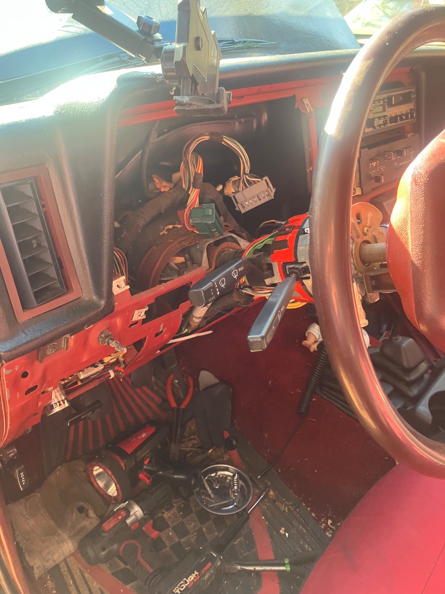

I swapped my front fender-mounted brake light indicators last week, and after I went 5 miles, left went dark. Bad ground, I fixed that.

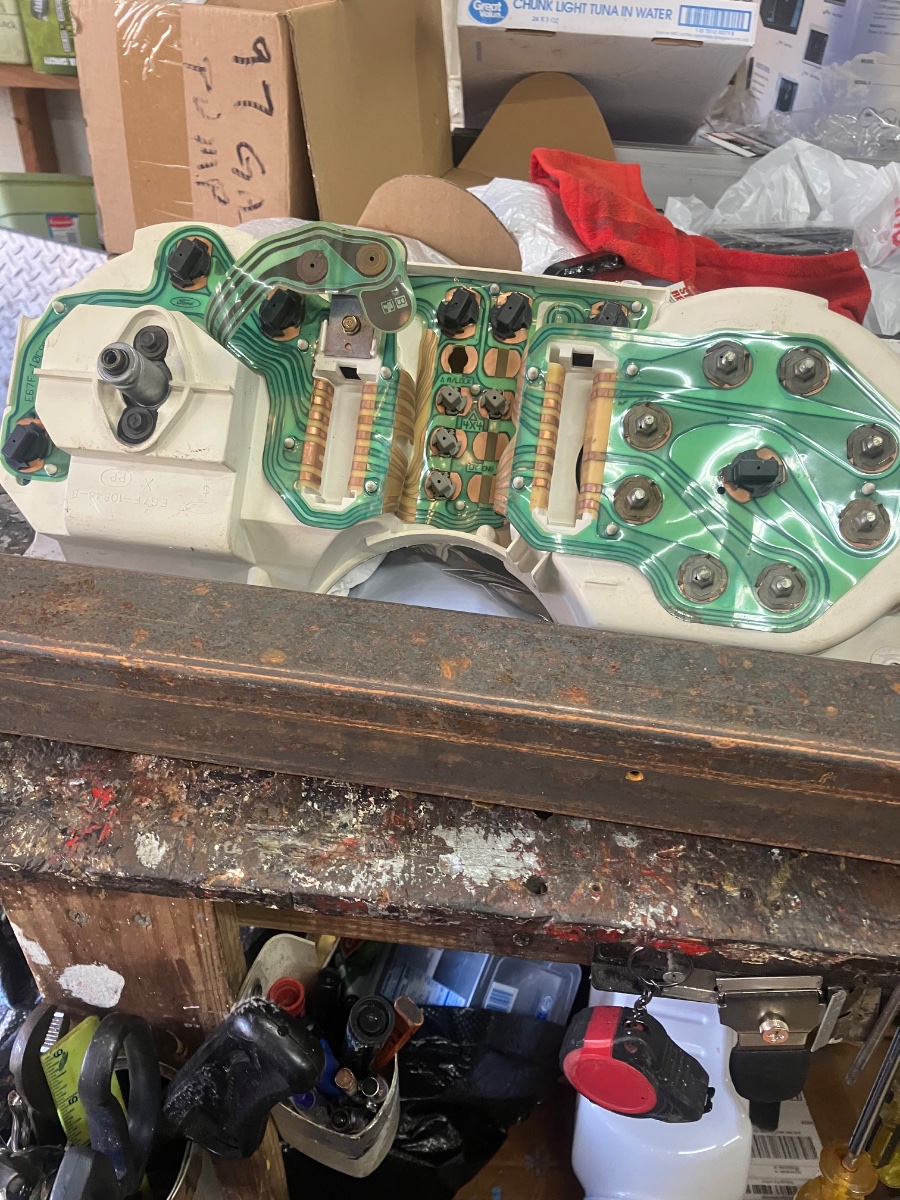

Then I tackled the illumination behind the gauges. Bulb dead, I fixed that. Now the brake indicator, that was working, isn’t working, but I’ll get to that tomorrow. From baking in the sun for 40 years, all that plastic stuff is as brittle as a potato chip.
Then, with the radio working fine, I not-so-wisely said “Gee, I bought those belts for the cassette player a while ago. While the dash is open, let me fix that!“. Yeah, I screwed myself.
I took the radio/cassette out no problem. After I took the slide catch off, and I took the bottom and top covers off, I realized I had to take the face plate out to get to a screw holding the cassette part in place. Well, I don’t know if it was poor design, or it was just 40 years sitting in the sun, but there’s a ribbon 20 circuit connector between the radio and the face plate that’s about 3/4 of an inch long, that’s held on with the breath from a small baby. When I took the face plate down, it pulled loose. There was a clear plastic holder on top of it, and I hoped that if I put it all back in place correctly, it might work. No such luck. Oh, and by the way, there was nothing wrong with the belt on the cassette player, but now the whole thing is toast. And, the sun was going down, and it was getting colder (for Atlanta), and I had a date to watch a movie.

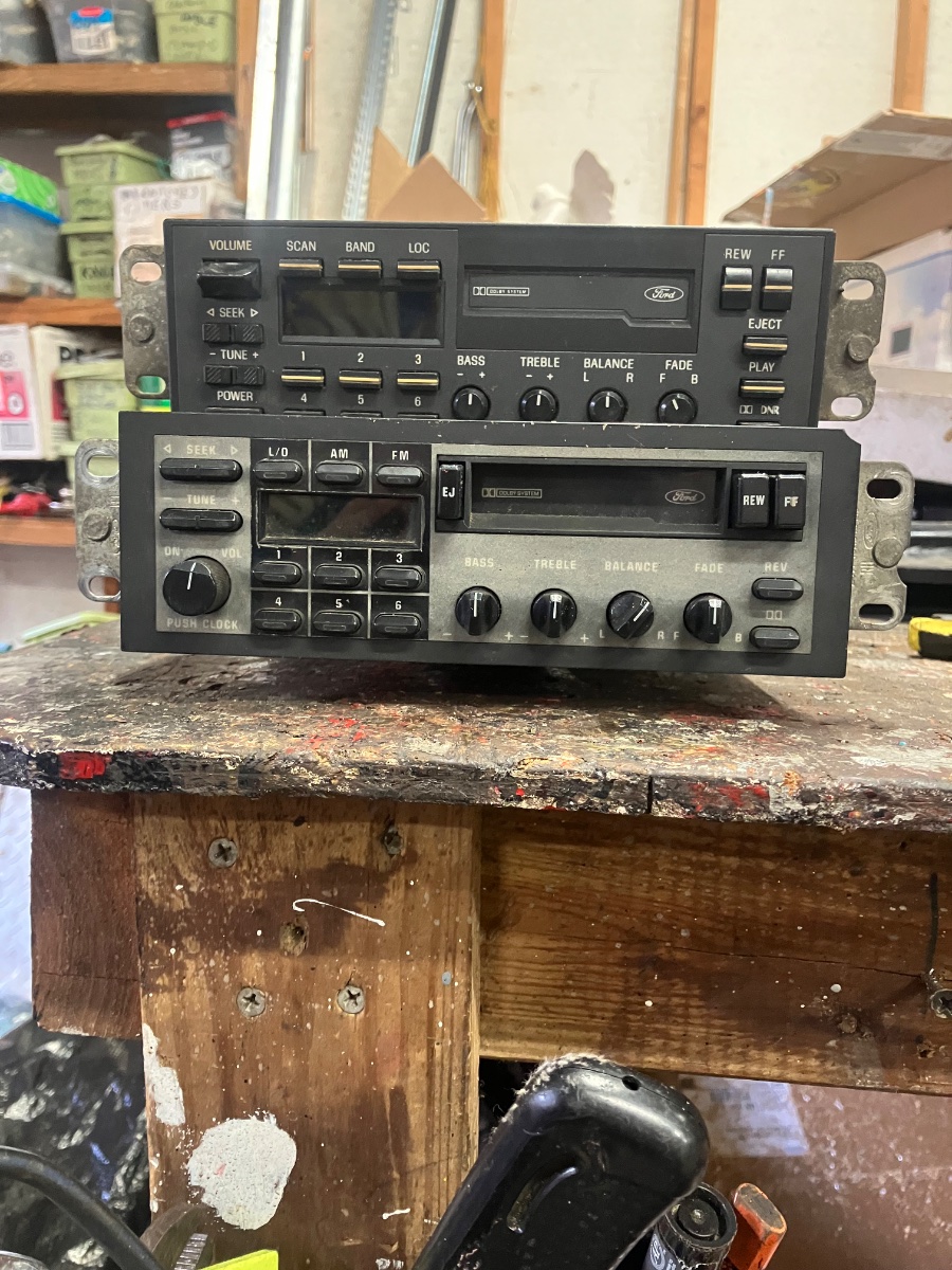

Before I quit, I dug out two spare Lincoln radio/cassettes that look almost identical. One was from an 88 town car and one was from an 89 town car (I thought). I wrote down the part numbers, and I wrote down the colors of the wires.
After I got back from the movie date, I tried to look up (1) the wiring code for the 87 Ranger, and I couldn’t find anything that seemed to match what I’ve got (all original wires in my truck). The part number on the radio was obliterated from age.
FYI, when I grab something like a radio or anything else electronic from the scrapyard, I try to cut the cables and save the cable end, so I’ve got something to splice to if I need it. I used the part numbers from the two Lincoln radios to look up their wiring diagram/color codes.
I found the (2) 88 radio, and none of the colors matched the colors that are on the actual radio I have. When I googled the (3) 89 radio, it said it was from my Mark VII, but then the description said it was from an 88 or 89 Lincoln premium sound system. Both by 88 and my 87 Lincoln TCs have the premium sound systems which also have an amplifier independent of the radio, but they’ll slide right in to where the Ranger radio sits.
Long story short, none of the wiring diagram information from any of these matches web to actual, what’s actually on the radios. I looked all over the place, including The Ranger Station, and I couldn’t find a wiring diagram (diagram or the color codes). I found later models, but not the 87.
Can somebody direct me to the 87 wiring diagram and colors? I’m not afraid of splicing the wires if I can figure out which is which on either Lincoln radio, and what the 87 Ranger radio put out.
