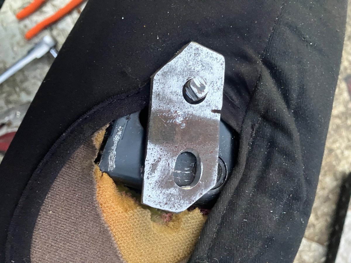

When I had the seat out and sitting on a bench, I took the armrest off. I cut open the side of my seat a little bit to look at the steel frame that receives the bolt that holds the armrest. It’s straight as an arrow, it’s built like a brick out house, so that’s not the problem. The seat has a seat cover, I took it off, so I wasn’t too worried about taking a little of the OEM seat fabric off from around where it swings.

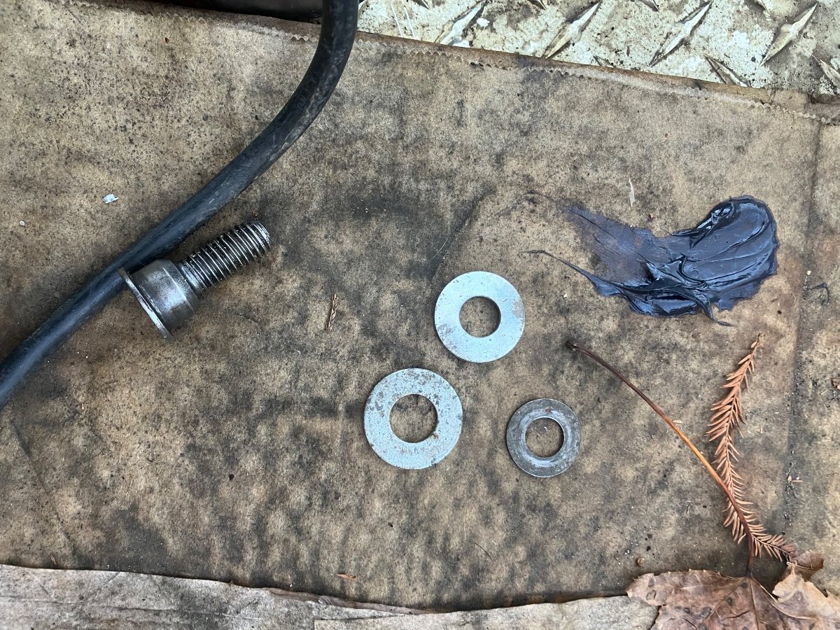

I know from messing with them before there is a big washer, a spring washer, and a couple of fine shim looking washers. Those are missing from this unit. You can torque down the screw, and the armrest is still wobbly. I took it apart. The steel bracket that is part of the arm breast is also built like a brick outhouse and is doubtfully the problem.
This bar goes between the seat frame and the armrest. The armrest rotates on the front round hole, and the left rear hole has a pin with a cotter pin through it that acts as a stop for how far the armrest can move up and down.
This shot shows the star bolt that goes from the inside of the armrest through to the side of the seat. I don’t have the thin shims, and two regular old hardware store washers were there so it wouldn’t wobble too much, but I don’t think they are OEM. I fabricated a new plate there.

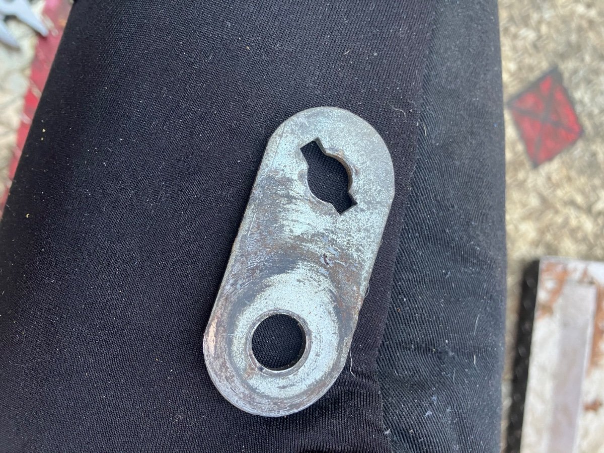

The holes on the armrest and on the chair looked fine. The holes on this plate that goes between them were egg out maybe a 16th of an inch. When you put the arm rest on it, you could wiggle it up and down like an inch or two. I think it’s supposed to be snug. I made the new plate with the holes in the exact same place, and the forward hole egged a little bit elongated. Seems to work fine.
I cut a 1/8 inch thick piece of diamond plate to make an inside spacer for the bolt that holds it together. Basically I made an aluminum washer, 1/8 inch thick. If you look at it in the picture, the flange is pretty thin, but it does fit securely into the armrest and acts as an axle for that armrest to pivot. When I cut the hole in the aluminum, I drilled a hole that was a hair too small for the fat part of that bolt to slide in. I closed the jaws on grandpa’s vice close enough so I can sit the washer there and actually tap the bolt through with a small hammer until the aluminum was up against that outside flange. Then I put the whole thing together.
The arm armrest now sits dead level and does not wobble from side to side at all. It should still pivot up and back, but the bolt is so tight that you have to pull on it really hard. I think if I can find one of the thin shims to put between the armrest and the seat, it will work perfectly functionally. No biggie for me since I never put it up. It’s Lincoln’s pedestal when we take trips together.

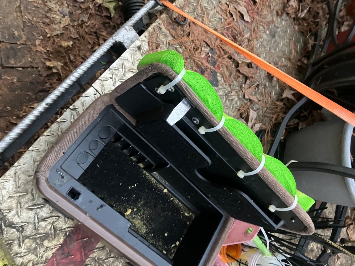

The padding on top of the arm rest was just about worn out. When it was wobbling left to right, I think my elbow would rest more on the corner edge than on the top, and I’m sure that contributed to my elbow nerve damage requiring the surgery. No fun considering it’s a stupid easy fix.
The seat cover has an independent unit that is a “bucket” that goes around the bottom of the armrest, and then a similar shallow bucket, kind of like an old ladies hat you put on with a drawstring for the top.

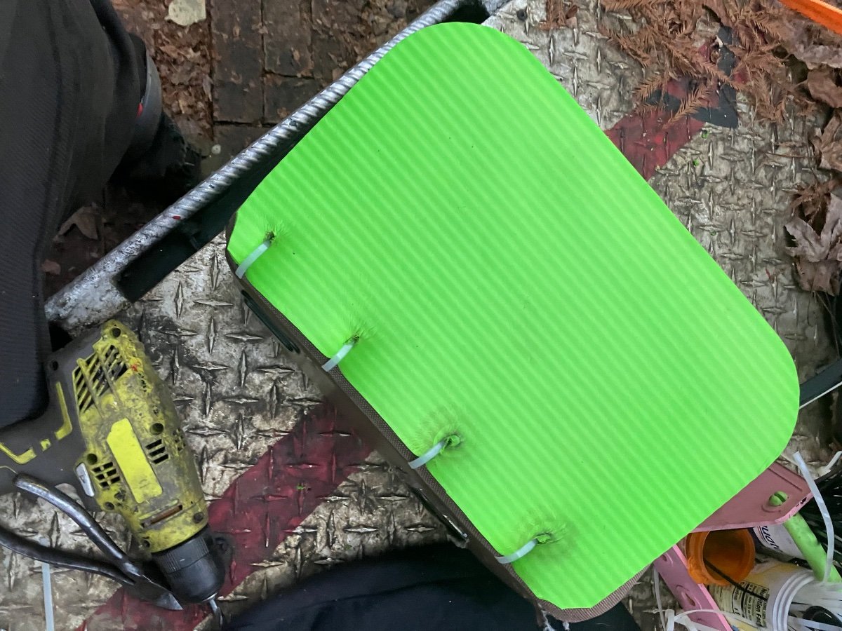

I went down to 5 Below and got one of the dense foam stadium seats. It’s the right length from front to back, and it’s easy to cut off the excess on the side. I drilled holes and used four or five zip ties to hold the pad in place under the cover. When I put the cover back on, there was just enough extra fabric that I could use three or four zip ties and pull the bottom sides around over the lip so you didn’t see the old arm rest material, and I did the same thing with the top.
It’s just the right consistency that I could put my elbow on it and not go instantly numb.
I’m going to do the same thing to the 97 when I catch my breath a little bit. It will help, but what it has now is it horrible, so I’ve got a little time.
ATTACH=full]137465[/ATTACH]
EDITED out a bunch of typos.Driving it a few times now, it seems to do the trick.

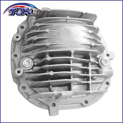

So, I have a stock 8.8” cover now. I was really trying to get my hands on something like a Solid cover or something more substantial than the stamped tin stock covers since this is supposed to be an off-road capable rig and had been putting off installing the locker as a result.
Well, winter sucks and I’m over it. I can’t afford to drop the money on a cover for at least another month if not three and by then winter will be more over than not. The one-wheel-peel isn’t cutting it. I’m intending on stuffing the passenger side axle shaft back in come next week too so I can have 4x4 again. Frickin tired of not having a decent vehicle.

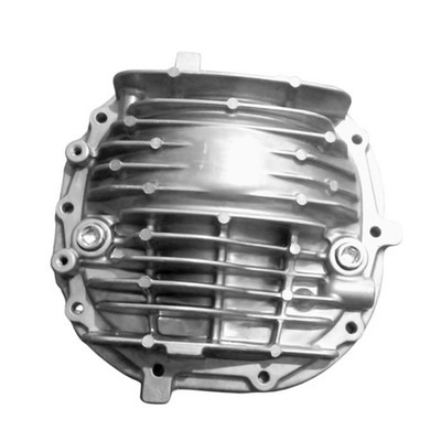

I bought onw of those cheap generic aluminum finned ford motorsport clones off ebay or amazon about two years ago and put on mine. It had some fins inside and one fin hit the gear on my 4.10 so i ground it off smooth with a 4" grinder. That cover fit and looks great and it was cheap. 50 bucks or so
Yeah, but rocks and aluminum don’t go well together, lol. I’ve thought of this and I actually was trying to get to the junkyard and grab an aluminum cover off an Explorer but I haven’t had a chance to do that and the weather has gone to crap that every day I’ve thought of trying to make a junkyard run, and nothing pressing has interfered, the weather is to crappy to venture out with a 1-wheel drive. Doesn’t matter if the weatherman says no precipitation, it will rain or snow or both. And I have to venture out tomorrow.
Doesn’t matter anyway, I’m gonna have to pop the diff cover to deal with some other things like my shims being worn and I need to replace the pinion seal so it’s just getting packaged up and sent for now. I’ll deal with it when I can get the diff cover and parts.
For what it is worth, a major driveline company did a study on finned and other differential covers in the past (Brinks I think), because of how the air flows around the differential, the fins do not add any cooling benefit. They really don't hurt anything being there but they also don't help. Their answer was to change the fin configuration and add diverter plates to get air flow over the fins. All well and good on a road vehicle, but will get busted off pretty quick in off road applications. Something the traditional finned differential covers really don't have to worry about.
EDIT: It was Banks, not Brinks

So, I’ve thought of those, the problem is that they don’t flow the gear oil correctly. You need a cover that is similar to a stock one on the inside or it doesn’t flow the oil right. Not usually the end of the world on a crawler, but a potential problem for something that sees highway speeds regularly
