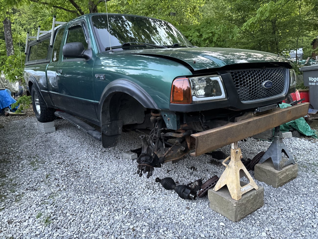

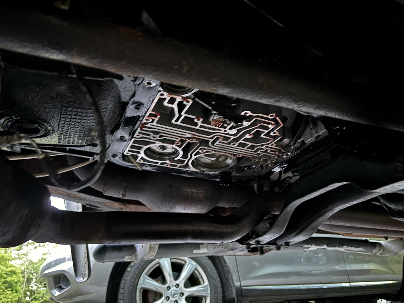

Well, I started tearing the Green Ranger apart. Trans pan is off, I did pretty good about containing the mess but I hate not having a drain plug. The new pan that’s going on has a drain plug. So it’s currently dripping. Tomorrow the front axle comes out and I’ll get the valve body down.

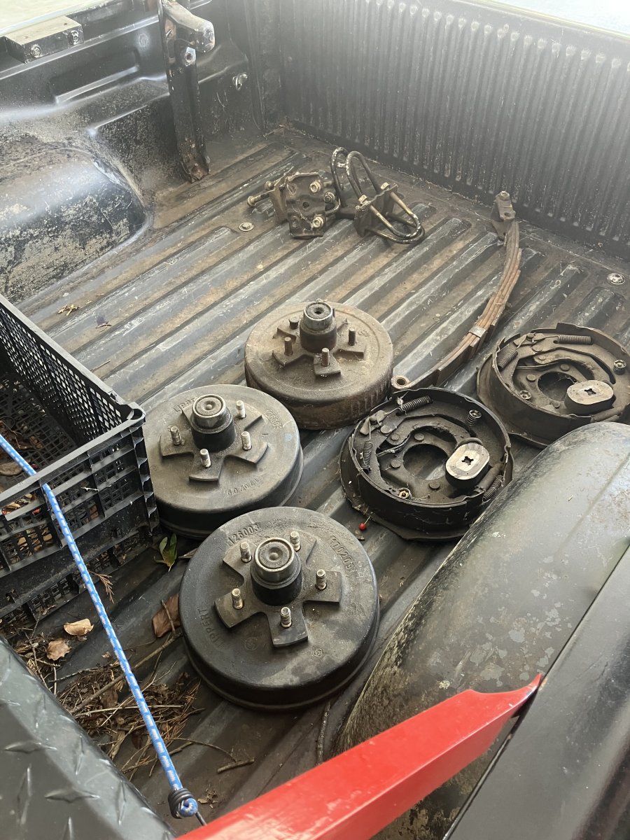

I love Craigslist/marketplace….

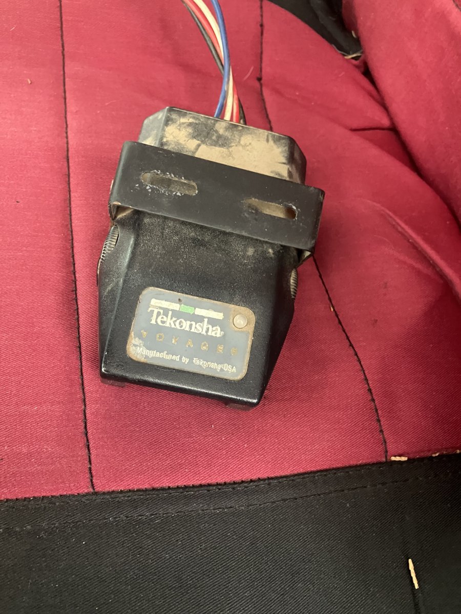

I picked up two dusty, but like new, 10 inch 3,500# trailer brake assemblies, two dusty, but like new, brake drums, and one used drum in great shape for the third axle on the Road Ranger. A two drum set for one axle retails for $175 to $200 With these, I have everything I need to put the electric brakes on the truck and the two trailer axles with the exception of one magnet arm for a 7 inch drum for the trailer.
The deal included 1 random leaf spring, 8 or 9 three inch axle U bolts, and a Tekonsha Voyager brake controller with the Ford plug (retail around $100-120). I already have a brake controller mounted on a bracket right below the shift knob in the Road Ranger, so I’ll probably use this one for the F250.
All for $100 & $5 gas.
I’ve realized with the swing arm third axle on the truck, which does not carry any road weight from the truck - only the trailer, if the trailer is loaded at all and I hit a curve, the whole thing is ripe for a jackknife. When I removed the weight of the bed and the rear bumper, spare tire, etc., the drive axle also has less weight on the road. I won’t have time to do it before the Ford nationals (but I kind of think of brakes as a crutch anyway), but it will be nice to get it all done when I get back.

For those not aware of how things have progressed with the green Ranger… frame is broken in the front. On the inside. Above the front axle. So axle is coming out to get to the damaged area.
Valve body is out for a combination Jmod and TransGo Stage 2 shift kit.
I’m also going to try doing something about getting the front end lowered the rest of the way and squash some more bugs that have poked up since the build. Need to build a new front bumper yet and get the rear bumper painted. Probably new shocks all around.

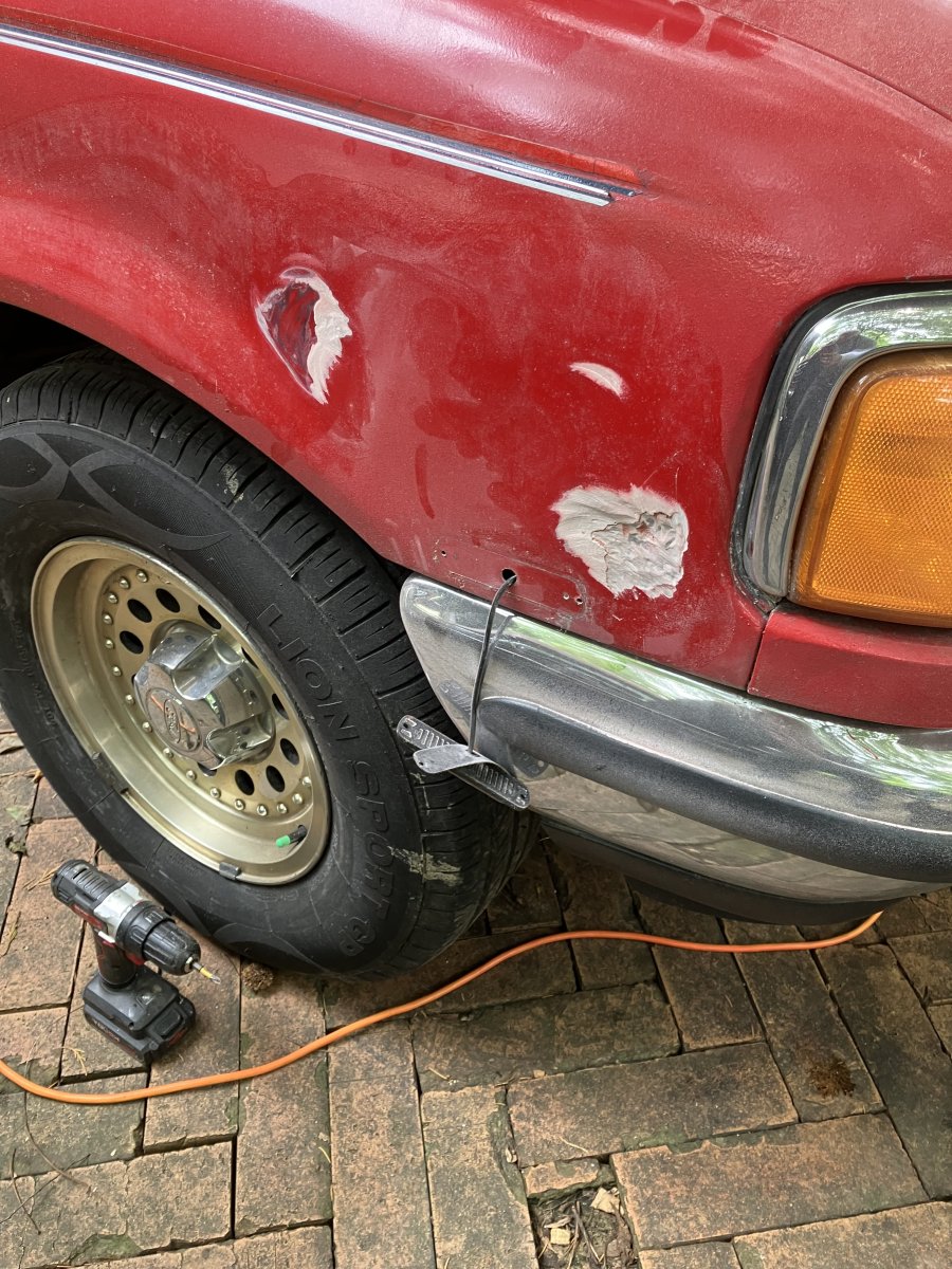

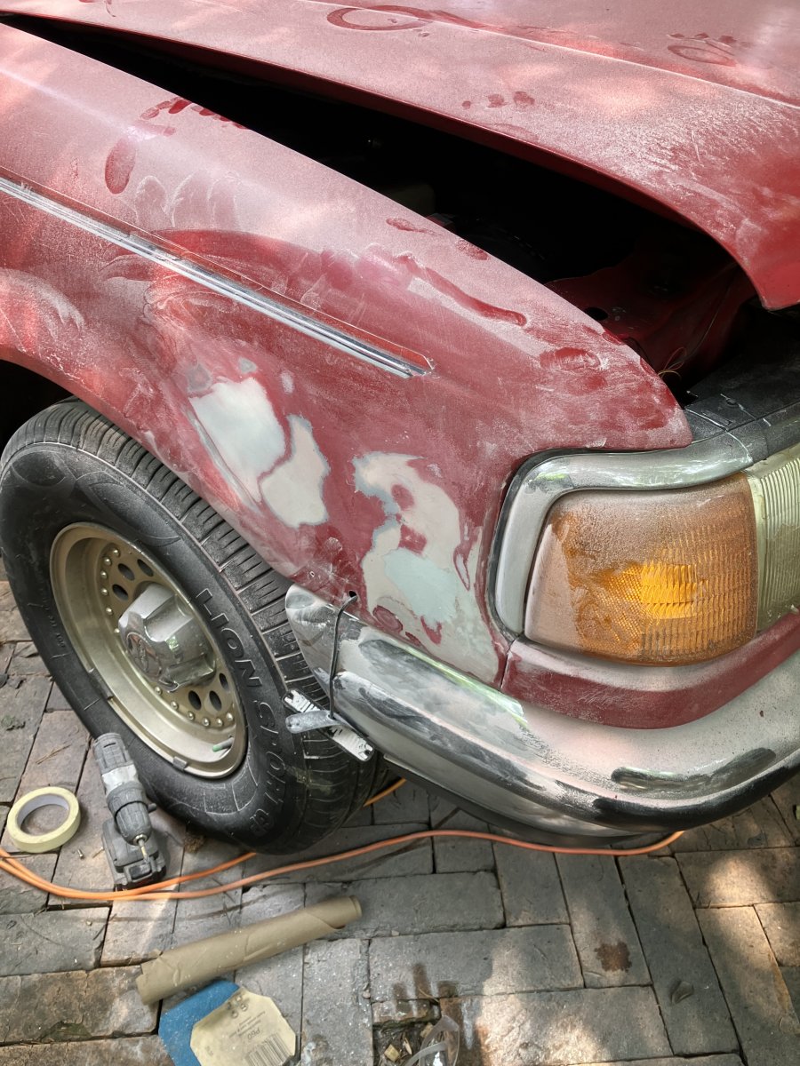

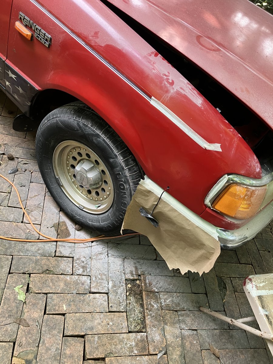

Time is closing in for Ford Nationals (gosh, I feel like I was just there last week), so I went around the truck to fix the dings and touchup the paint.
Right front fender was bent when I bought the truck, and in hindsight, I should’ve bought a clean one out of the scrapyard and replaced it, but each time I fix it a little bit better. I was surprised when I found out I could get a clean one for like $35. I think keeping the original fender, keeping the truck as original as possible, it’s always important. Plus, my fender has to be worth a whole lot more, I mean it has at least $150 of Bondo in it!
View attachment 128989View attachment 128990View attachment 128991
I dug out some of the old Bondo, some of it is pre-Rick Bondo, then loaded it up pretty good and shaped it with a 60 grit paper on my palm sander. Then I went down to 80, and then finally fine finished with 100 grit. The 100 grit was also a wet sand - I did it the exact same way, but I had a beer in my other hand.

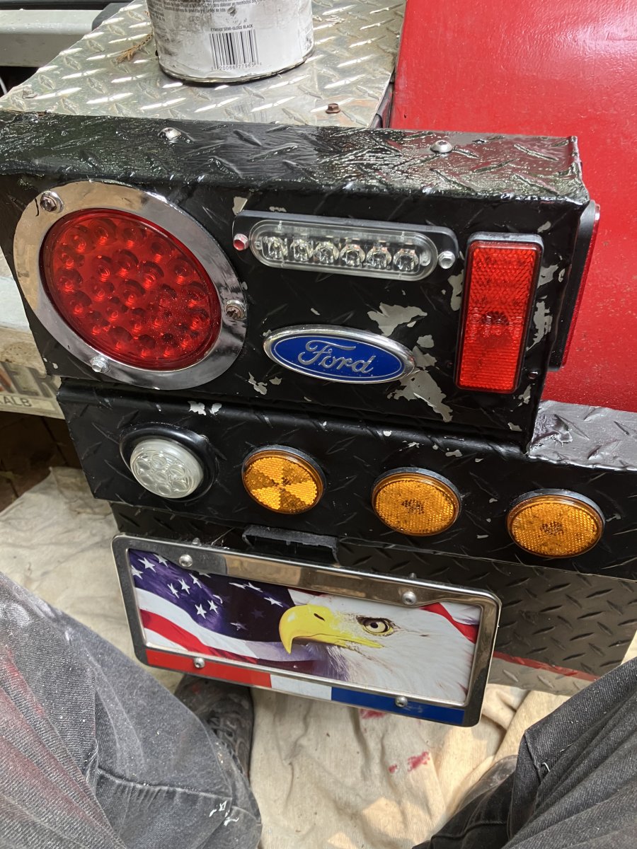

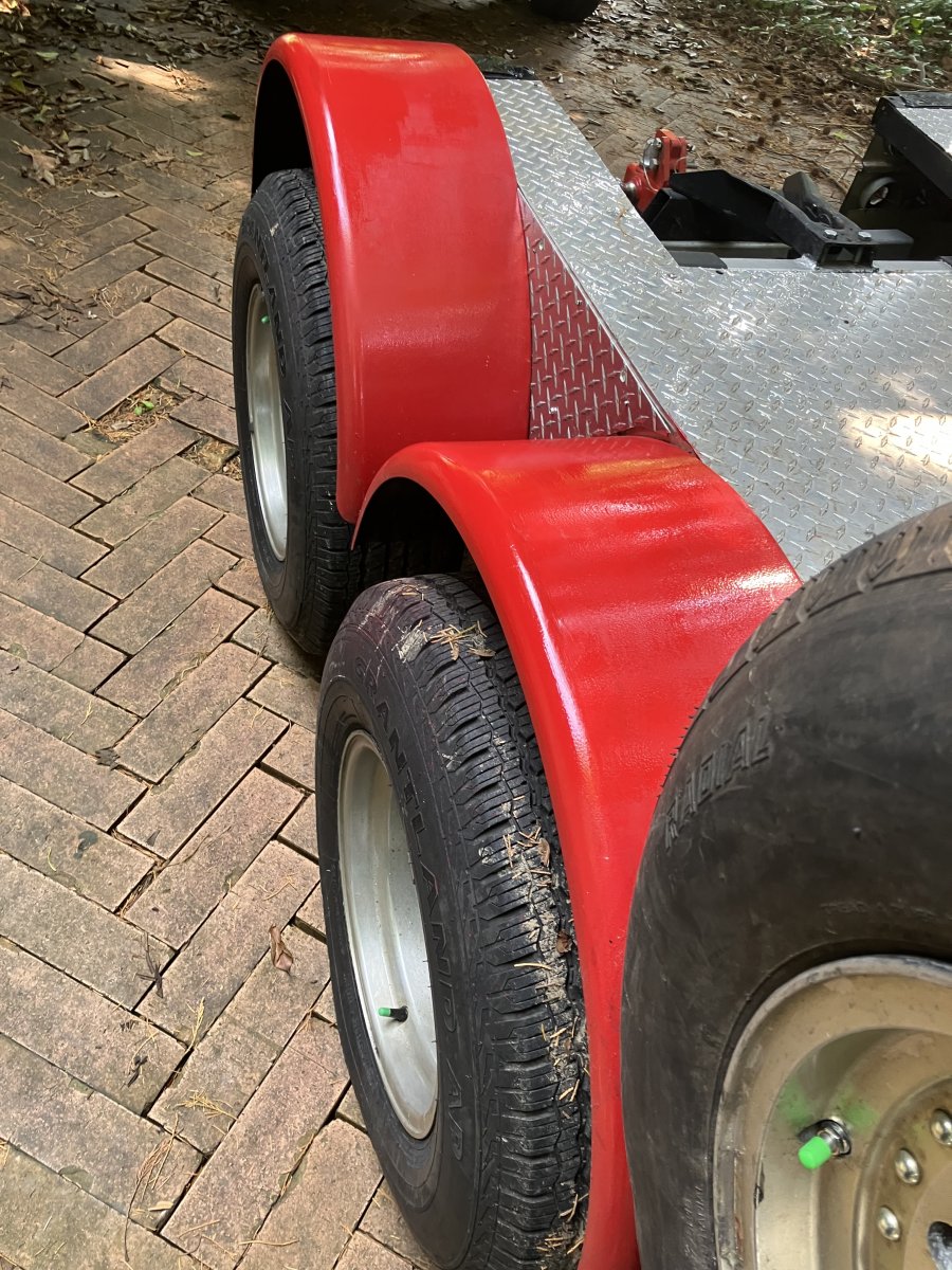

I always chip up the very outside edge of the four rear fenders, when I’m leaning over to take stuff in and out, bumping the edge or just scraping it with my belt buckle. But that was a quick sand and touchup.

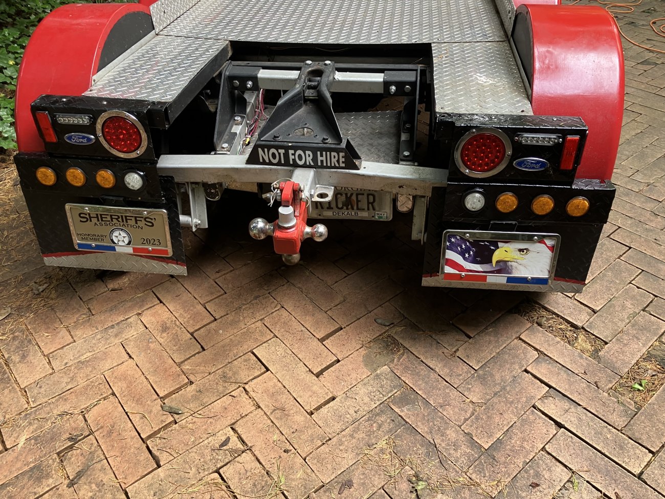

Every year one of the sequencing Amber turn signals act up, so I fixed that, and I finished up straightening the corners of the aluminum on the inside at the top where it’s been scuffing the pin assembly as I turn. Then I touched up the black. I cleaned the light assembly really well, for some reason that first coat of semi gloss black flaked off a little bit. I tried to scuff it up a little bit with a little wire brush before the latest coating.

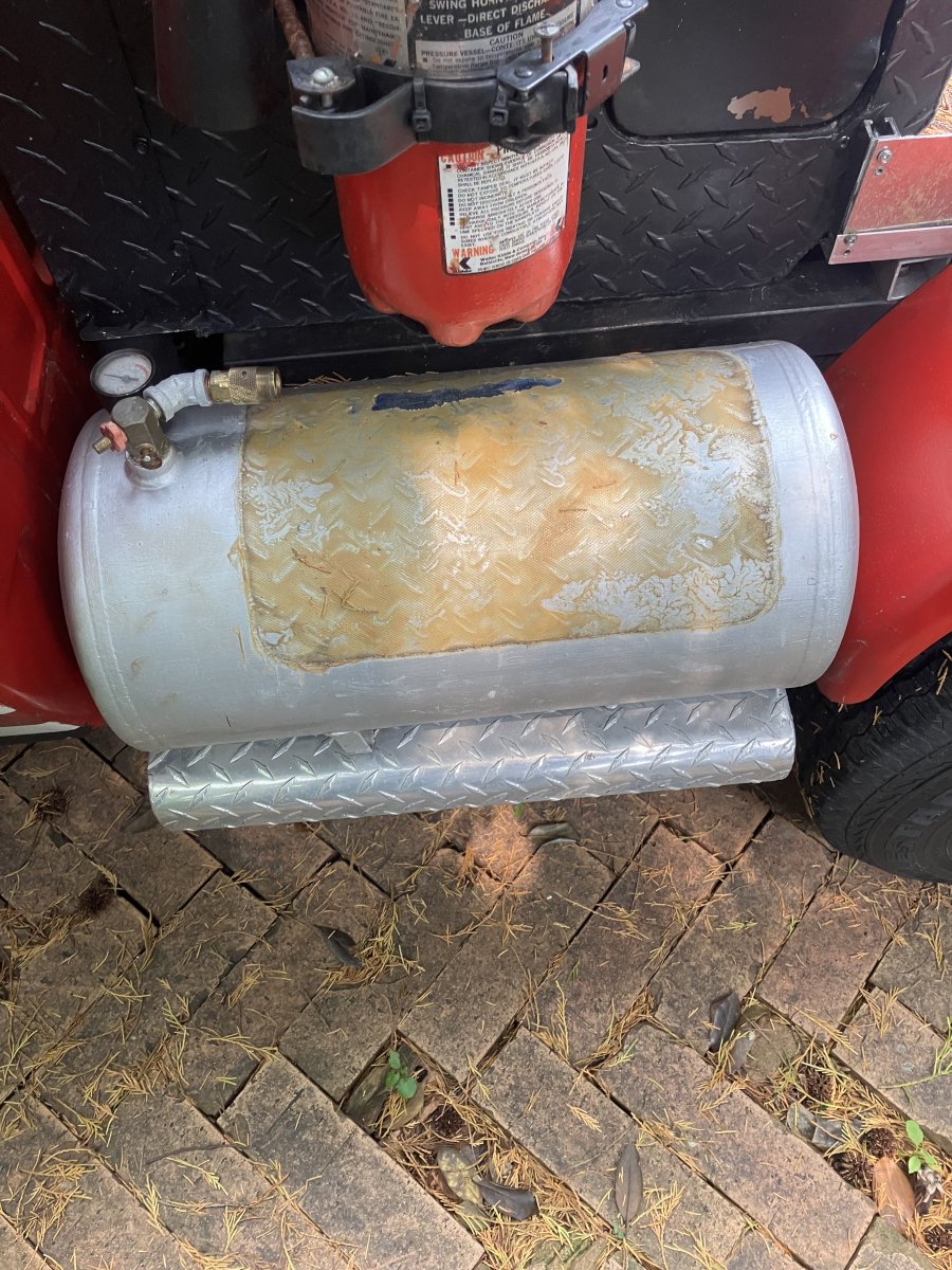

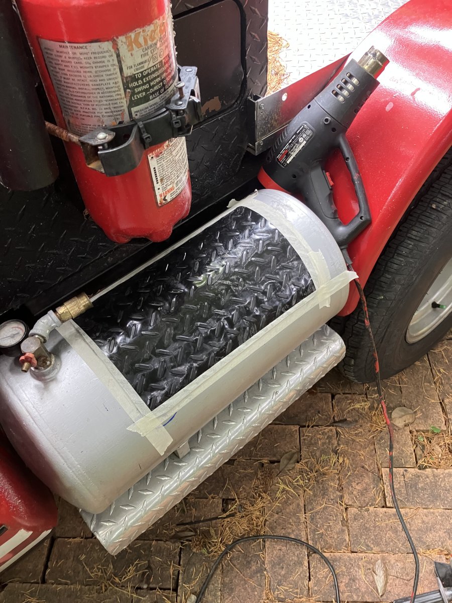

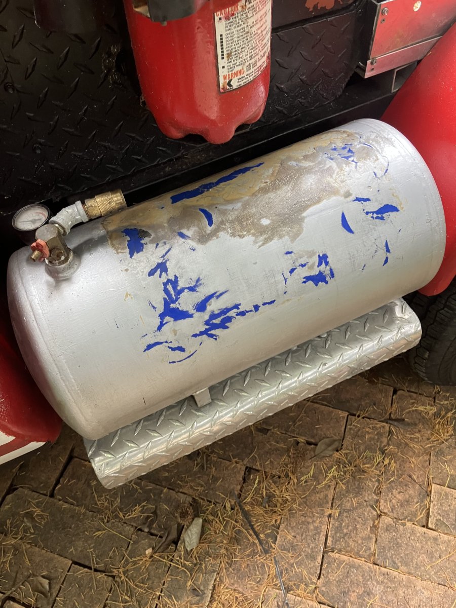

and finally, the vinyl tread step I put on top of my air tank blew off at Highway speeds.
I had used the vinyl glue like when you glue down the vinyl floor tiles. The wind caught the edge. So I cleaned it all off and sanded it down, and I stuck down a new piece with E 6000. I still have to touch up the Silver, but that’s always the last thing I do all the way around the truck
somewhere I have one of those 6 foot or 8 foot long hose clamp ribbons. I may put a couple straps around the whole tank to hold it down, but I think it would also look cool. Project for another day.
I've found that the only way to get paint to stick well on aluminum and galvanized steel is to use self etching primer. Some say you should spray regular primer over the self etching primer before painting. That has not been my experience, but the paint has stuck well and never flaked.
Good advice.
If you remember, those light assemblies were cut out of a Crossbody toolbox that would drop in a pick up truck bed. That was work I did when I was still pretty sick and pretty feeble on my legs. I know I would have washed them before I painted them, but I doubt I did any kind of preparation. The Aluminum was probably clear coated as well, I don’t know how that would affect it.
Rust oleum cures with a pretty thick hard coat. That’s why I felt a little wire, brushing, to create some micro grooves, might solve the problem. For now, I’m still happy grabbing one of my dollar store brushes and by 20 year old can of black rustoleum and touching it up…

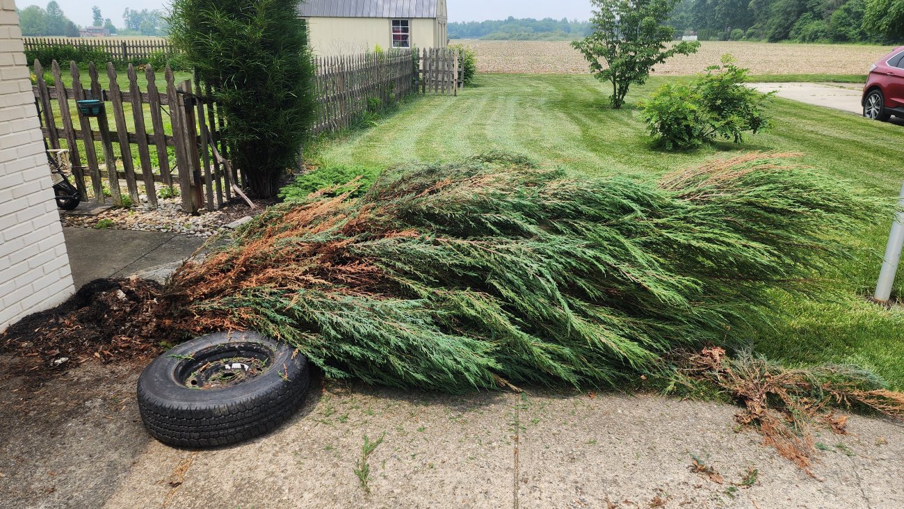

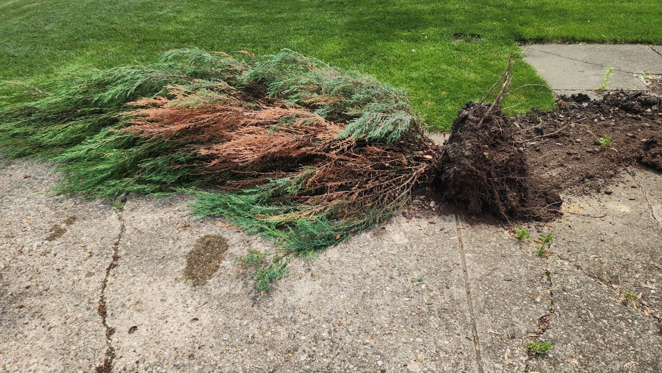

I used it to uproot two ornamental trees on either side of the garage. One was leaning 60 degrees from a storm last year, the other one was overcrowding the house. Logging chain, spare tire to make the chain pull upwards on the tree to uproot it.
Had David make sure the tire stayed upright and the chain stayed on top of the tire until I took the slack out of the chain, then he got out the way of any any possible flying chain or tree parts when I pulled the tree out. Worked well.

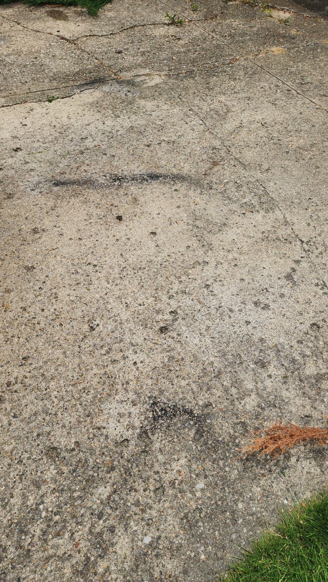

Another note.. 202k miles and the limited slip still spins both rear tires.
