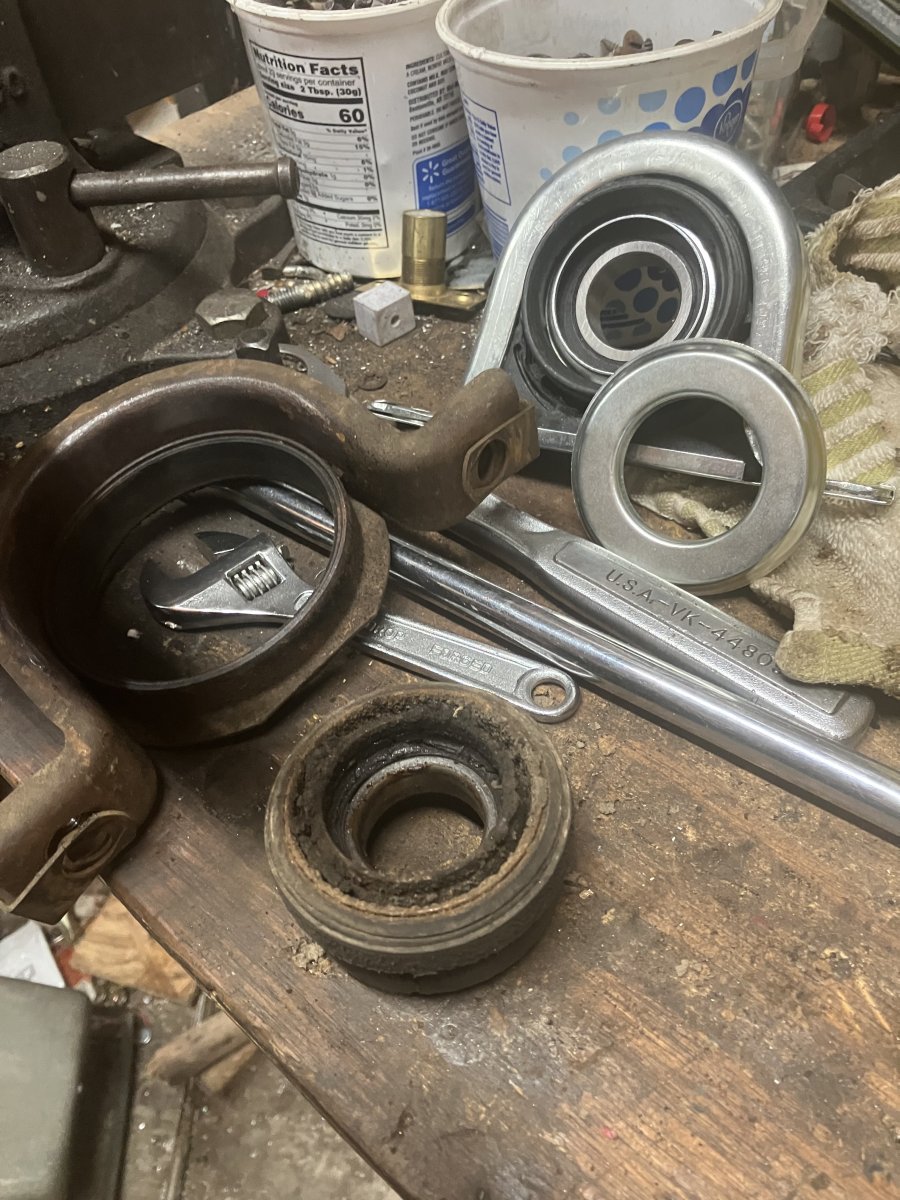

Help question number two: midshaft bearing on a two piece driveshaft.
1997 4.0, five speed, 2wd, long cab, short bed

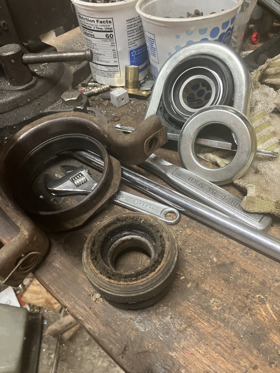

I just received the correct midshaft bearing. The old one had completely disintegrated where pretty much all that was left was the horseshoe outer housing, and a little bit of rubber around the bearing itself. It wobbled and rattled itself to death.
The new bearing has a large loose washer/disk on one side. The old one did not have any disc, or it was mangled and thrown off.
When I install the new bearing, does the disc go on the front side or on the rear side?

But I reached out to the guy who sold me the part, and he said that stamped metal piece is a dust shield, and it is supposed to be facing towards the back of the truck.
Maybe you gurus should write that down somewhere.

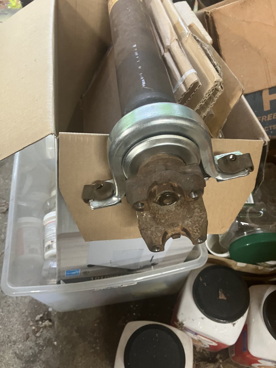

Monsoon season in Atlanta today, so I was doing projects in the house and in the shop. A priority is getting that front driveshaft back into my 97 Road Ranger.
Guess which is the new one?

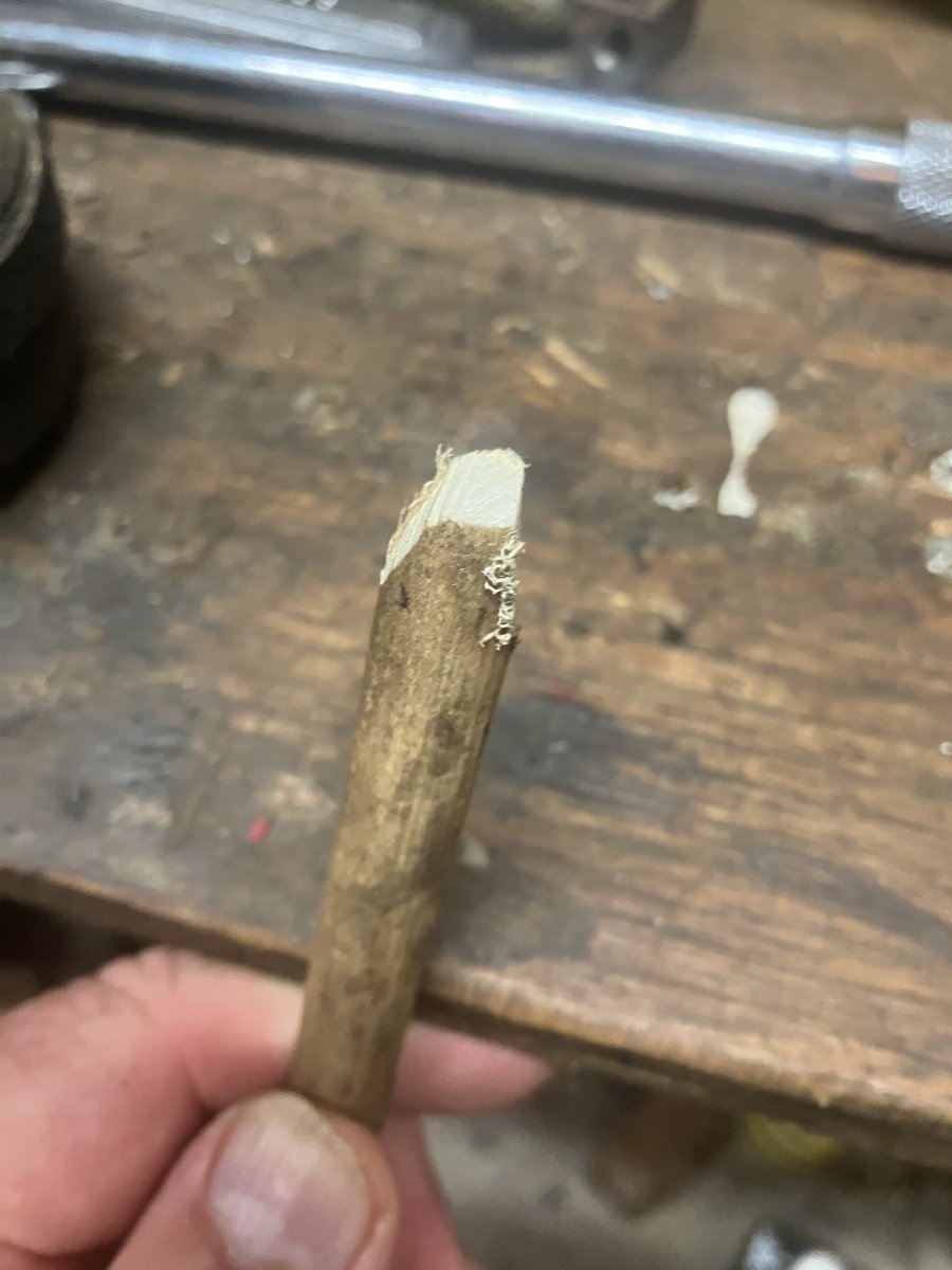

I didn’t have a deep enough socket or the right diameter pipe to seat the bearing, so I made a custom bearing seating tool woody thingum.
No, I didn’t get wild and crazy with the money. This is a piece of an American flag 🇺🇸 I got from the dollar store years ago. It was in the “short dowels” section in the shed of miracles.

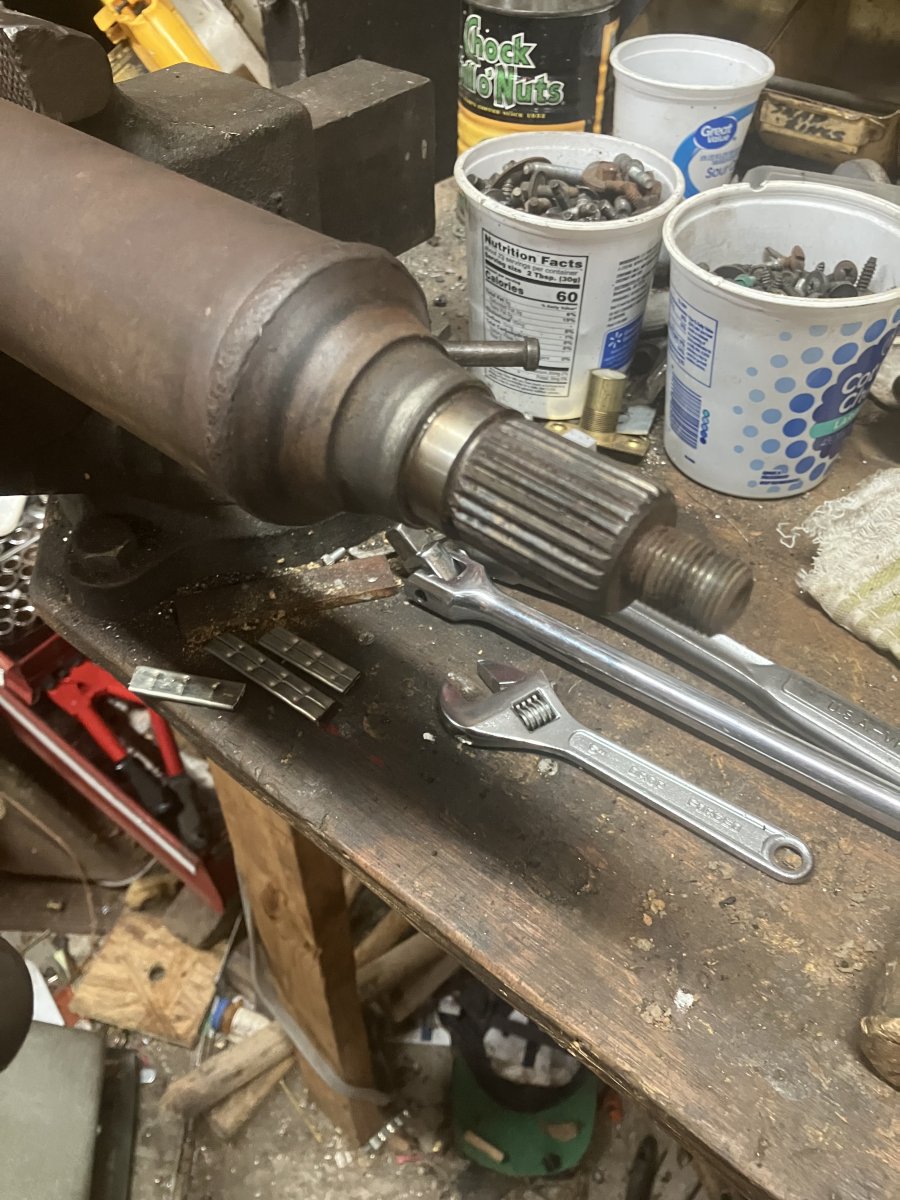

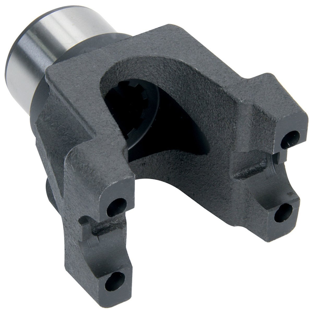

I think the whole thing would’ve taken me about 15 minutes, but I goofed when I put the nut on to hold the yoke on the driveshaft. I forgot to put the washer in, and then I bottomed out the nut so I couldn’t grab it back with the socket. My butthole got tight for a minute, but then I realized I could pull the yoke off with the harmonic balancer puller and it would slide right over the nut. Disaster averted.
Ready to go, but it’s raining like crazy, and I don’t want to be wet and upside down with my bad arm, beating my head on the bottom side of that thing. Rain is supposed to stop early in the morning, so I’ll throw a blanket under there and hopefully do it before it starts raining around noon again tomorrow.
I think the whole thing would’ve taken me about 15 minutes, but I goofed when I put the nut on to hold the yolk on the driveshaft. I forgot to put the washer in, and then I bottomed out the nut so I couldn’t grab it back with the socket. My butthole got tight for a minute, but then I realized I could pull the yolk off with the harmonic balancer puller and it would slide right over the nut. Disaster averted.
