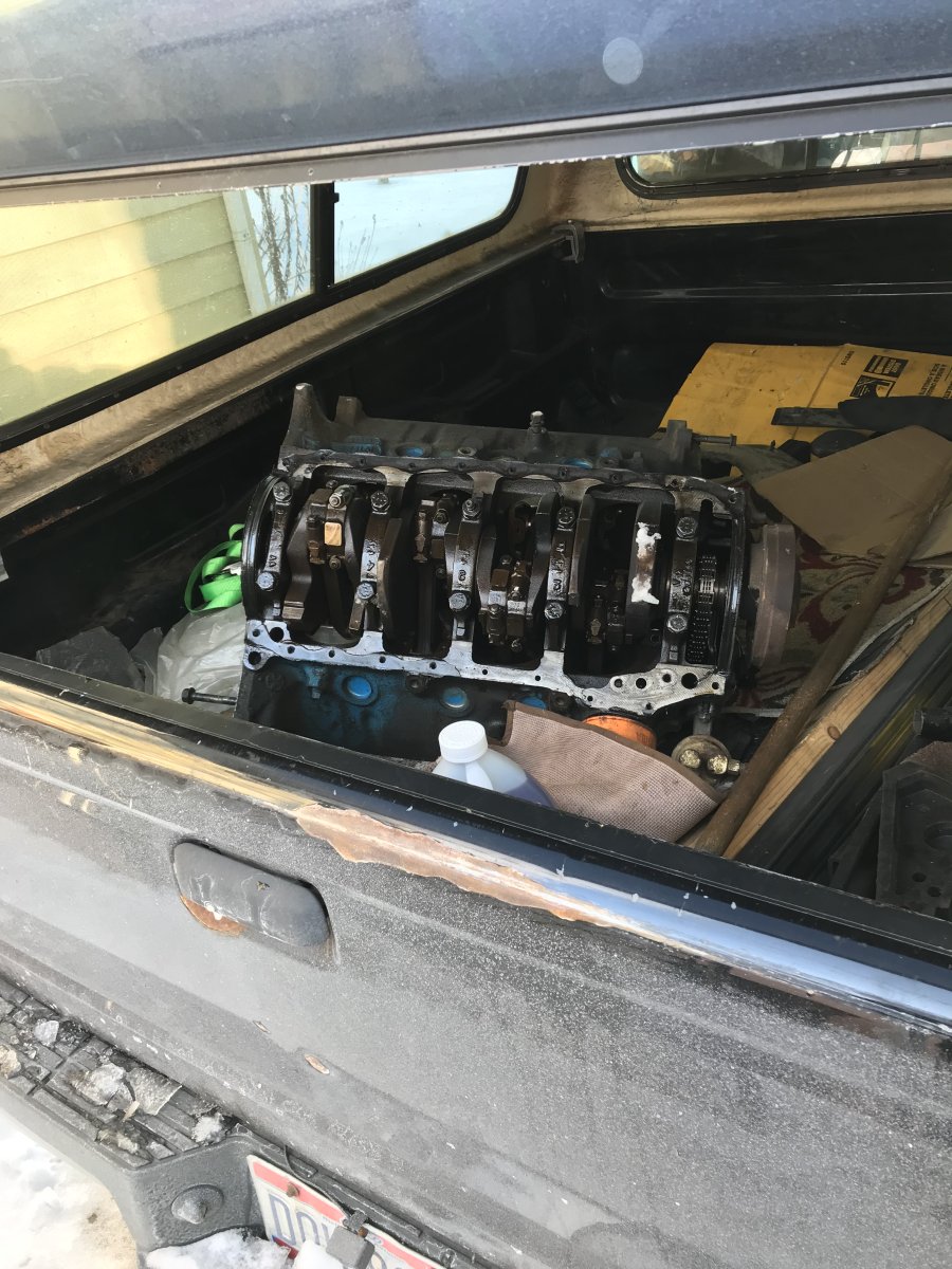

added 400 cubic inches of traction.
short block only, for now.
since I already have a complete 351M all I wanted was a crankshaft but had to settle for a package deal.

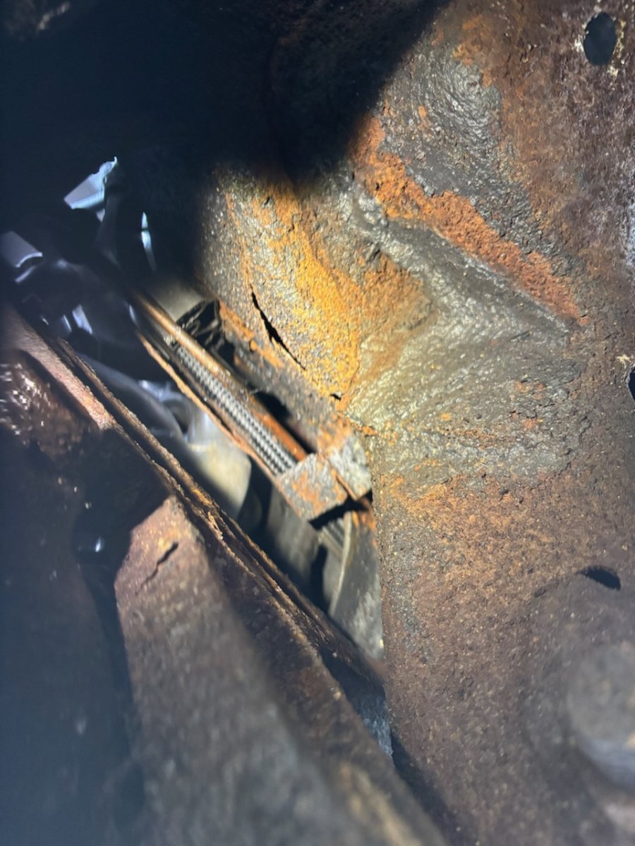

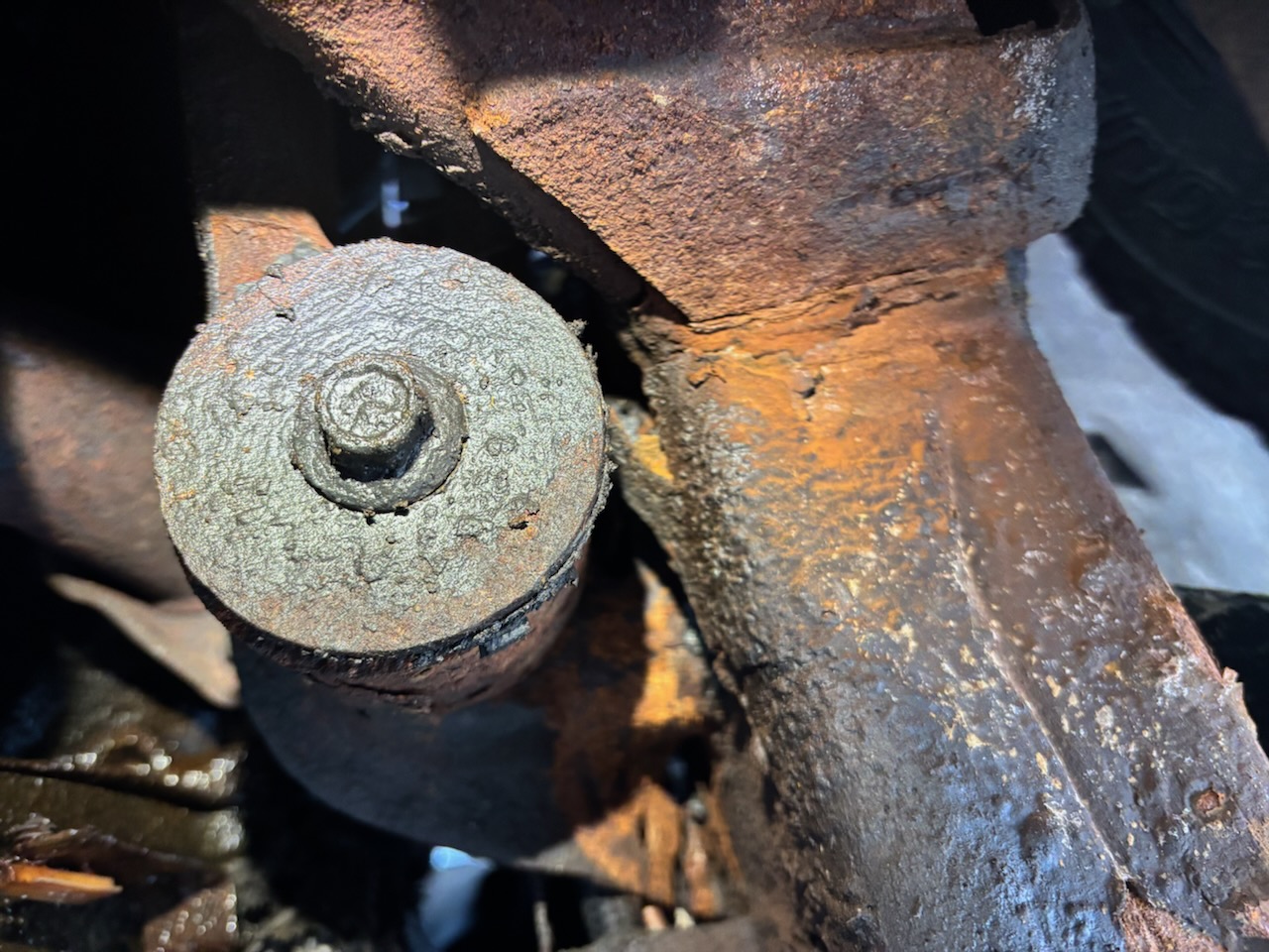

So, today since it was kind of nice out, I thought that I would see about the exhaust leak on the green Ranger and maybe try resolving a couple other things and get the crossmember in dad’s truck…
Seemed like I had some loose bolts holding the downpipe to the header on the passenger side, so I put it up on ramps and snugged those up. Started it up to hear a smaller leak on the drivers side. Went over there and the bolts were tight but there are a couple pinholes over there. Ok, I’m not dragging the welder out today, but that is easy enough to fix…
And then I notice something… and then I moved to the front for another look…
Ahh fudge… I was sure that I had checked the frame good when I had things apart and this would have been accessible, but apparently I didn’t check well enough. This is probably the vibration I’ve been chasing too…
Whole front axle has to come out and I have to get it high enough to work on. Argh. So could use a lift right now. What a kick in the nads. I’m gonna fix it, but I’m not happy about it right now. Might just gather some stuff and try to deal with a bunch of things at once like my upper control arms and shift kit…

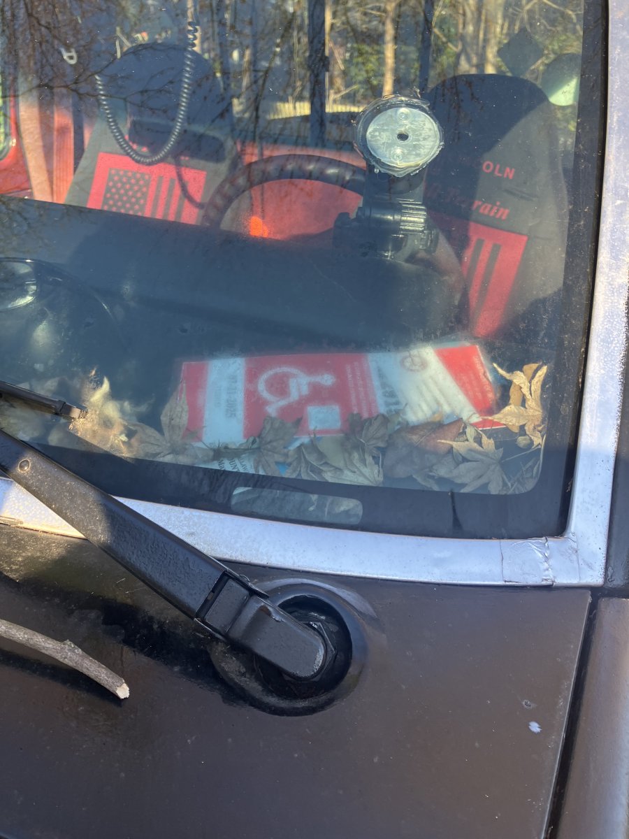

When I drove the Missing Linc yesterday, I realized my fall autumn leaves arrangements around my handicap pass, and my light permit were a little faded and tired.
Lincoln likes it when the back window was open so he can put his paws up on the toolbox and bark at whatever. I always forget after the winter to blow the leaves out of the box and I get showered once I hit about 30 mph.
But now I’m thinking about the spring flower arrangement if you guys have any suggestions.
