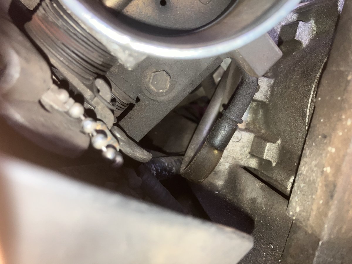

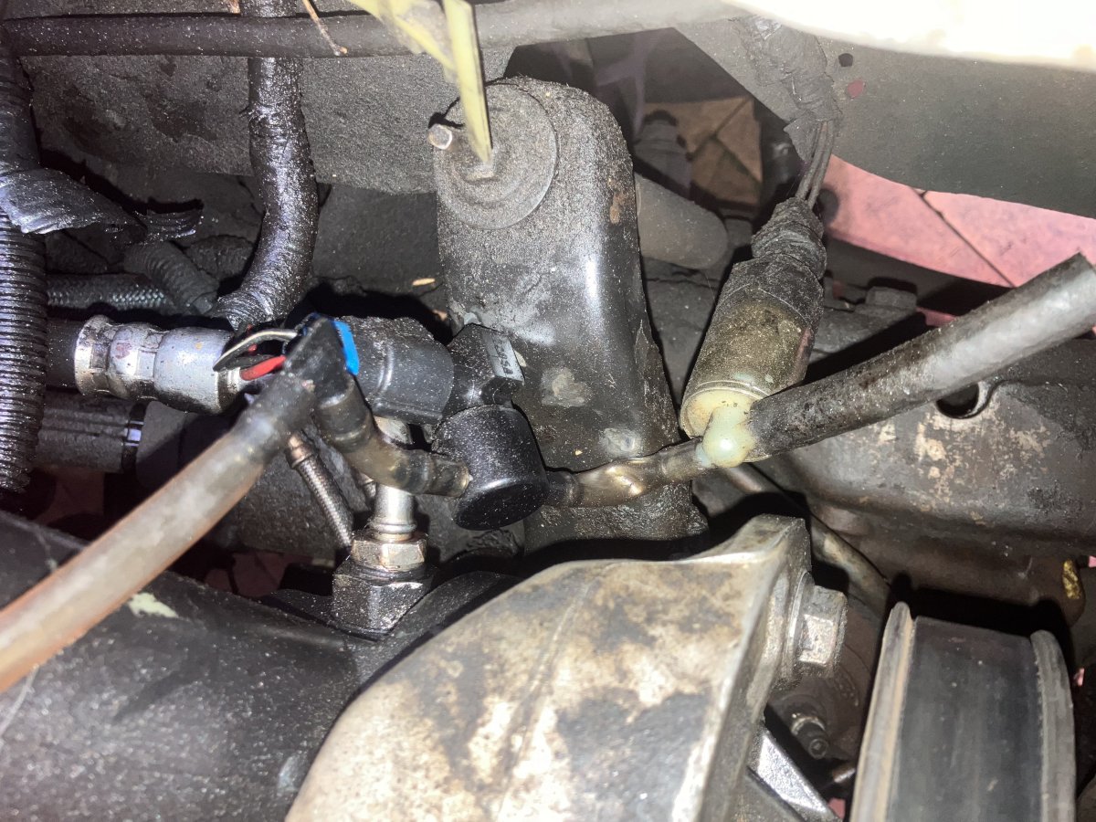

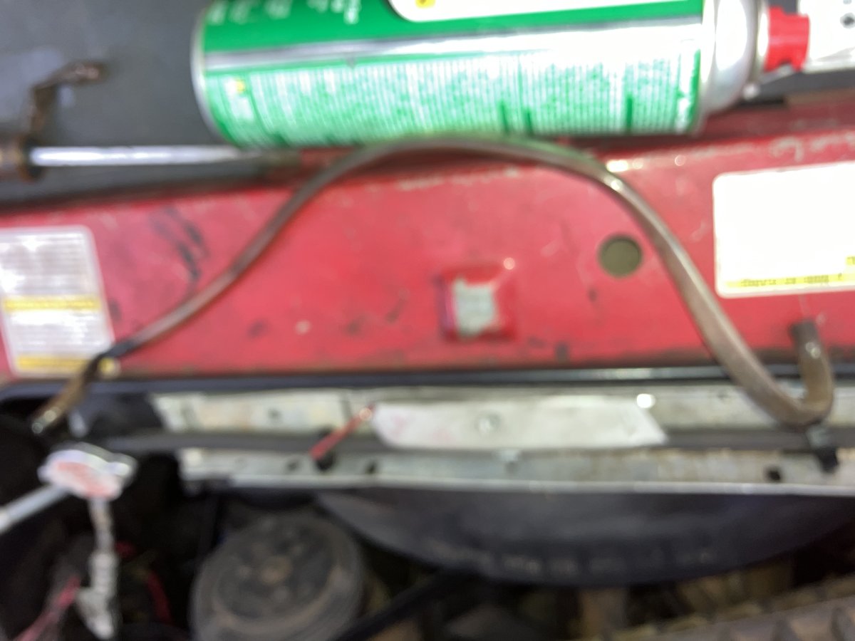

I pulled the vinyl tubing out from the charcoal canister, and I replaced it with real vacuum tubing, and I reset the trouble light, but I didn’t drive it anywhere. We’ll see how it does later.
The vinyl tubing was almost flat over half its length, and it was kinked in three places.
View attachment 118533View attachment 118534View attachment 118535
When I replaced this tubing, I reset the trouble light by disconnecting the negative battery cable. When I got in yesterday to go to caffeine and octane, the light was still on, not a total tragedy, but made me mumble a little bit.
Halfway out there, I remembered some yokel added a second battery to that truck and if you don’t disconnect that battery, it doesn’t reset. I did that quick, and no more trouble since.

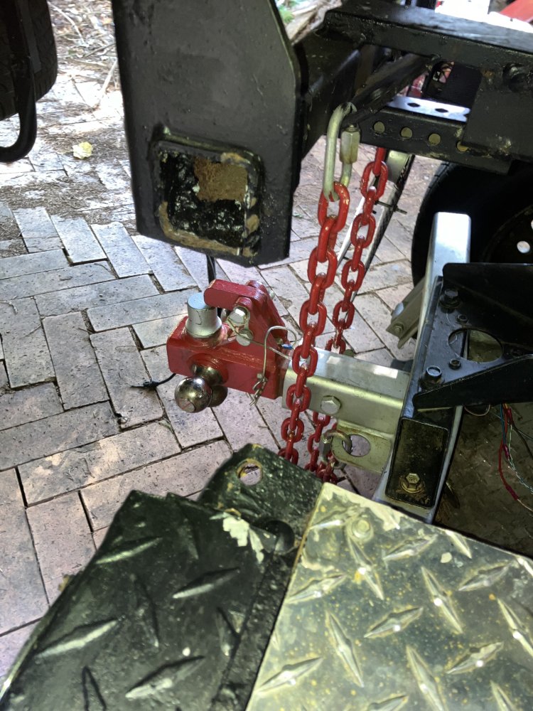

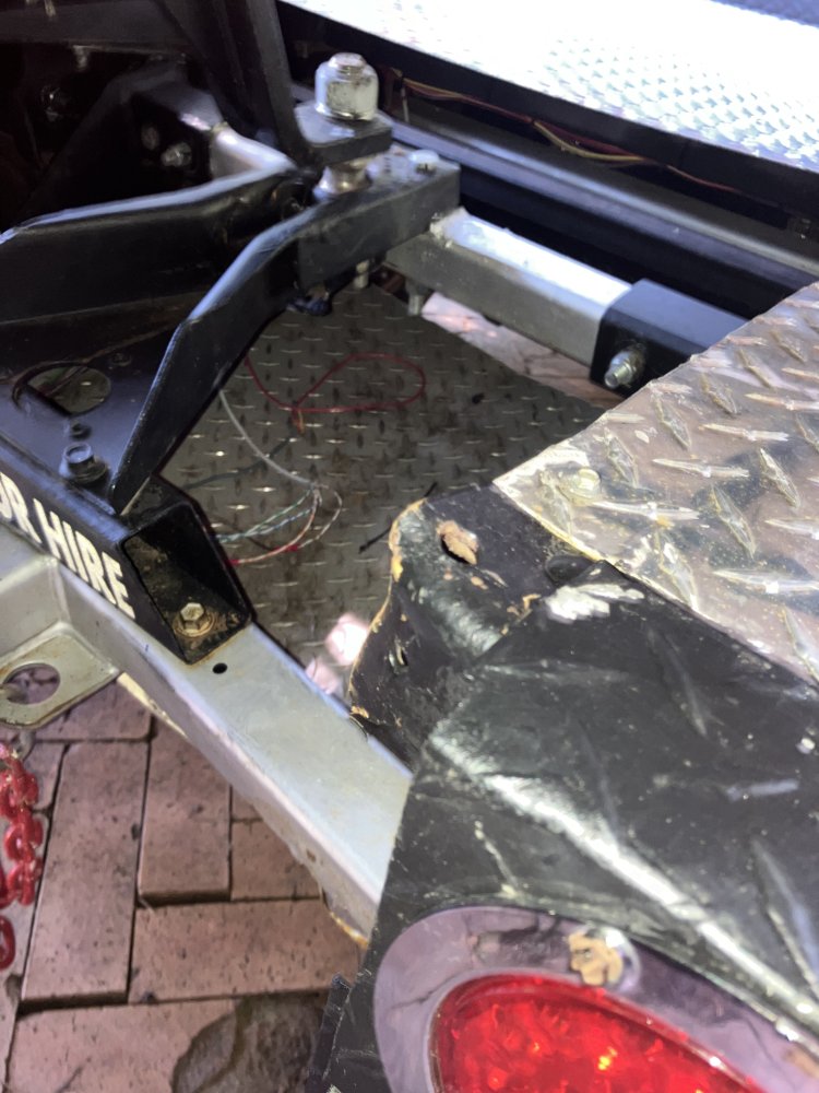

On the downside, I realized I still have a clearance issue between the neck and pin mechanism of the step trailer to my fifth wheel on the Road Ranger. The wider part of the trailer mechanism is hitting the inside corners of the diamond plate deck above the tail lights. When it is parked on flat ground, there’s about an inch and a half clearance. It wasn’t until I got home that I realized what was happening.
When the city widened the road and put in sidewalks, they made my driveway twice as steep, and the sidewalk is actually a crown, and then there’s a little decline back to the pavement. When the truck is over that crown, at the same time I’m turning left or right, it brings down that mechanism just enough that it clips the corners.

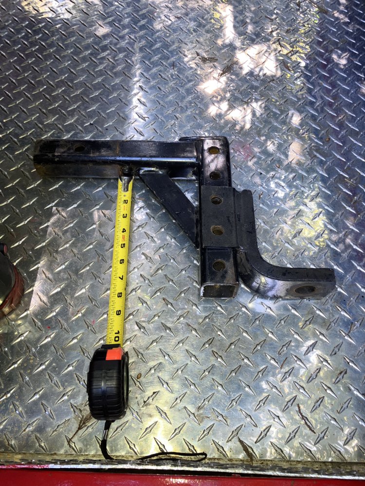

I’m going to start by trimming those two corners off and trimming off about a quarter inch of the bracket that hangs down. If that doesn’t work, I have this in the shed of miracles., but I went to a lot of trouble to level out the trailer compared to the truck, so the last thing I wanna do is raise it back up a couple inches. But, function over form.

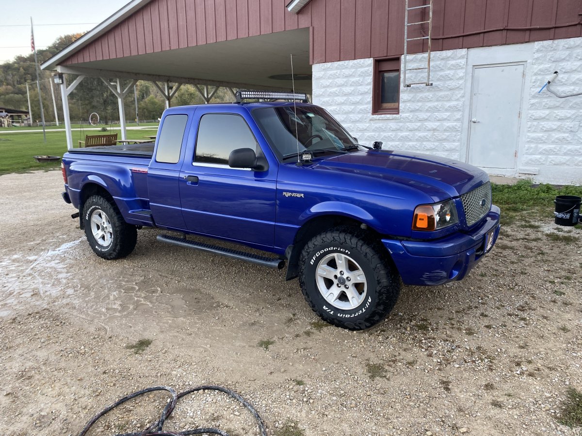

Washed the truck today, knowing full well it will be covered in gravel dust after about 2 seconds on the road- sure @85_Ranger4x4 can relate.
So when last I posted I'd just removed the EGR valve to see if it fixed any of my running issues. Driving it yesterday and today it acted about as well as can be expected for a vehicle that needs to be tuned. That is to say that all of my idle and stalling issues were gone. So placed an order for anew EGR valve and solenoid through Rock Auto this afternoon.

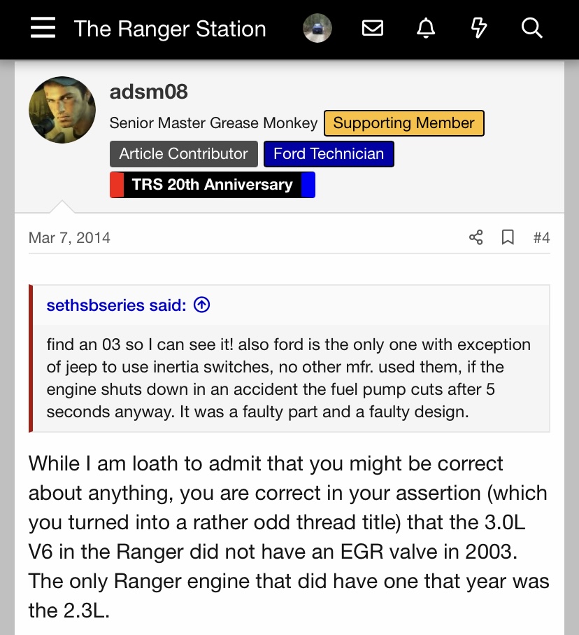

Unelss someone has chopped up the harness and removed every aspect of the system, I don’t think so. From my research, the 2003 3.0 and 4.0 don’t have EGR, ford managed to meet emissions that year with valve timing. It holds open the exhaust valve longer to suck a bit of exhaust back in.

And you could still be right about the EGR, I just googled it when I first discovered it missing and it lead me to “it doesn’t have it this one year”. It means one less headache because it can’t break, but I might have worse fuel economy, at least on paper.
