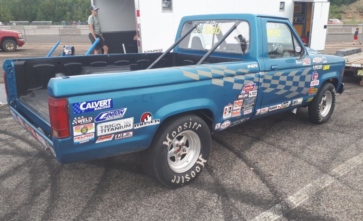

One last testing session coming up this weekend and hopefully that will get all the bugs sorted out for next year. Just need to do a rear shock adjustment and change one header gasket before Friday.
